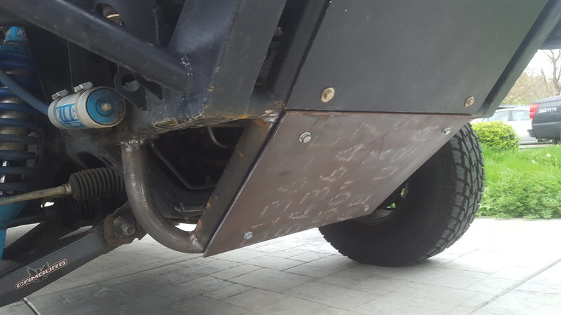

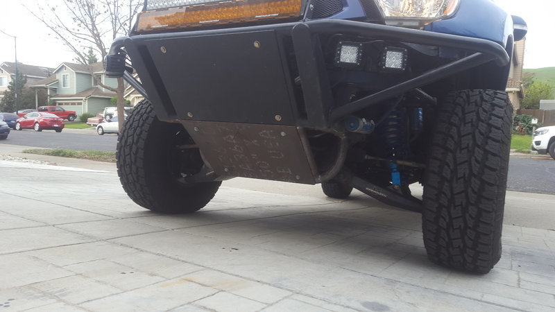

    Couple updates-
    Gears are in, did a 600 mile break in, boosted home after the oil change. Now I have a a whirring sound from the rear diff on decelleration. Shop that did the work says my Nitro gears I provided weren't very high quality and he couldnt get them set up perfectly. I have his assurances the diff wont grenade anytime soon, but Ill be bringing my stock diff along to Pismo juuuust in case. And when I get back he said he will install his Sierra brand of gears that I have to buy from him, for free. So free labor basically. I'll probably end up doing that just so I can get a full warranty for it all through him and then send out the "defect" Nitro geared diff to ECGS and have them set it all up so I get a warranty through them.
    Other than that, I fuckin love the extra power. I'm already looking in to 35s since right now I'm at about 3k rpms at 75mph and I usually cruise around 75-80 on the way to work, so thats no bueno.
    Got my skid built up finally, need to toss some paint on it when I'm off work. Added a new crossmember basically, tied it in to the lower bumper piece, so my clearance isnt exactly what it was, buts its still better than stock. 1/4" plate up front with the DOM framing, and then another piece of 1/4" plate underneath. This is just the first model of it, I think the bottom piece will get redesigned with gusseting and added fitment for more skids going back, there was also talks of countersinking the bolts down the road, so Ill have to start looking in to how I want it done.
    Also, couldn't find a bolt that would screw in to the rear holes, I suspect the stock mount nuts are rusted out, gonna tap them out next week if I can find the oem bolt specs. Otherwise Ill just tap it out to a bolt I have.

    Also, in case anyones wondering, we put the tubing far enough away that we can get the cam bolts out, so it kinda protects them a bit as well. Will probably redesign at some point for better clearance up front, but thats how it ended up for now and I'm happy with iy
