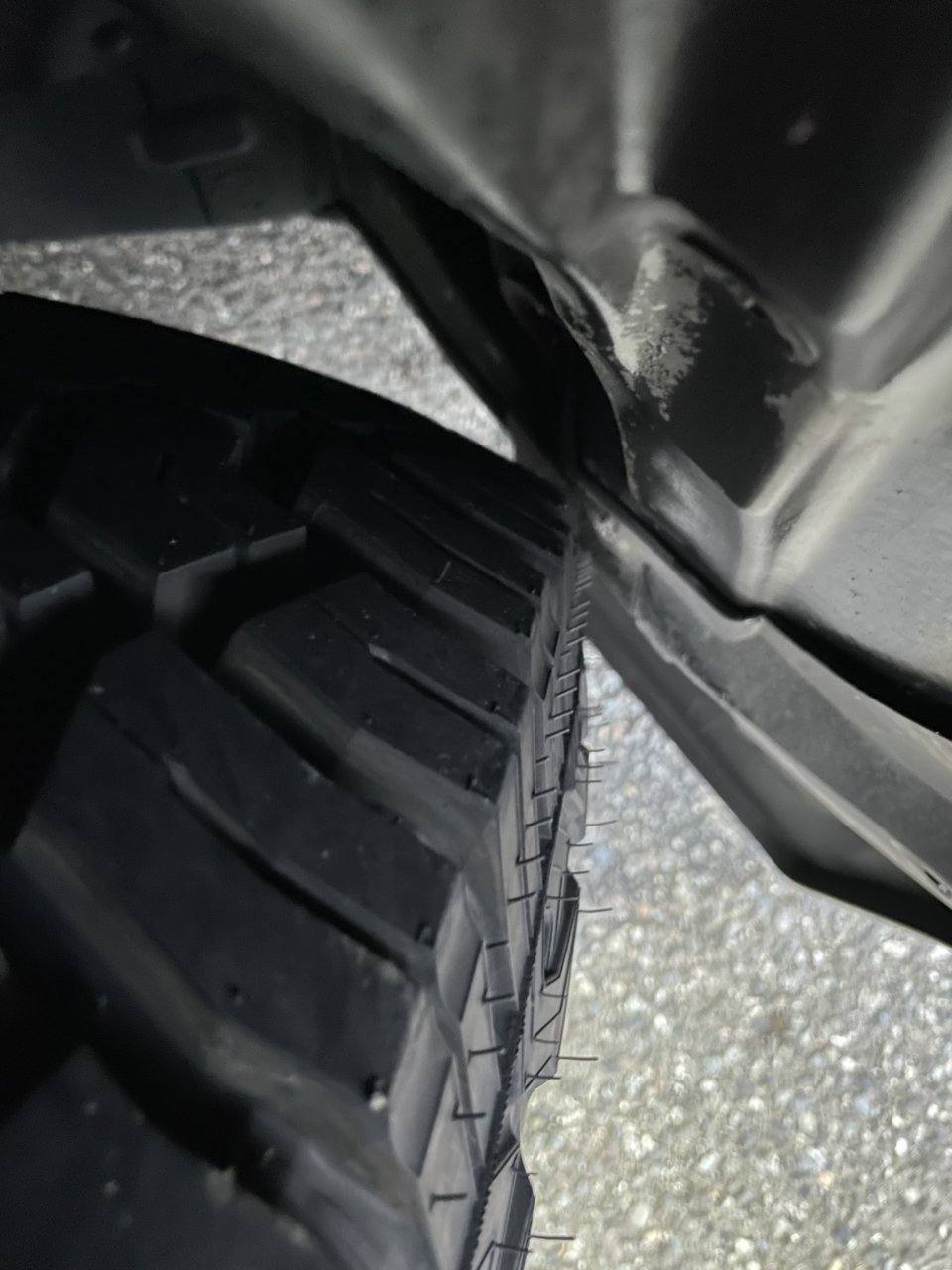

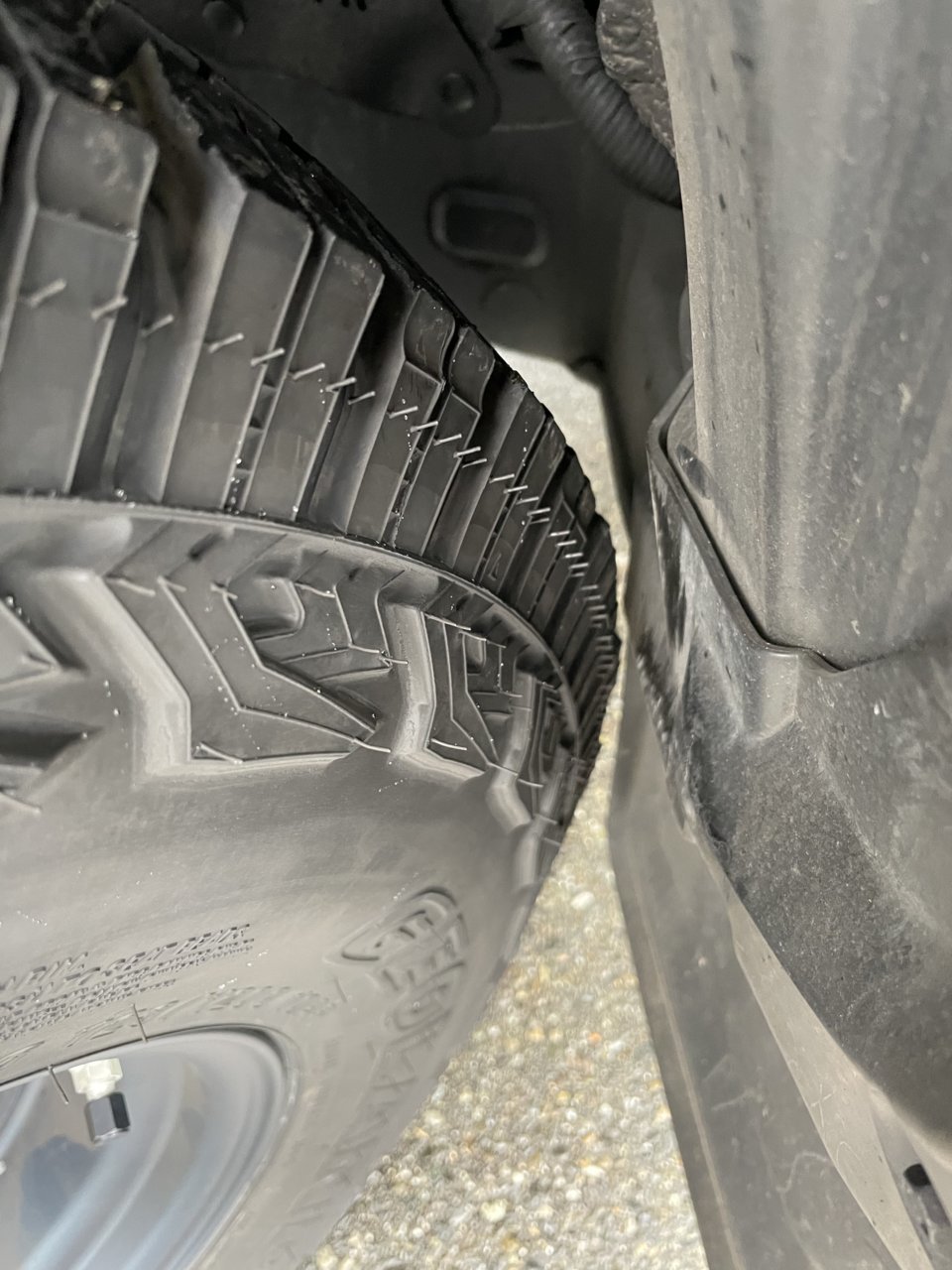

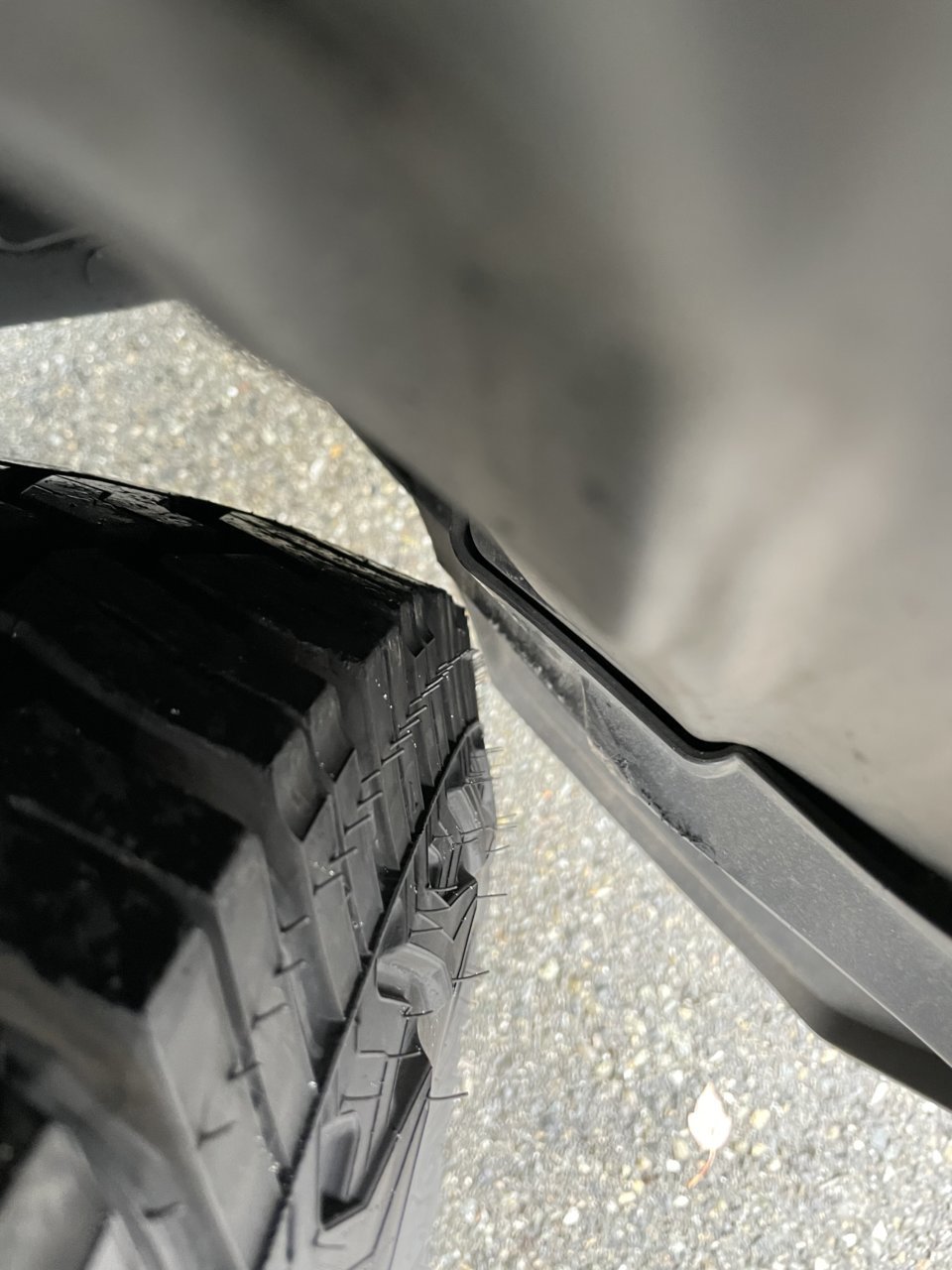

    Rub at stock height means rub when suspension is flexed offroad...if you go offroad

    Absolutely. This is for daily driving. If you look at the above pics the clearance is literally 1cm. Obviously it will still contact when offroad. 74 weld UCA’s going in soon. Then let’s see what the clearance is when caster is 4 degrees. The predator bars also gotta go.

    He will hear and feel it when he is turning into a graded road or driveway.

    A bit of misinformation here, pro or not..sure, long as you only use your truck to watch it from the driveway or on city streets, without moderately steep driveways. 16x8 -20 will come with rubbing problems, and 74Weld UCAs is not a miracle solution.

    Wut… Talking about 265’s not 285’s. Barely contacted on stock suspension. I’m on cougar mountain with a steep driveway. No issues. And yes, alignment with 4 deg positive caster is more than enough to run this setup.

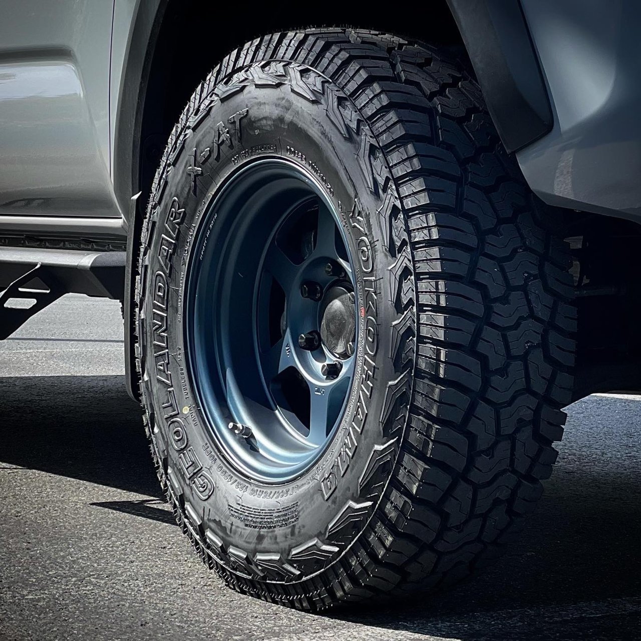

    Luckily no rub here, stock 2021 pro suspension, 265/70/17, -10 offset
