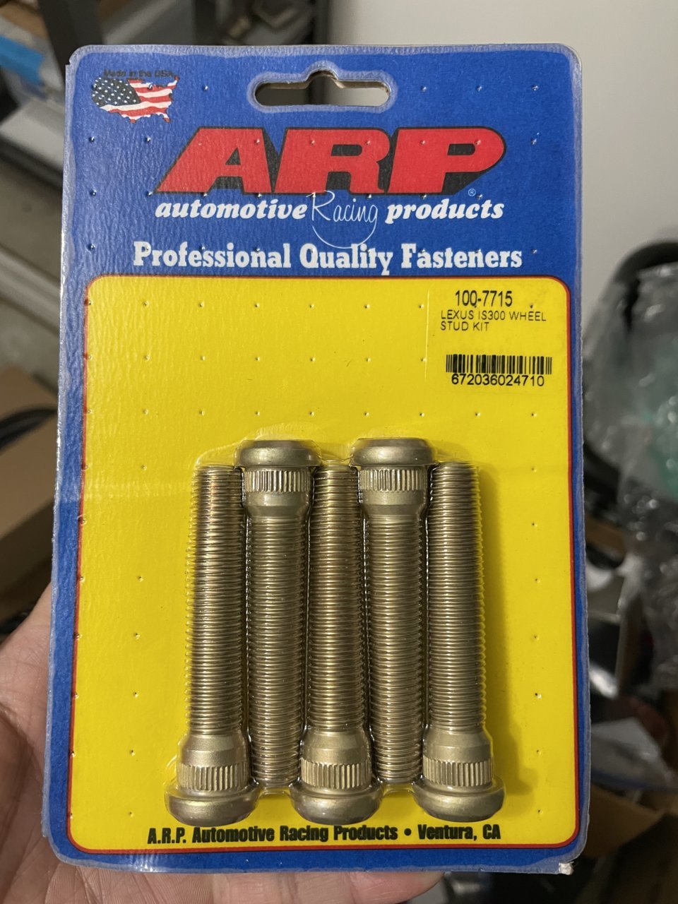

    ARP extended studs I’m about to install part number 100-7715. Just google to find best price. Keep in mind you need to order 5 of these due to 6 studs per wheel, 24 studs total. Pic below.
    Hub rings 112 outer to 106 inner I am using. Lines up the lugs perfectly centered as the wheel mates up to the hub. Highly recommended. This is my 10th set of wheels on multiple Toyota trucks. These Toyotas are exquisitely sensitive. If the wheel is offset a little bit, there will be vibrations and you will think the tires are off balance. I highly recommend you folks pick up these rings if you own aftermarket wheels. Link below.

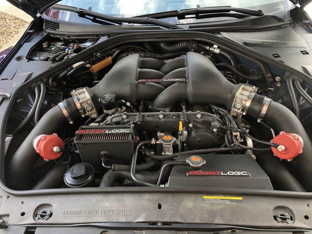

    Here’s my rocket ship!494F5C72-8226-4821-8245-082CE7546ED2.jpg 0EEC6CE7-019C-47BD-9B6E-F792A5BD0C55.jpg

    Awesome! Based on the intake mani, size of the intake and intercooler piping, crank case vent to atmo catch can with 10 AN fittings you’re pushing 1k+ WHP. 12 injector setup is next?

    Bingo, right at 1k… Next up is a different car though, brilliant machine but it really feels a bit long in the tooth.
