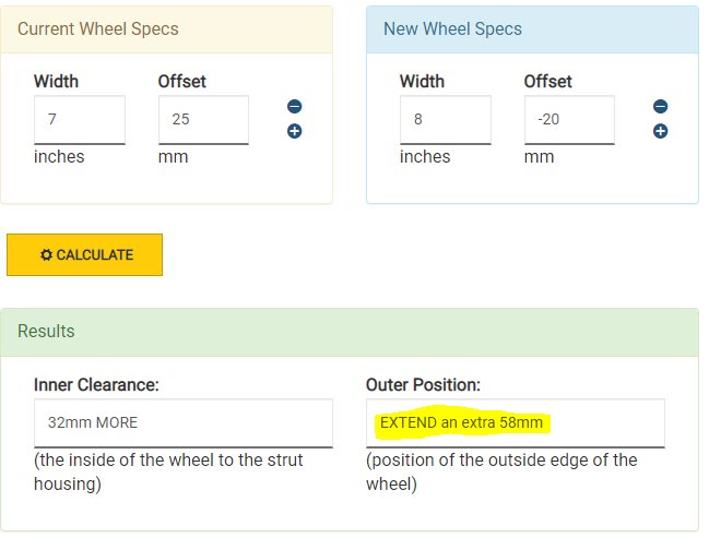

    Thanks for the link! Although I'm not sure how much trimming I have to do to clear -20 offset with 265/75R16 stock height TRDOR. I want to keep trimming to a minimum hence 0 and maybe -10 offset.

    With a proper alignment? Zero trimming.

    Proper alignment as in max positive caster on my otherwise stock truck?

    I don't think it has to be "maximum", but yes, push the tires forward, away from the cab mount.

    Your tires will stick out about 2.3" from where they are currently (assuming stock TRDOR wheels) which increases the radius in which the tire turns putting it closer to the front and rear of the wheel well when turned lock to lock. Trimming and/or remolding the fender liner will probably be required but can be minimized by a good alignment as Bert pointed out.

    I'll be going with a -10 offset anyways as I think it'll be easier to fit anyways, has the deep dish, and still looks good.

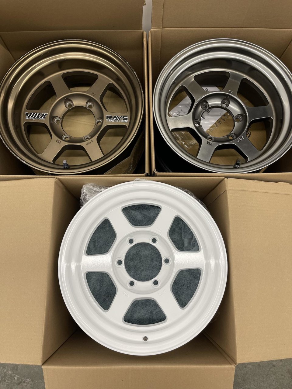

    I know it's a long shot but I'm looking for a set of 16x8-20 TE37X OG (non engraved version) in white if anyone has any leads or some for sale. I have the same set but in +0 (16x8+0 white) I can trade if needed (not for sale). I just want all my wheels to be the same size lol

    Do you have a spare +0 you would sell og

    none for sale, sorry.
