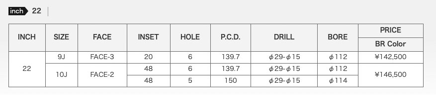

    Rays will discontinue wheels throughout the years. OG's were discontinued when the Progressive 16" X and 18" Large PCD came out. Te37xt is now the intended offering for North American market of 6x139.7 (Toyota, RAM, and even Chevy) / 6x135 (Ford) / 5x127 (Jeep - JL) throughout the given specs.
    18" PCD in specific. The 18" XT is the offering for Tundra / TRX - Ram / and Raptor.
    18" Large PCD is already discontinued. No more factory orders, a few stragglers from delayed shipments may pop up or old stock as dealers decide to release them.
    The Large PCD was only offered in 18" and an Ultra - 20"
    For any ballers with Land Cruisers ... Ultra Large PCD is now available in 22" lol

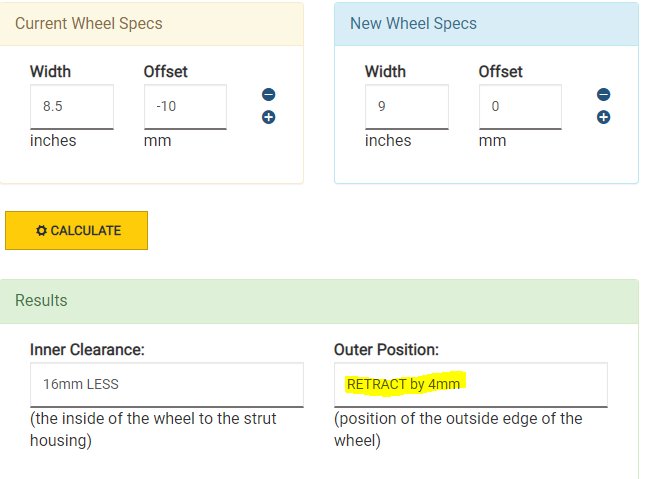

    thanks, I have the SCS F5 exactly that size 17" running 265/70/17 (stock size) for 4Runner, they rub against mudflaps and front edge of the inner wheel well at full lock and reverse back into a slope. I think that 4mm is all it need to stay clear.
    just ordered the last set of that from showstopper. Going to mount a set of slightly small than stock Michelin Defenders at 265/65/18, so I should in theory have less chance of rubbing after.

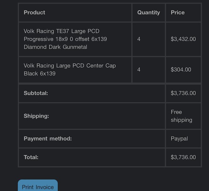

    I searched everywhere, they are all exactly the same price or higher. Either the profit margin is really just wafer thin or they are all colluding with each others on price.:anonymous:
