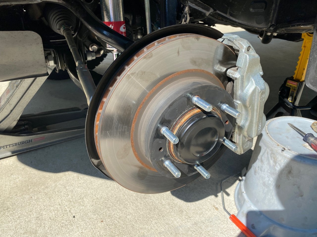

    Its strange to say the least. Its like the rear hub has a different design than the front (I was able to poke the threaded part of the 610-463 through the hub opening, but that smooth part would not go through whatsoever and I wasn't about to ruin a hub. I compared the front OEM stud vs rear OEM stud and could not see any visual differences.

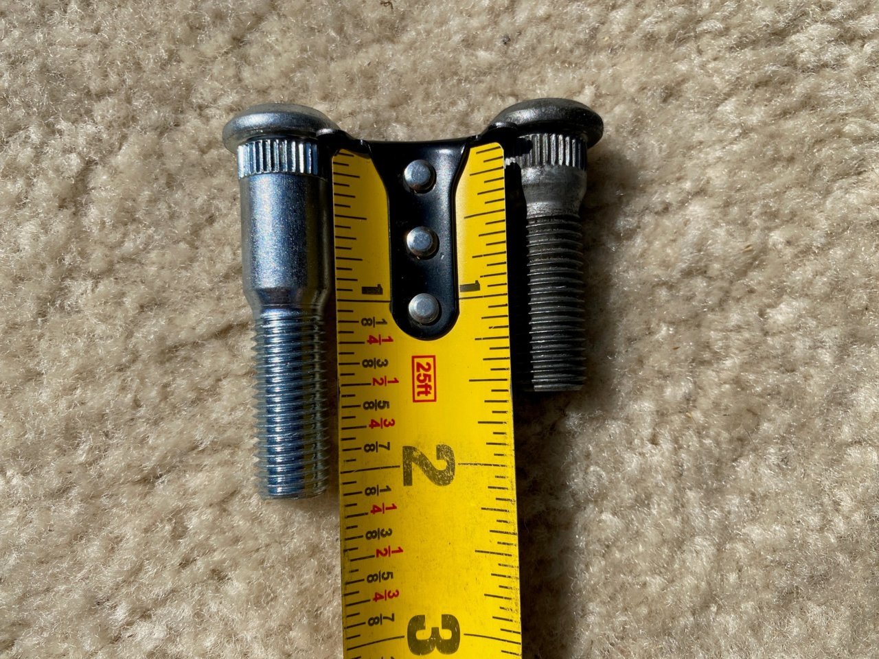

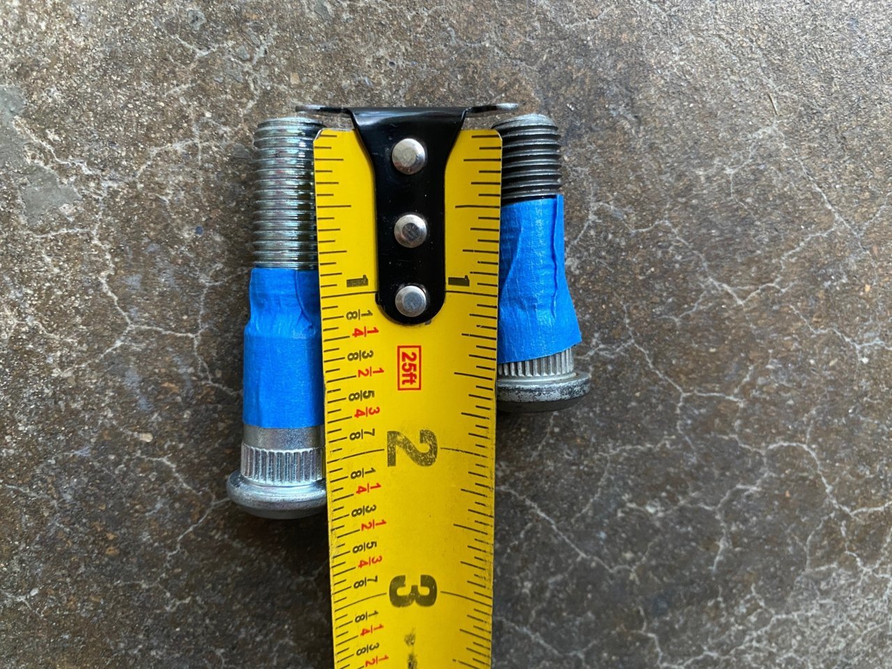

    Here is a comparison of the stock OEM wheel stud vs the Dorman 463
    This shows the number of thread engagement of OEM (6) vs Dorman 463 (13)
    Dorman 463 installed on front hubs (smooth part gets buried with the wheels set in place)

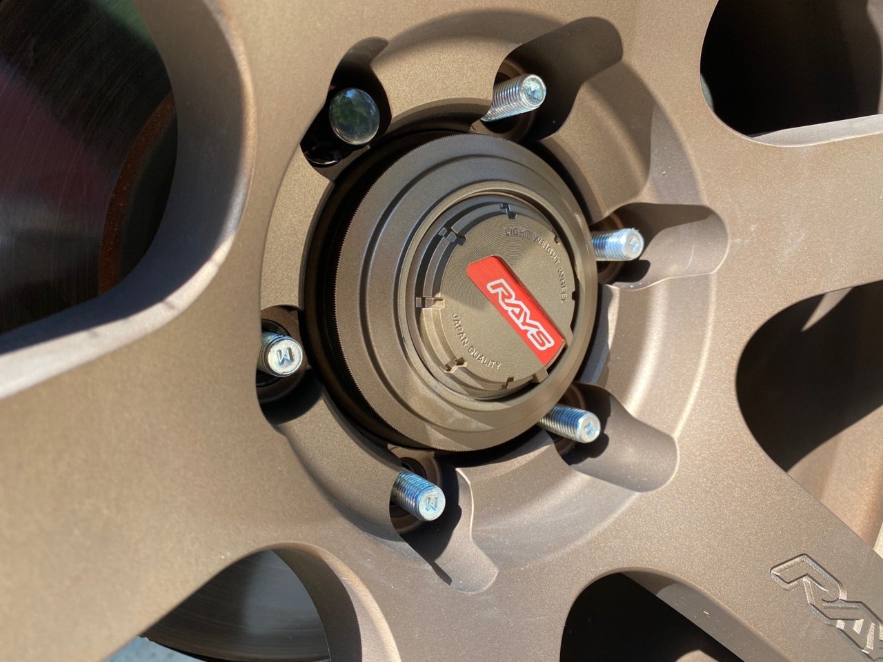

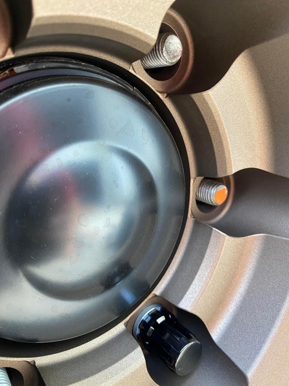

    OEM wheel stud protrusion on my Rays 57DRX:
    Dorman 463 wheel stud protrusion on Same Rays 57DRX after installing on front hubs:

    Well, being the heaviest frontside with the engine weight + steering is complete, I can feel a little more at ease driving now that the Dorman 463s are installed in the front. Understandable that Toyota engineers 12 turns as they know people can be rough on trails, especially with their frame on body models they sell.
    I have read in another post that they do, so I'll roll the dice and take my chances. From the looks, they don't have the smooth shank which got in the way on the rear hubs so these look like a good bet. There is also this brand, Ichiba that was mentioned in another thread as well:

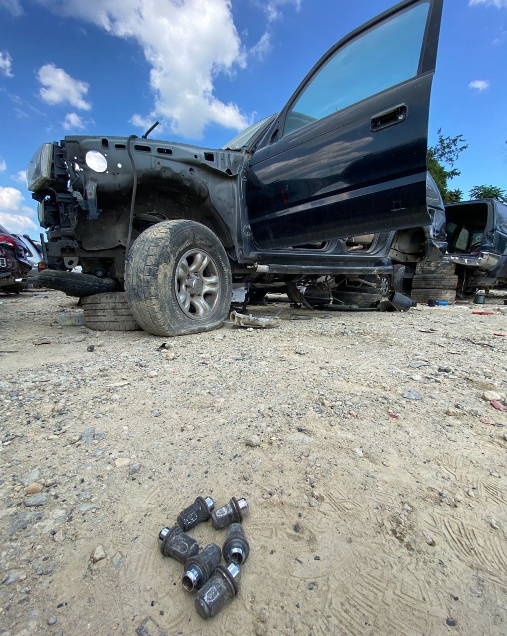

    Also do not forget about your spare tire in case of an emergency. The spare is a steel wheel without the oversized opening, so that right there saves some depth. Just got back from the yard after doing research of which Toyota lugs are long from the factory. Came up with 4Runner so pulled a few off this 2001. Tacoma inside lugnet depth = 1 7/16", 4Runner = 1 7/8". I'll carry these lugs under the seat in case I ever have to use the spare.
    Kefka and malatx like this.
