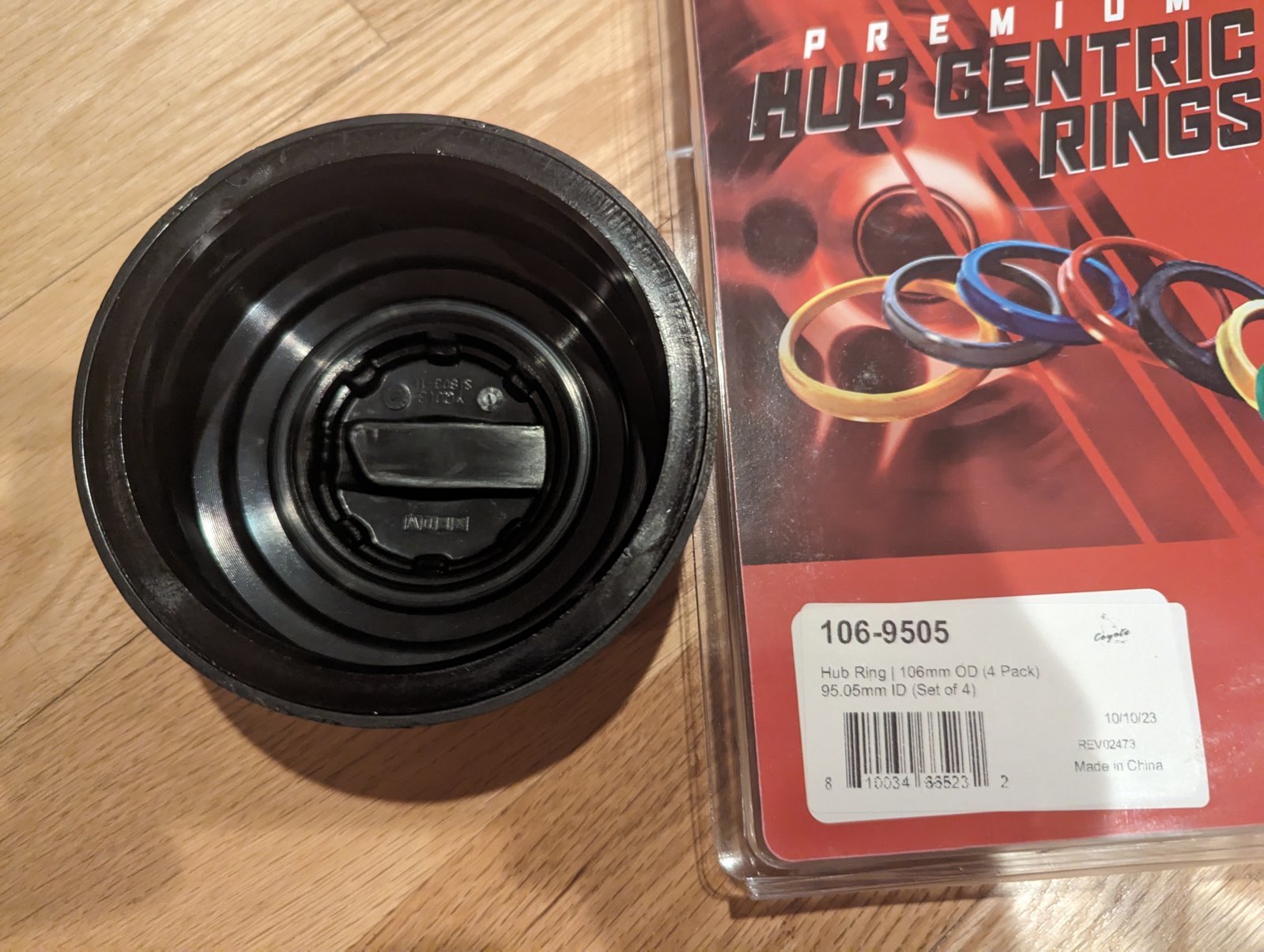

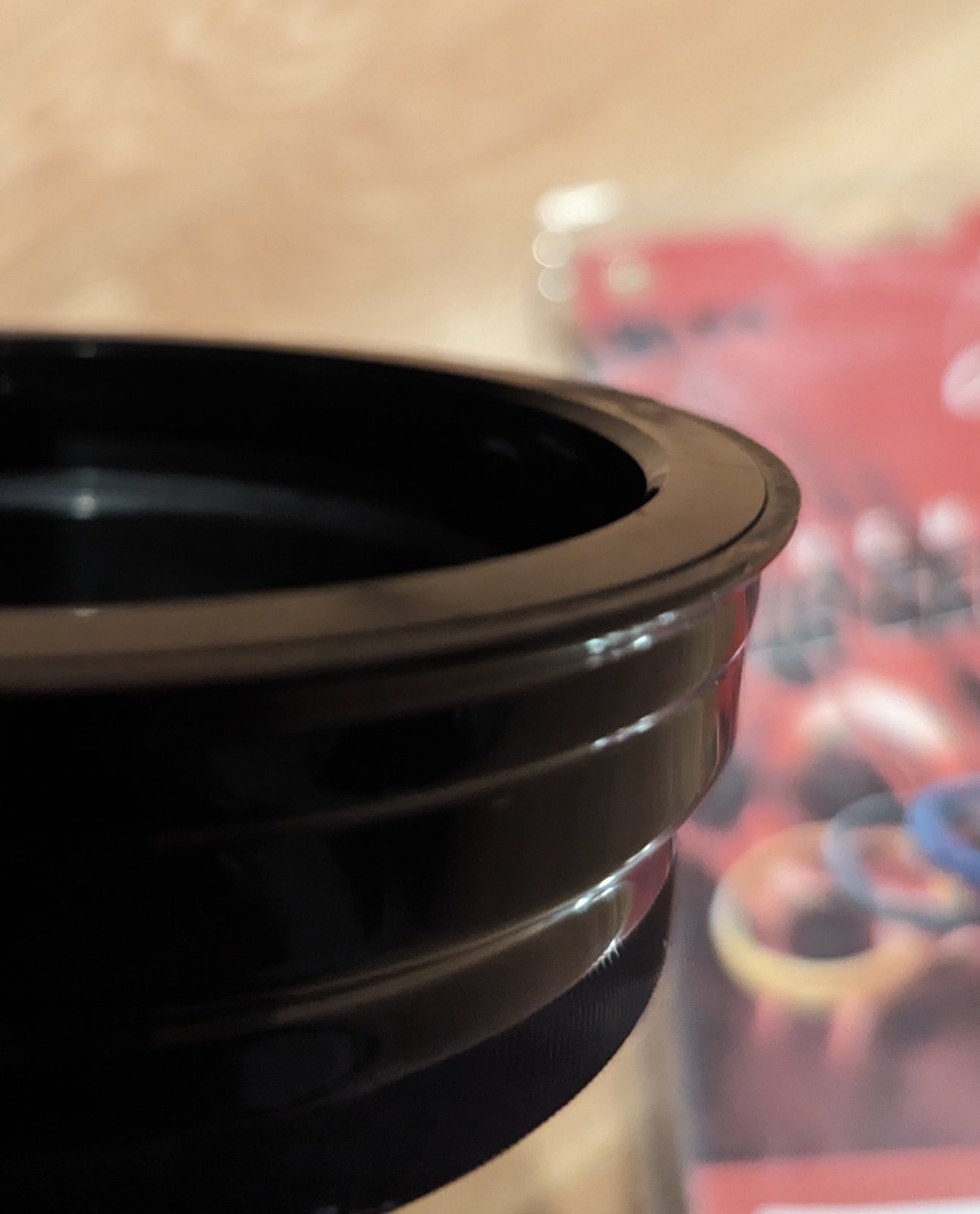

    Got some hub rings in. Since the center caps are 106 ID was curious to see if some $10 Amazon rings would fit. And to my surprise, they fit like a glove and even have a reassuring "click" when inserting them. Anyways, have a backup set of 112 to 95 in case this doesn't work out, but then I'll be without center caps.
    Studs go in tomorrow and we'll see how this all pans out.
    Seeing other pictures of 4Gs with TEs kinda makes me wonder if those guys also swapped studs. I got about 6 turns on the factory studs and did not feel like that was enough.

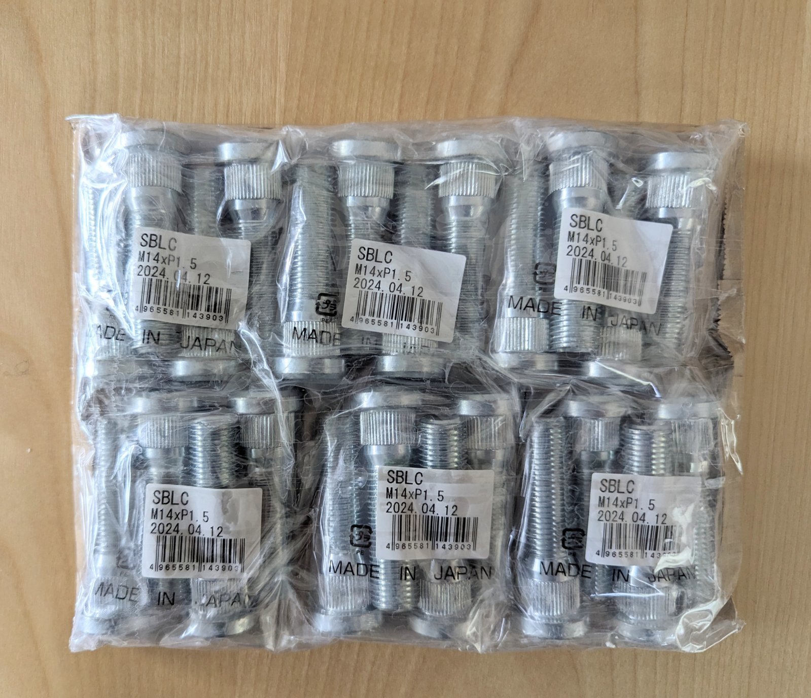

    Here's the finished result on the Rays ALAP07X.
    Prior to installing these, I had to swap the wheel studs as I previously posted - I was only getting about 5-6 turns on the front on the factory studs, wasn't super comfortable with that. I ordered 24x KYO-EI 55mm SBLC studs via Rakuten Japan for about $120 shipped, a lot cheaper than what you'd find them for via Blackhawk Japan or other JDM sellers.
    Swapping wheel studs was pretty simple. Since the 4G has disc brakes on all 4 corners, it just involves removing the rotor and caliper (2x 19mm bolts) and specifically for the fronts, removing the (2x 12mm) bolts that provide additional support for the front brake lines.
    The fronts banged out super easy and with the 55mm KYO-EI studs, no bending of the dust shield was required. Rears took a little bit more hammering but they came out. I used a 2lb hammer but suggest you maybe go with a 3 or 4 pounder, should make it easier. I also used a $6 stud installer off of Amazon along with a factory lug to seat them in with my cordless impact.
    Obviously when working on your truck, if everything seems to be going too smoothly, Murphy's law is bound to hit - the stud installer did take a shit with 3 studs to go, but I guess for 6 bucks, what do you expect - these things are basically single use. Also my trusty 1/2" torque wrench gave out - the calipers go in at 91ft-lbs and the lugs at 83, but it felt like they were all way too snug. My hunch was right, as my impact could barely remove them after torquing. So had to also make a quick trip to Lowes to get a new wrench. Go figure.
    Here are some pictures of the difference between the factory studs and the KYO-EIs.
    Not a huge difference but it ends up being double the thread engagement of the factory studs. With those Gorilla lugs I was talking about, they literally sit flush even though they're open ended.

    Hi, just curious did you use the supplied o-ring with those center caps?
    Also, thanks for bringing the hub centric ring hack to my attention. I might have to do the same when i put the TEs on the LC.

    I got the center caps used and they didn't come with o-rings. With the hub rings installed they don't spin, so no need for o-rings.

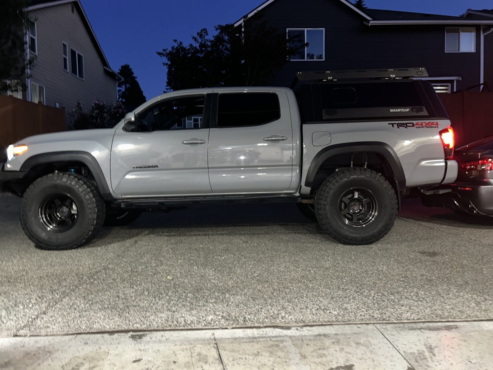

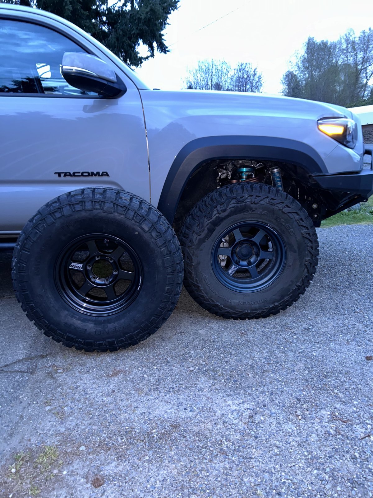

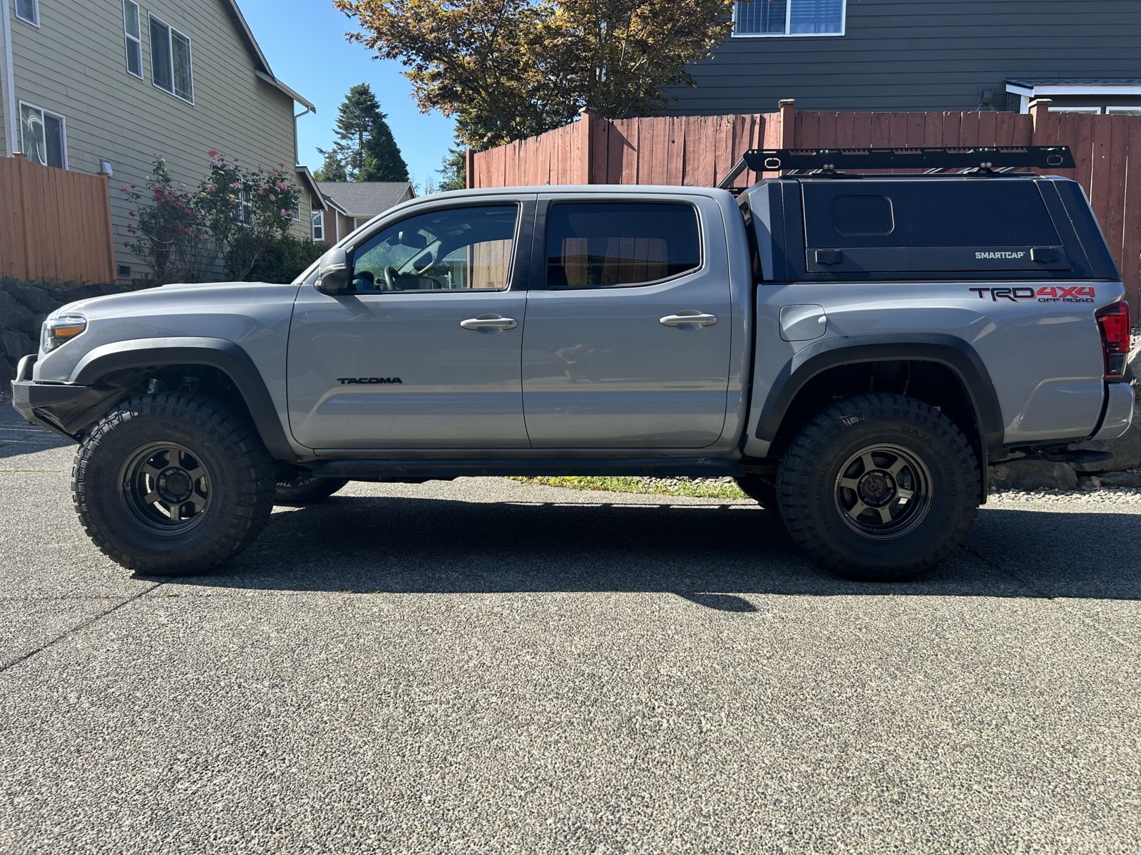

    finally got these onto the truck, thanks @tonered with the help installing Accutune UCAs, trimming and of course, hammer time!

    Yeah!
    Gonna change my username to tiny tires tonered. :rofl:
    It's like I missed leg day.

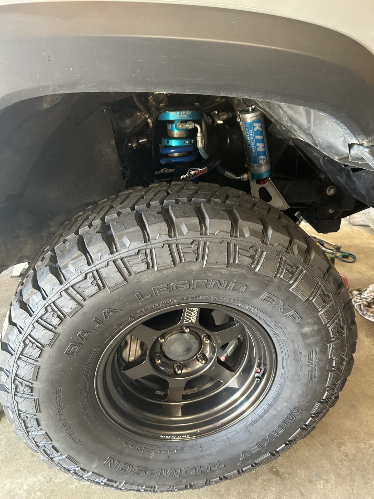

    Looks great!! I'm about to install my TE37's and King EXT suspension, curious how much front lift you have to fit 315's? I won't be flexing too much, mostly on-road driving. Thank you

    thanks! I think I’m around 2” of lift, so not too high and wheels are 16x8 -20. I have an aggressive CMC, hammered pinch welds and inner fenders. It rubs a little bit on the driver side CMC currently but I haven’t gotten an alignment since installing the Accutune UCA and 35”s. I should have it all dialed in within the next few weeks due to travel.

    That’s an easy fix tony. Time for some thicc meats
