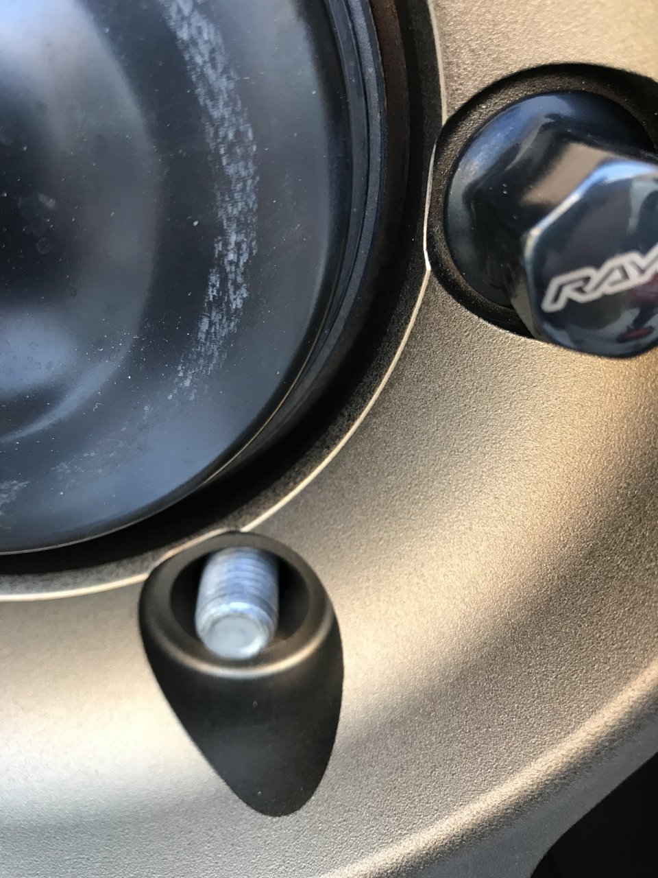

    Not a problem, you have plenty of grab AF6A509C-4D58-42C2-AC0B-6687B7F9AF3F.jpgAF6A509C-4D58-42C2-AC0B-6687B7F9AF3F.jpg 7652DA70-712F-4758-A03D-A805B5D81FBB.jpg

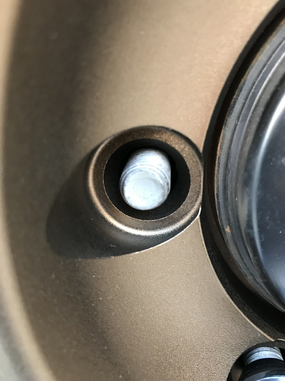

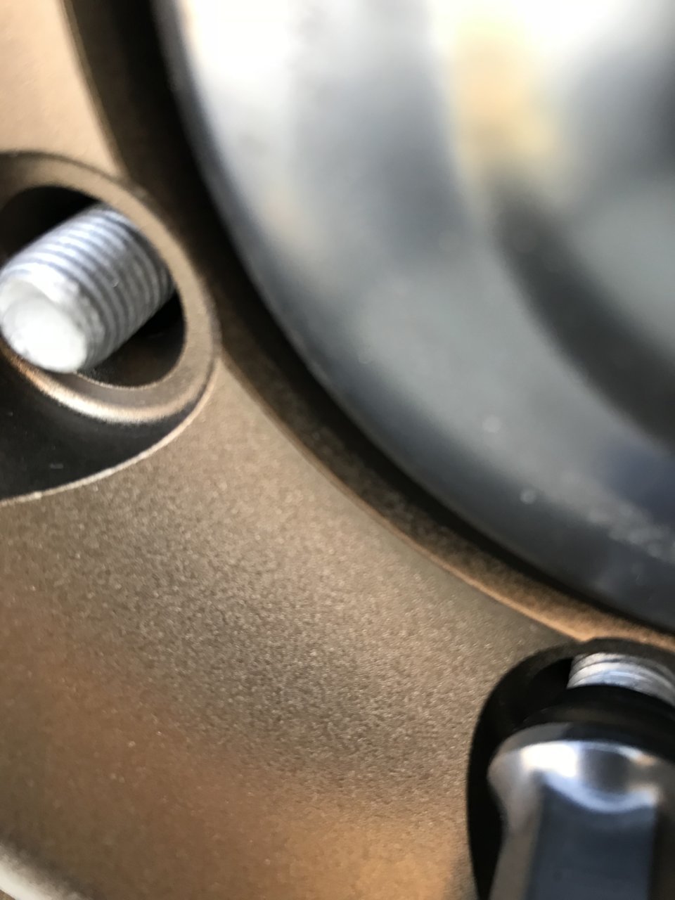

    Are you getting 6.5 turns of thread engagement? Mine looks the same but with the same lugs I am getting less than 6.
    I put 5mm longer studs on the front today and will do the rear tomorrow. The will give me an additional 3.33 turns. In my opinion with what I spent on these wheels it is not worth the chance of a wheel coming off on the freeway.
    This is a common problem on our trucks when aftermarket wheels are installed. Toyota uses really short studs. Most can get around it using extended thread lugs. These won't work with the Volk's.
    Eta. With 6 turns it is only getting 9mm of thread engagement. This is less than 3/8".

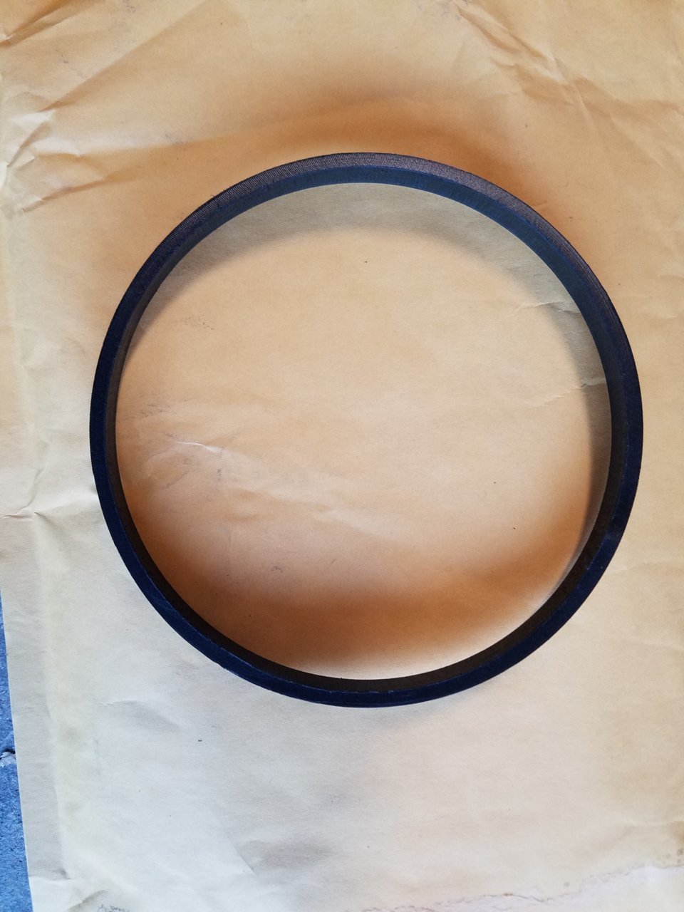

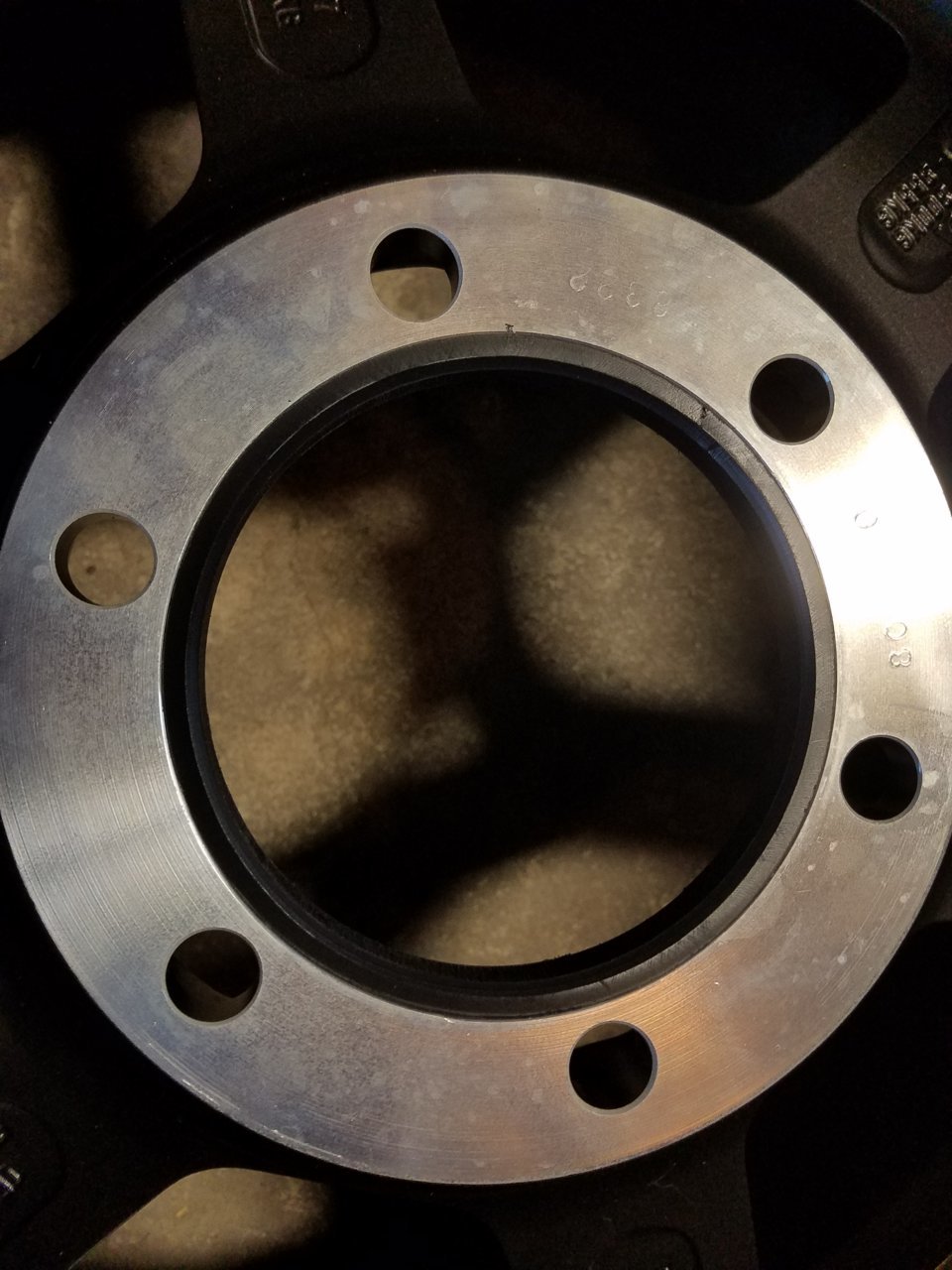

    For anybody looking for another source of hub centric rings I got mine from US Wheel Adapters today. They are custom and do cost more than other options but do come in black. The rings fit perfect, almost like they were made for these wheels. They are a snug but not too tight of a fit. I got them with a 112mm outer and 106.1 inner dimension.
