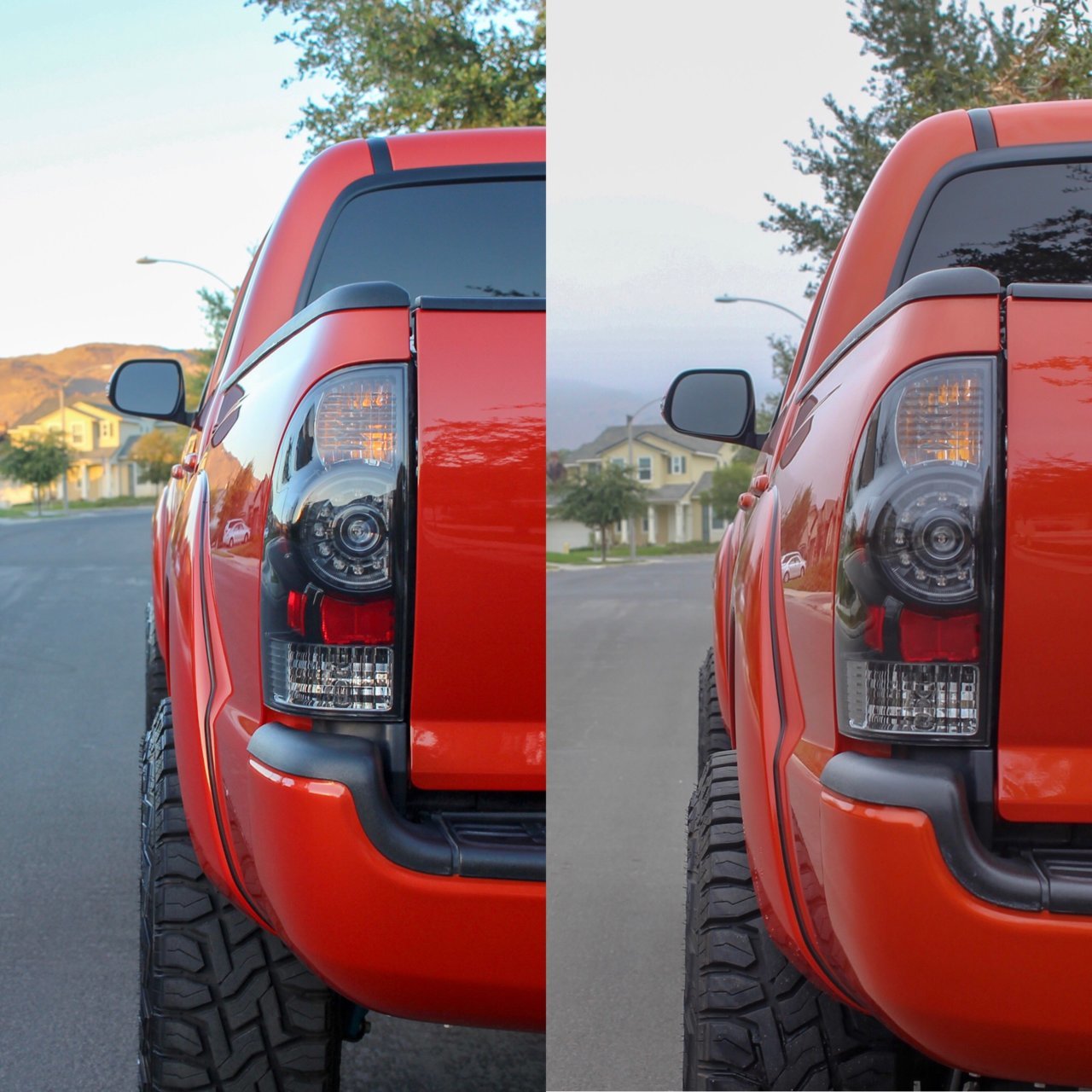

    On second thought, the 16" TEs don't look half bad :D
    Does anyone have those comparison pix of the +0/-20 ET mounted... I swear I saw it in this thread but I couldn't find them when I went back a few dozen pages o_O:thumbsup:

    Thank @BVita for posting these crucial pics of the ever questioned +0 vs -20 setup on the 16" TE's

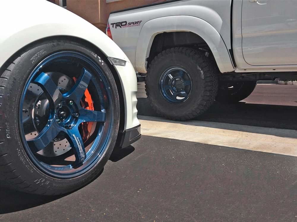

    Uffff, r35 and TT LT Taco ftmfw! :hattip:

    I just love how small the face looks of the 16" x.. Especially with a 33" MT...
    The 17" xt will shine with the variety of tire choices between the 285/75 and a 295/70 sizes
    Hahaha thanks for digging up the post @93truck!

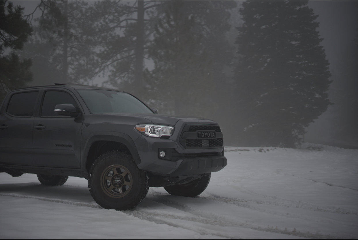

    Theres a ton of factors that go into this, and your definition of "fit"
    With a 2.5" lift, I cleared my et0 te37x with just some plastic liner trimming, but no cmc.
    This was also a 2" of lift with 315/75r16. It "fit" for everyday driving, with a fair amount of work from a cmc, pinch welds, cutting up my plastic fender liner, and a lot of trimming to clear it for the street.
    [​IMG]ORG_DSC02880 by b vita, on Flickr
    With absolute no rub / minimal amount of plastic trimming? - 265/70r17.
    You *may* get away with a 285/70r17 all terrain tire, like a ko2 at a 2" lift with some added castor from UCAs with no other modifications.
    17x8.5 -10, spec wise, is in between the 16x8 et0 and 16x8 -20.
    Which is what I ran here, with a 285/75r17.
    [​IMG]DSC03338 by b vita, on Flickr
    With a cmc and 2" of lift, you can clear a 285/75r17 as well.
    [​IMG]IMG_9863 by b vita, on Flickr

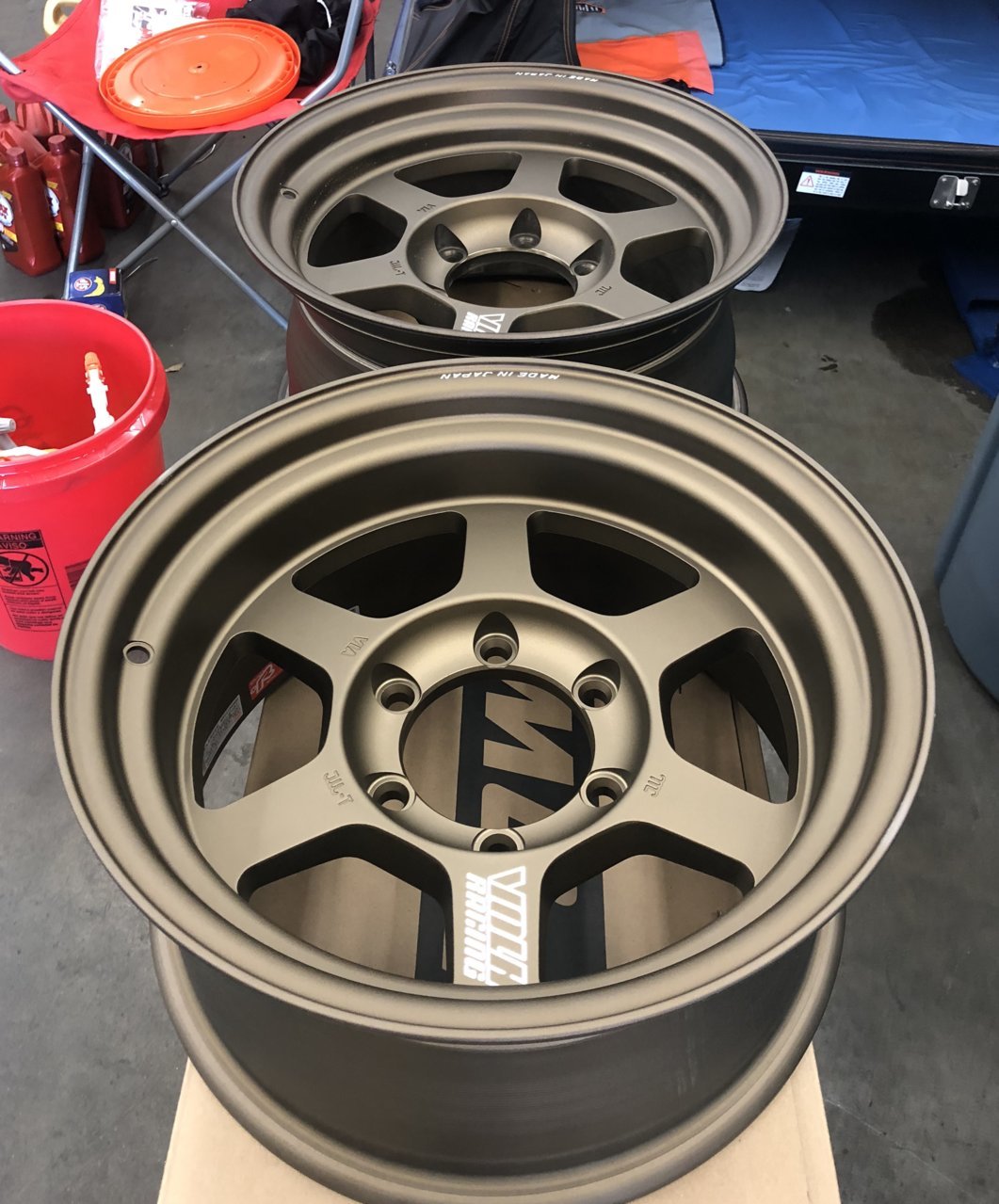

    TE37 all the things!! Throwing a set on the runner too I think.
