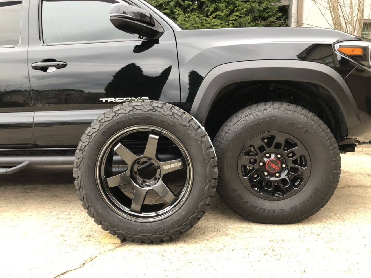

    Found a set of 16” te37 for sale locally. Will 16x6.5 -5 fit in the front of 2019 Tacoma? The rears are 16x8 0 and I know that will fit.

    295/75/16 alittle bigger than 285. 305 didn’t make sense to me because it’s same as 285 just wider. -20 no more spacers for now. Need to flex suspension to see if it rubs.

    Possibly. With that spec, you *should* clear suspension components. Unless the spoke itself is different, you also *should* clear the caliper. There are sets of nismo te37x that a few tacoma people ran, but they used 1.25” spacers.

    You don't really want a 1.5" stagger front to rear. Your tire sizes will have to be different, which may look off. And you won't be able to rotate your tires.

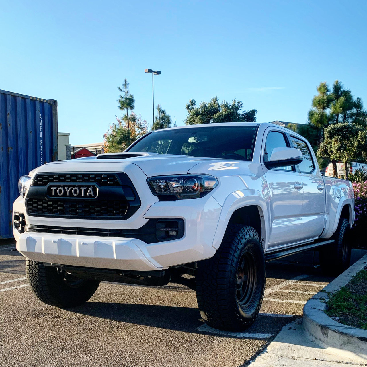

    Hope everyone is enjoying the first weekend of the year.
