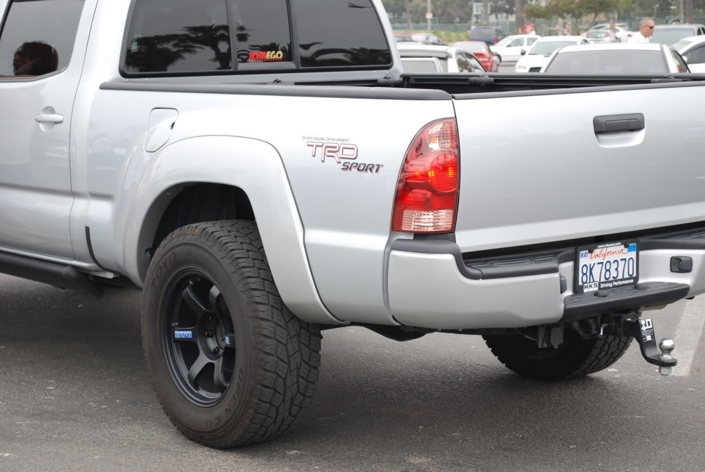

    BTW, supposedly this is the 18x9, 0
    unfort one person posted it, and another responded about specs, and neither have been on in a while. i'll be forced to email 'em!

    Those are 18x9 +0. As for tires they look like 285/60/18 Toyo AT's.
