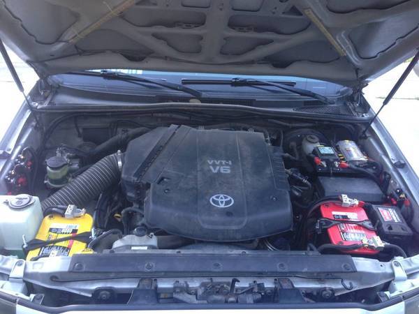

    Yea def want to know more about this. I too have my aux fuse panel hooked up to my secondary battery and after extending camping trips where I run that battery down because of all my accessories, my Blue Sea ML-ACR won't automatically charge the secondary battery when it has low voltage. I have to manually link them until the secondary battery has charged a decent amount, then I can put it back on auto mode.
    My set up:
    Optima Red (House) and Yellow (Aux) batteries
    Blue Sea ML-ACR Automatic Charging Relay
    Blue Sea Aux Fuse Panel
    High output 250a alternator
    Big 4 upgrade
  7. Dec 5, 2015 at 10:00 AM

    Hey MJ,
    The ACR has a low voltage lockout @9.5v and reset at 10v. Placing the sensing wire somewhere else won't help the ACR reconnect the two batteries. Because the ACR isolates the Aux batt in a UV condition, it's waiting for the aux batt to stabilize its voltage from a deep discharge. This can take a very long time depending on the health of the batt.
  12. Dec 7, 2015 at 4:20 AM

    Correct, but MJ stated that his aux batt goes low when he's camping running his fridge and lights with the truck off. His blue sea acr is doing its designed function keeping the batt separate until voltages are within cutoffs.
    In the case where the truck has been off while camping and stuff, moving the sense wire will help recover aux batt voltage faster only after he manually connects the batteries from the acr.

    @Spencer - Mike is right. My aux battery drains when long-term camping and truck is off. Thought you understood that and still determined that relocating the voltage sensing wire would help.
    But yea Mike, that's exactly what I was talking about: I know the ML-ACR has the low voltage lockout, but it's also the thing that irritates me lol. Because let's say when the battery gets drained when I go camping (Not like when we camp and wheel throughout the trip, this is when I camp and don't move the truck for days), and it's time to leave camp, everything on my aux battery doesn't work until that battery gets somewhat charged. That includes my alarm, headlights (bc I have HIDs - ballasts hooked up to aux battery), and off road lights (like if I leave camp at the butt crack of dawn and it's complete dark out). Not to mention the fridge not being able to go back on or even my air compressors if I need to air back up.
    I think what will eventually be needed is to replace my aux battery. I think it's 4 years old and for the first 3 years it was my primary battery with everything hooked up to it. When I went dual batteries I moved it to my aux battery bc it's a Optima yellow top and works as a deep cycle batt.
