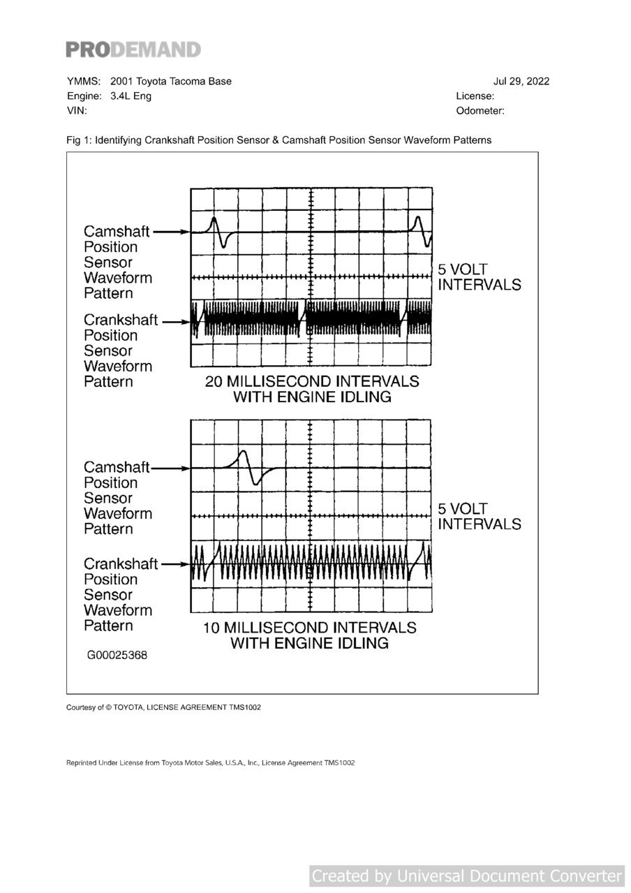

    Based on what I can find in service info the cam sensor is a variable reluctance type and generates it's own signal so there will be no voltage on the cam sensor wires. The only proper way to check cam and crank sensor signals is with a lab scope.
    Here's a sample waveform.

    Yea there are ways to "test" the sensor somewhat with a meter but I've never found any of those tests (other than if the resistance is way out of spec) to be conclusive, the only sure way to verify signal integrity and timing is with a scope. I'm not the greatest with using a scope but there's been many instances that I've diagnosed faulty wiring or a failed sensor with a scope that would have been nearly impossible to find without one.
    Typically a fault in the cam or crank sensor signal will set a trouble code and/or cause a stumble, stall, long crank time and/or no start. What kind of issue are you having that's leading you to the cam sensor?
