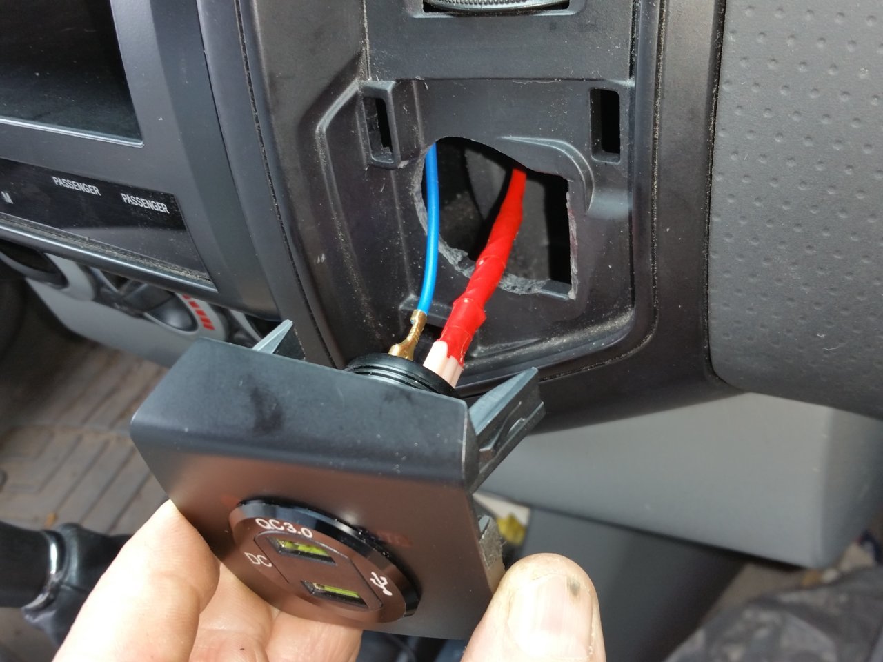

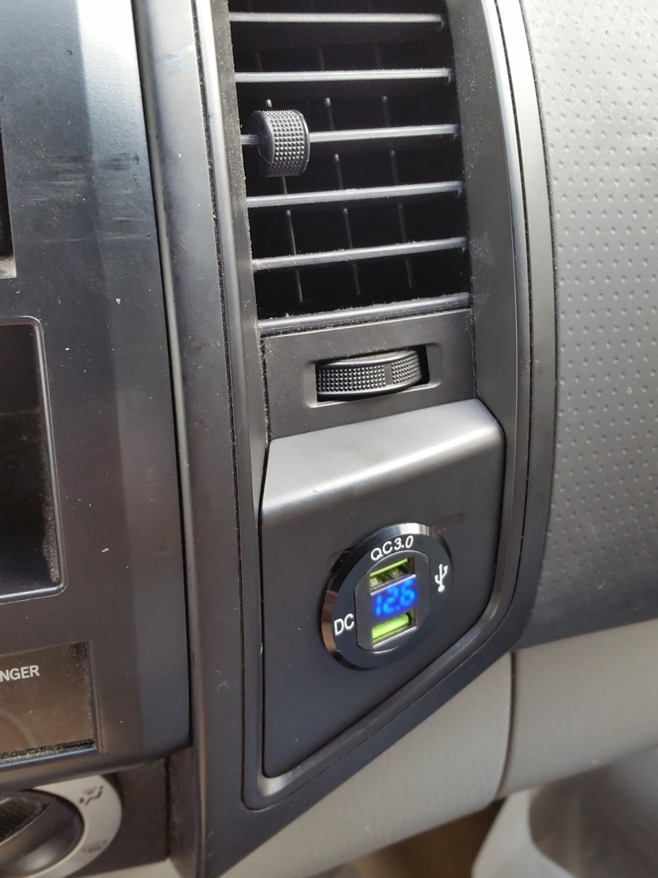

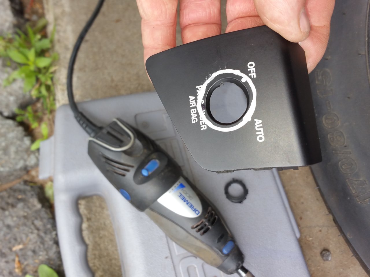

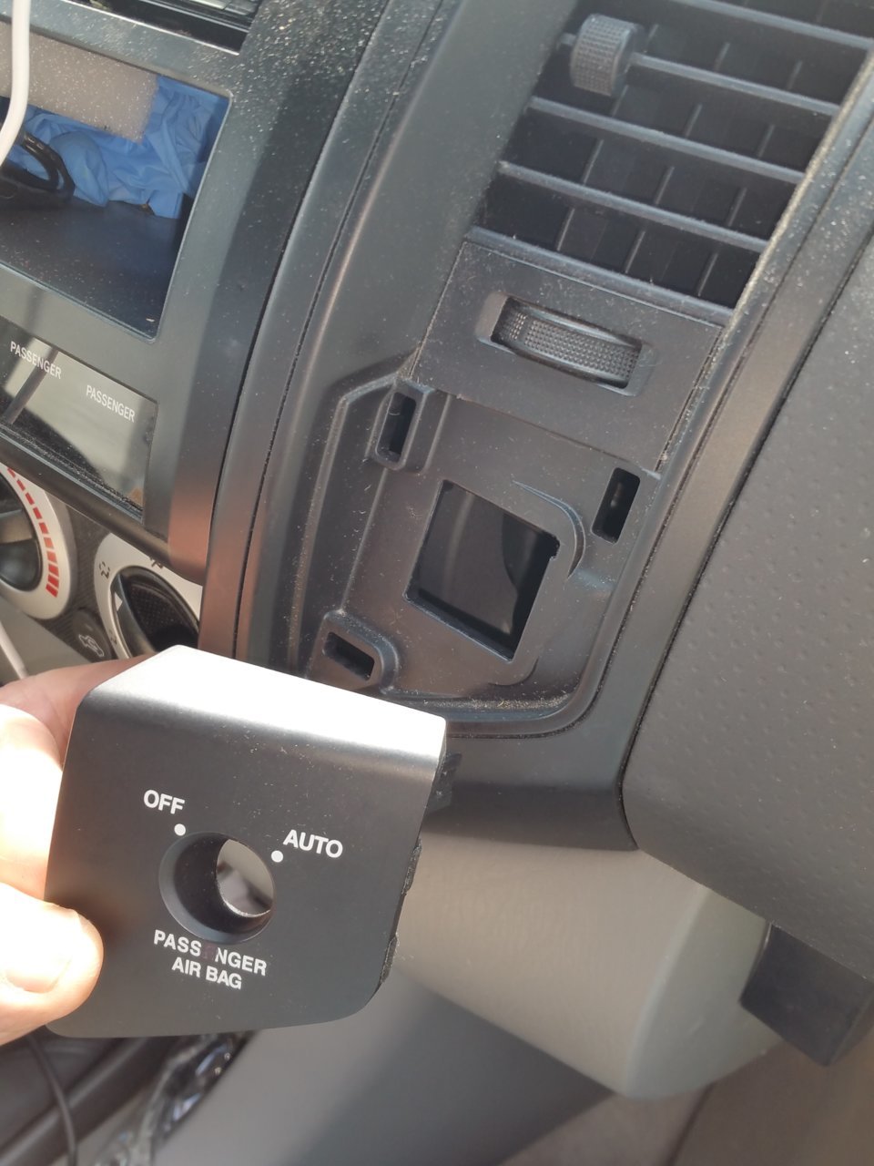

    Came up with a neat place to install my Voltmeter/Dual USB outlet. I did this install in my access cab, so I had to relocate my passenger air bag switch(never use it), those w/o the switch will not have to relocate the switch. Thanks for looking.20200603_170356.jpg 20200603_140658.jpg 20200603_111500.jpg 20200603_104618.jpg

    What circuit did you tap into?

    Made it real easy and took the switched power from the radio harness.

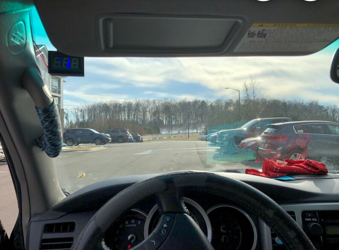

    Anyone know what the best voltmeter is?
    Dont see the point of an expensive Scangauge having a manual
    Looking at this one from CascadeCreekDesign
    has a switch with it to prevent mA parasitic battery drain
    not too excited about blocking windshield space though
    maybe right side HVAC/radio bezel would be better
