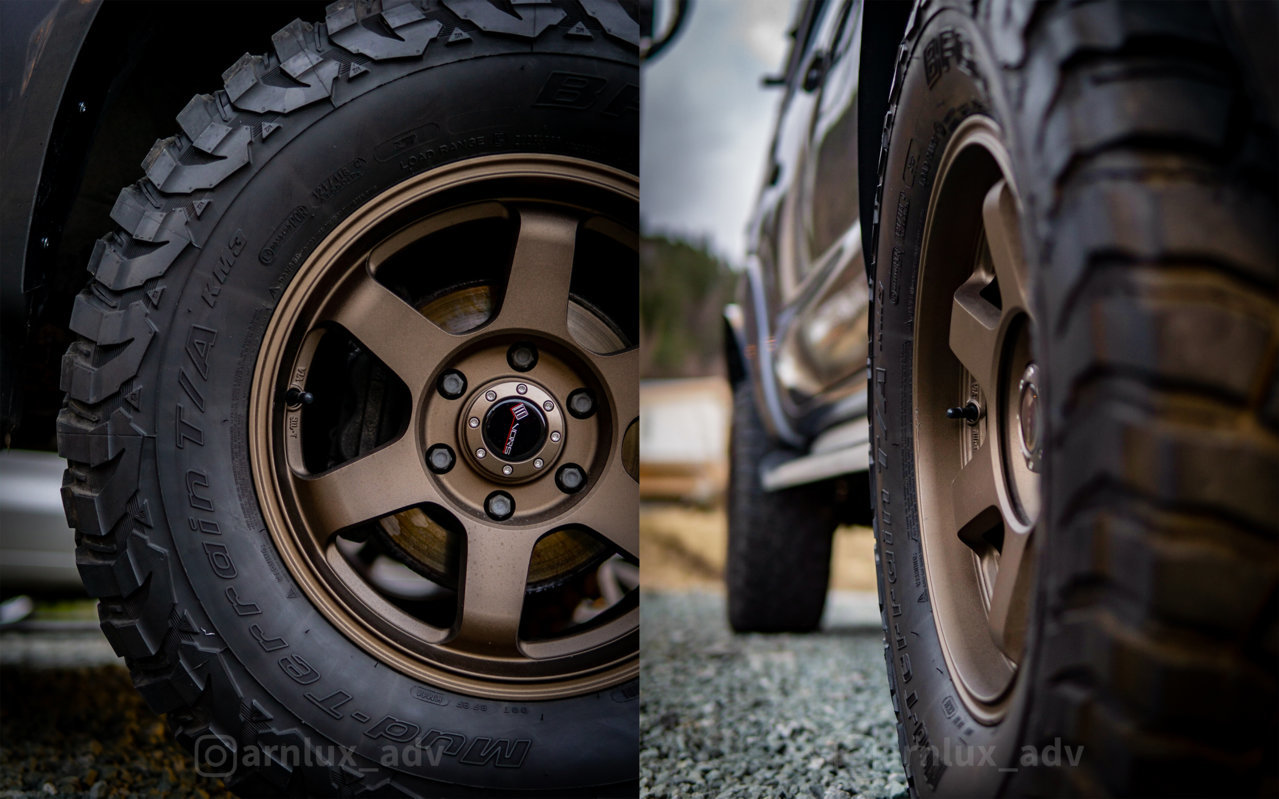

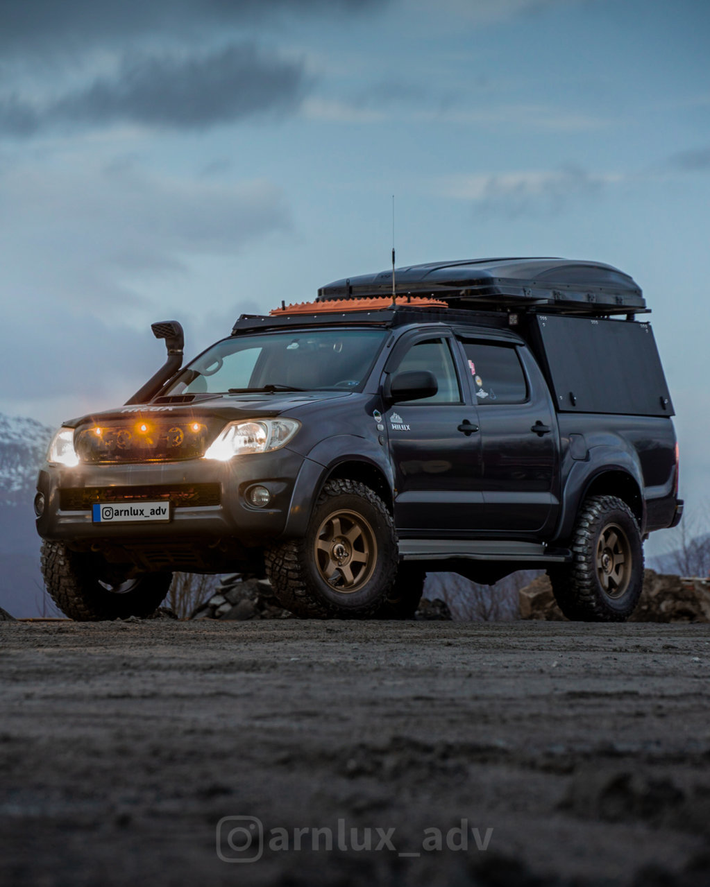

    The temperatures here in Norway are starting to be more stable and its heading towards spring, so i pulled the trigger and mounted up the new wheels today!
    Very happy how these turned out on the truck! Had to do some minor modifications to the bumper and flares to make turning clearance. Rubs a small bit on the cab mount, but have made plans to install upgraded springs in the front since the ones that are there now have sagged over the 4 years I've had this lift. Hope this will help a small bit, but if not its chop chop time
    Here are three photos i posted to my Instagram feed
