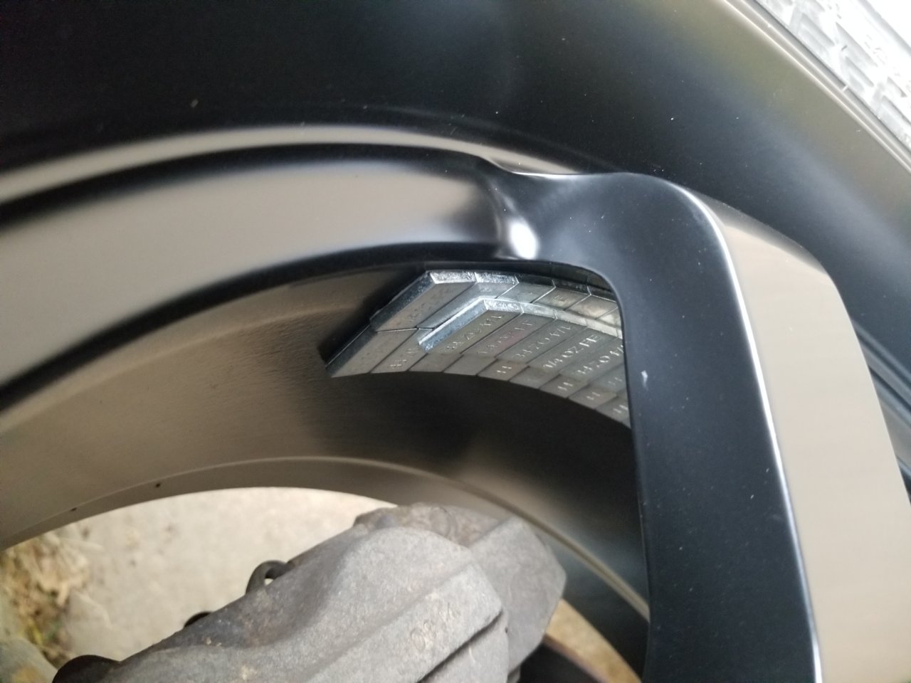

    I finally mounted them. Look good, ride okay, but holy wheel weights batman... All of them are like this.

    Holy! Thats a lot!
    I think i have half of that on my wheels…

    That looks like the amount of weights they had to put on mine.

    I had a similar amount of weights (6oz plus) on two of mine when discount tire mounted my tires (general grabber atx). Both of those tires ended up being replaced by discount tire because of excessive runout. Now all of my wheels are good each having no more than 3.75 oz of weight. These were road force balanced both times…..
    ……the tech doing the balance can make a huge difference. I was lucky and got one that knew wth he was doing the second go around.
    He pretty much face palmed and apologized to me when he saw what the first tech had done.
