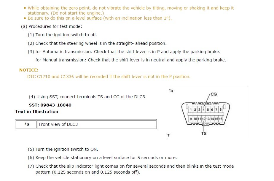

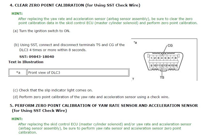

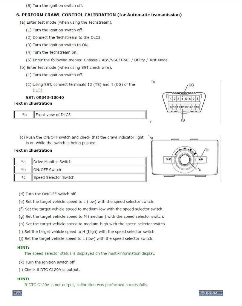

    hey guys I just did a 3in lift on my Tacoma. I'm wondering if any one has done a vsc calibration with the jumper cable on a 3rd gen. I try doing the 2nd gen one and it only makes the abs light go on and off. Any inputs will be gladly appreciated.
      File size:
      78.5 KB
      Views:
      135
      File size:
      76.3 KB
      Views:
      111
      File size:
      111.7 KB
      Views:
      120
