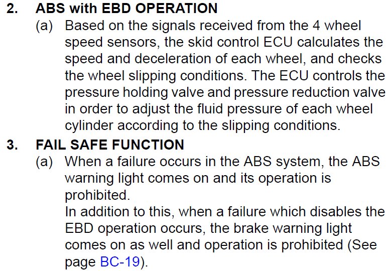

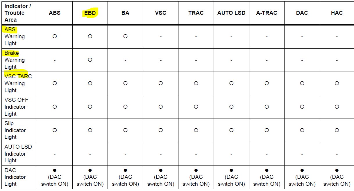

    Tacomas do not have a center differential lock switch. You'll need an OBDII scanner capable of reading ABS codes to see what the error codes are, I'm going to guess a speed sensor/wire is bad as that's common to all 3 functions of ABS, VSC, and EBD.
    The EBD control utilizes ABS, realizing proper brake force distribution between the front and rear wheels in accordance with the driving conditions. In addition, when braking while cornering, it also controls the brake forces of the right and left wheels, helping to control the vehicle behavior
