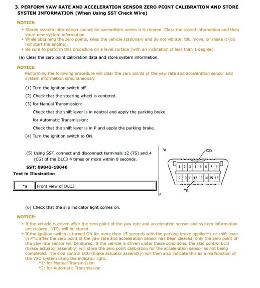

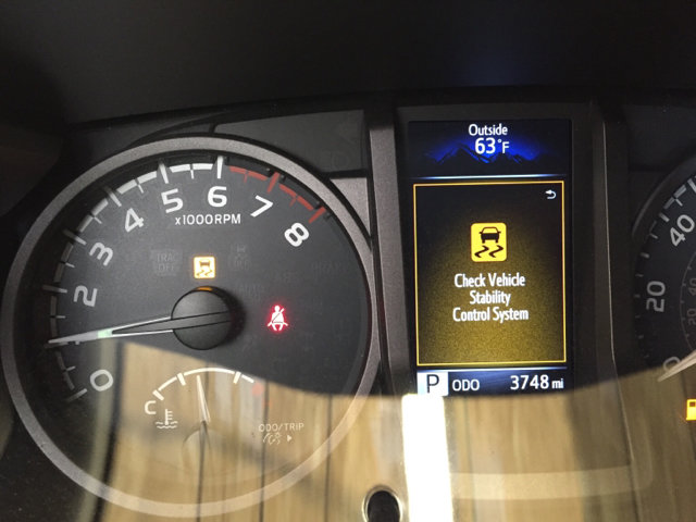

    Installed a 2" lift (ome 887 coils) and when I drove around the block I heard a grinding noise when over few bumps/hard turn and the vehicle stabability control light came on and won't go off. Saw one other thread on here saying it should be recalibrated. Anyone else with this issue and if the recalibration resolved it? Thanks

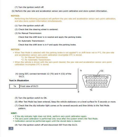

    So I have to do both of these steps to clear it ?
  5. May 15, 2016 at 6:31 PM
    splitbolt
    splitbolt Voodoo Witch Doctor
    Mar 7, 2010
    #32761
    7,858
    NW Arkansas
    2016 TRD OFFROAD DCSB MGM
    Yes.
  6. May 16, 2016 at 3:40 PM
    bawalkerr
    bawalkerr [OP] Active Member
    Jan 5, 2016
    #174063
    42
    Brittany
    2016 White TRD Sport DCSB
    Fixed it! Thanks bud

    Throwing this to the top. I had to use a code scanner to "clear codes" on my truck even after doing the VSC reset procedure. It was weird because no codes showed up on my scanner, but it gave me the option to clear codes anyway.

    I did the VSC reset procedure by myself a couple times last night. It's super easy. Just didn't clear until I did the above with my scanner. It was weird.

    It was probably the ABS kicking in on one wheel because it was confused about the lift with no VCS reset. It's a non issue, just have your dealer reset the computer after your lift if you get the error message.

    Yes, there are other threads, I've read them all the last week or so as I chased this GHOST. But the tech instructions you posted are easy read & understand, which allowed me to successfully Re calibrate & Reset my VSC, TRAC, ABS system on my truck. After installing the same lift kit, I have been fighting this issue for weeks! Every thread I read, used incorrect number system to find the 2 pins on OBD plug.
    I followed the instructions you posted, and the GHOST is gone. My truck is actually safe to drive. It handles almost exactly like it did with OEM tires & lift. THANK YOU for the help!!!

    I used a piece of 22ga wire and stripped the ends off to make a jumper wire. Worked great. No problems since either.

    So the idea is to short those two connections 4 and 12?
  18. Jul 15, 2019 at 10:26 AM
    #18
    tcjacado
    tcjacado Well-Known Member
    Aug 29, 2016
    #195947
    41,586
    Yes. Jump those 2 pins, you can use a paper clip also.

    This sounds crazy lol I presume rest of those instructions must be followed with the ignition sequence on and touching 12 and 4 with paper clip 4 times within 8 seconds while car is on leveled serface with steering centered. What is the step two ? I don’t have obd2 just trying to find out if I can have this done while on the road and not make it worse.
