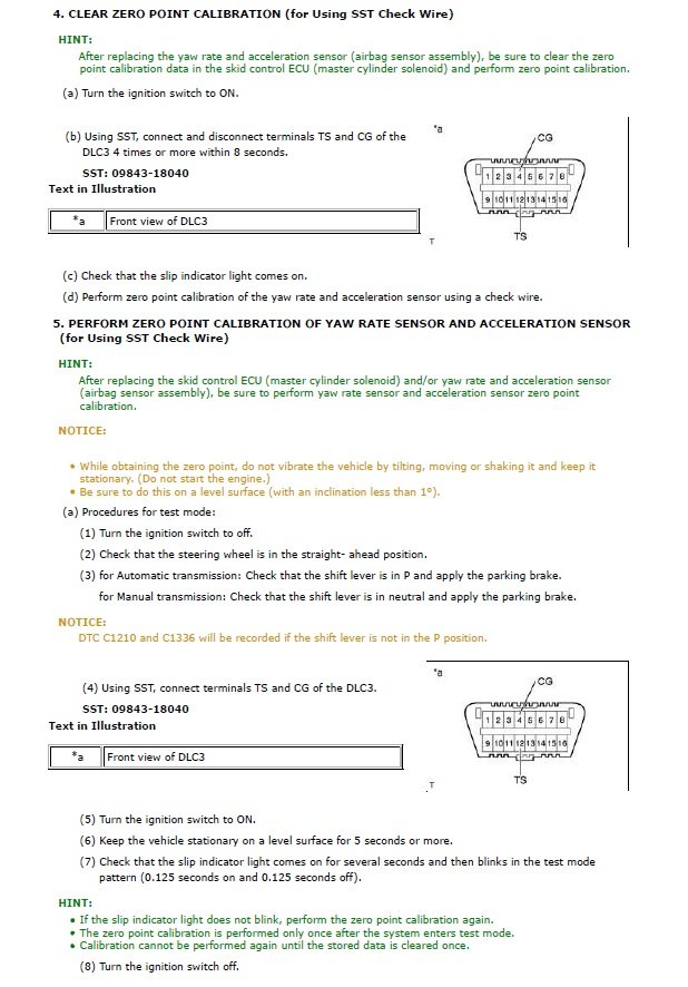

    Hi all,
    After getting my Tacoma lifted + an alignment done, my VSC light comes on with an error, and when I try to use my cruise control (even just the standard cruise control, not even the adaptive), it also errors out. Should I try to do the VSC reset on the OBD connector, or do you think that the shop damaged a wheel speed sensor while working on it?
    Thank you!

    I see. Is the process/pins different for resetting the zero point for the VSC on later model 3rd gens, or will existing guides work?

    My info just shows using the Techstream. Perhaps another user knows if you can use a jumper wire.

    You need to re-calibrate the VSC system. I know for the 2nd gen you can do it with a paper clip un the obd2 port (i do it with a switch/wire for safety). You need a level surface, working parking brake (need to be applied for the calibration). It's like a 2 minute job.
    It's in the FSM for the 2016 Tacoma so i think it's the same procedure as the 2nd gen

    No go on shorting pins, there's not even a wire in one of them. Any ideas? OBD scanner maybe?
