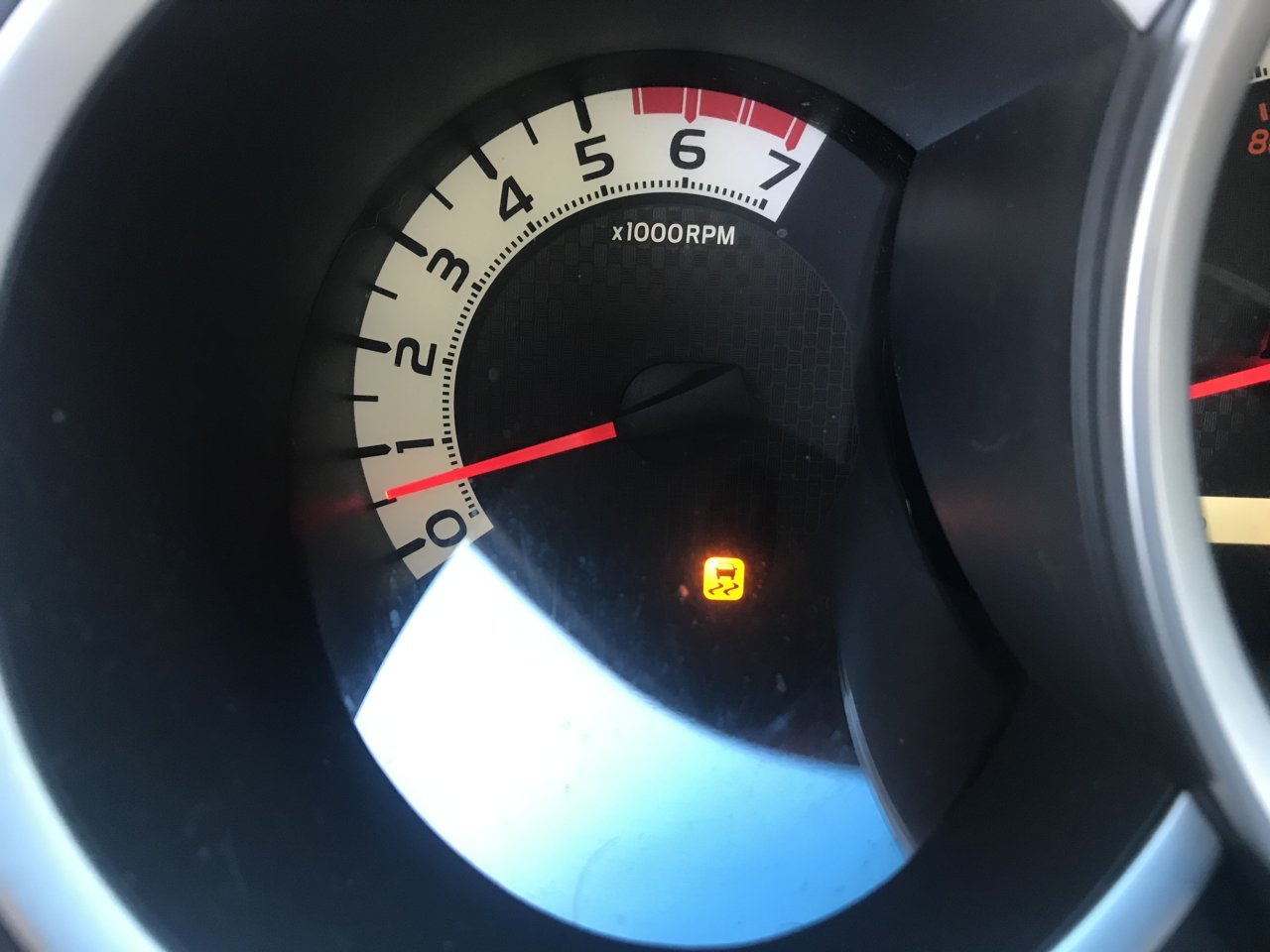

    Got a new issue that I could use some help troubleshooting. I had an alignment appointment this afternoon to get my SPC UCAs dialed in so there's enough room for mud flaps at the back of the wheel well after I get bigger tires. Per SPC's instructions, the LCA caster cam was (nearly) maxed out and the UCA ball joint was rotated until caster was back within spec:
    https://www.spcalignment.com/partFAQ/25470_FAQ.pdf
    The alignment tech told me that the VSC light illuminated steady on once everything was dialed in. Fearing the worst, I took some sharp turns at speed on my way home to see if the dreaded VSC issue would rear its ugly head. If you're not familiar, it is discussed in depth here:
    https://www.tacomaworld.com/threads/lift-with-vsc-answer.41215/
    VSC didn't appear to activate, since my tires didn't seem to lock up at all when taking these turns. So if that isn't the issue, then what is going on?

    10 bucks says alignment "tech" broke an abs wire.
    I could just see a tech not familiar with the SPC ball joints loosening that top nut all the way then out slides everything either crushing the abs wire or pulling and tearing it. Check abs wires and front brake lines.

    If you haven’t already, also give this a quick try... press and hold your traction control off button for like 5 seconds (or until it turns off), wait a few moments, then press it again to turn it back on. See if the VSC light goes away.
  10. Oct 14, 2020 at 4:05 PM
    nd4spdbh
    nd4spdbh Well-Known Member
    Oct 7, 2013
    #114055
    14,519
    SoCal
    13 DCSB TRD OR v6 Auto
    easy enough to poke your head in there and double check for broken wires. But really the shop should be looking. Problem is ABS codes are not a standard code so unless you have a good reader you wont be able to pull it.
    Go out to a dirt road and see if your abs works... im betting it doesnt because one wheel isnt reporting back.
    The ONLY other thing that could of happened was alignment tech did the alignment and steering wheel was significantly off centered and he drove it for quite a bit. At that point a zero point calibration would need to be done once the steering wheel is centered.

    I’ve seen the VSC light come on after fucking up an alignment bad on the trail. Once from a bent spindle and one from knocking the giant nut on the SPC loose and the camber was all sorts of fucked.
    My initial reaction was the same as @nd4spdbh, I guaranteed it was a fucked wire. But then learned abs isn’t on and speedo is working, so it couldn’t be that.
    A zero point is free, quick and easy and will probably solve it.

    Doing an alignment absolutely will. The service manual includes specific instructions to always do a zero point calibration after any alignment.

    Sure the truck should have the steering wheel centered after it is aligned but that doesn't mean it showed up that way. Sometimes alignments are knocked off or in the OP's case out of whack after suspension changes. The truck absolutely knows if there's been a change in the steering wheel position to drive in a straight line as it stores previous values to compare with the current value. This throws a code and is one reason why a zero point reset should be done after any alignment and before troubleshooting other items.
    Also OP should pull his trouble codes to help verify any diagnosis.

    Update: I just did the VSC recalibration linked by @ShimStack and @ryfox0276. Super simple, took 2 paper clips and less than 5 minutes. The VSC light is no longer illuminated, and did not kick on when I took my truck for a spin around the block. I'll report back if this fix doesn't last.
