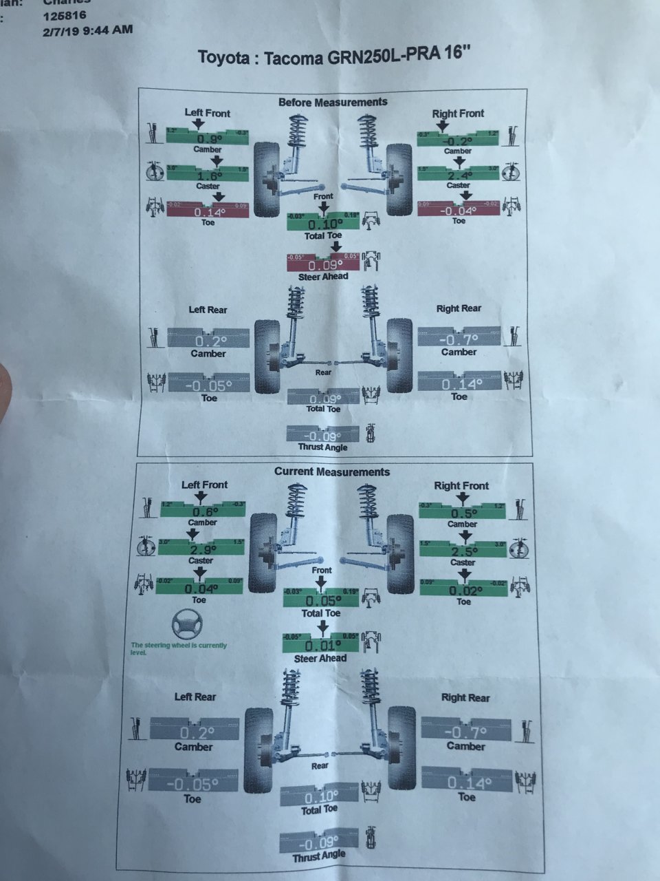

  19. Feb 7, 2019 at 10:12 AM
    #59
    Barhopper
    Barhopper [OP] Well-Known Member
    Jan 17, 2019
    #279656
    192
    Dustin
    Nw Georgia
    2010 Tacoma Sr5 Double Cab Long Bed
    King coil overs 2.5 with #650 springs, Spc UCA, OME Dakar standard leaf pack, extended Bilstein 5100, Pelfreybilt aluminum front and Pelfreybilt steel rear bumper.
    5F1D0D83-F90F-4855-9C53-D3F8803A6073.jpg Ok so here is the alignment specs after I had the tires put on (the top alignment).
    The bottom alignment is after I went back this morning. See any difference???
    Now the truck pulls so hard to the right and shop tells me that they have done all they can.
    They did however get the vsc to reset but didn’t get to really try it out because of the pulling issue and tires not being able to get balanced.
    I did argue with them till they agreed to put a new set of tires on it tomorrow.
    Who would have ever thought putting a set of tires and an alignment would cause this many issues.
  20. Feb 7, 2019 at 10:17 AM
    #60
    steveo27
    steveo27 Ask me about my weiner
    Aug 12, 2013
    #110326
    6,055
    Steve
    Pittsburgh
    '11 TRD Off Road & 1992 VW GLI
    The same shit everyone else has.
    Camber should definitely not be positive and caster could definitely go up a little bit.
