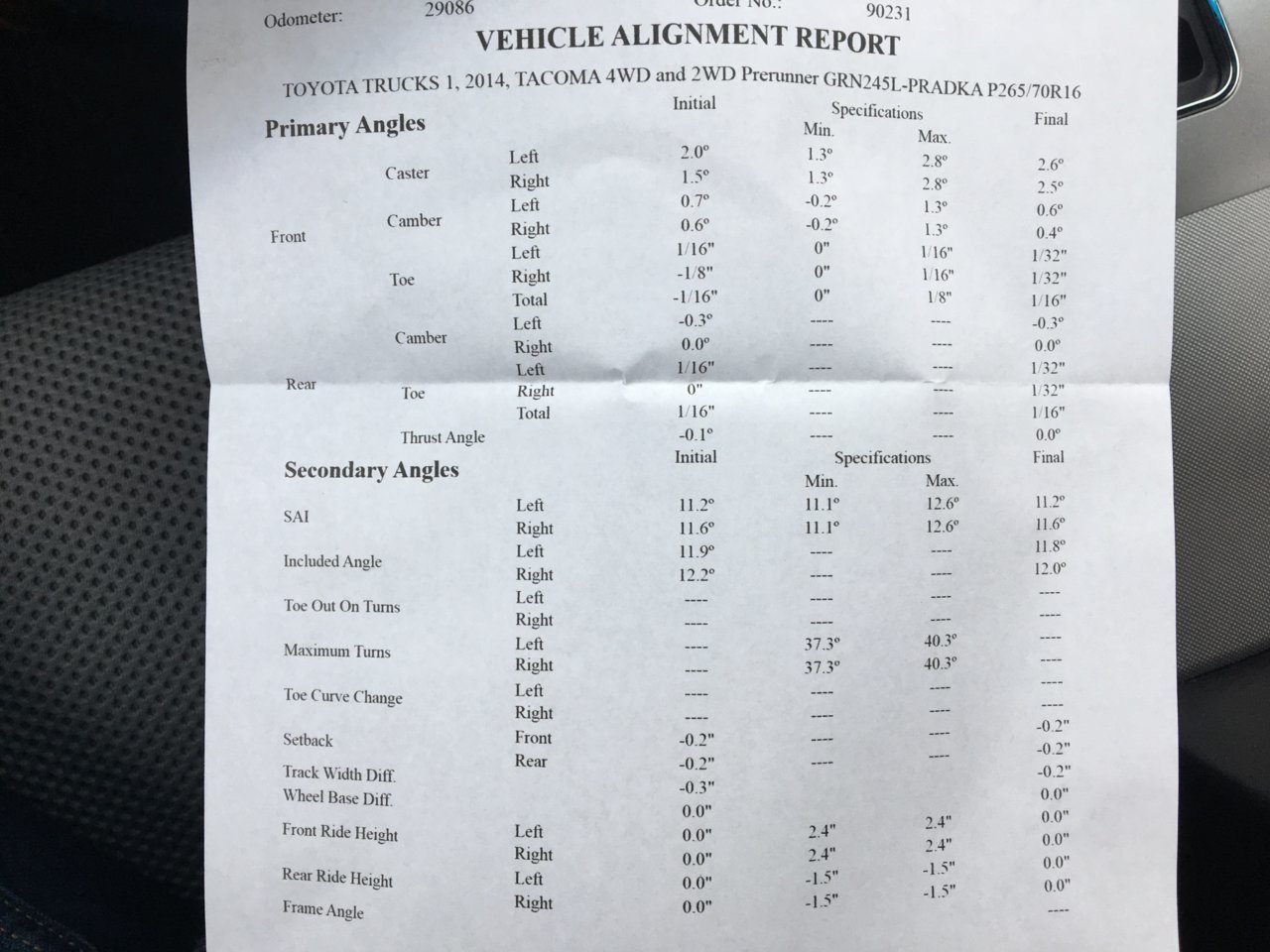

    Post up the current alignment specs.
    Also, you DO want some cross caster to account for the crown in the road.

    Another funny thing. I asked today for a new alignment sheet from the 3rd alignment and they said they didn’t have it cause they deleted it before printing. Said he just measured my tire to the fender and he moved it a half and inch. I bout flipped but I’ve alre invested 3 days of truck up there and a half day off work and figured I’d just go another route. They only charged me for nitrogen in the tires and I was gone
    And correction from my last post. I told the guy where they had my caster set and that’s what he said as well about cross caster just not that much.
    My caster was 2.9 on drivers side and 2.5 on passenger side on second alignment before dude moved it and I quote “1/2 inch back”
