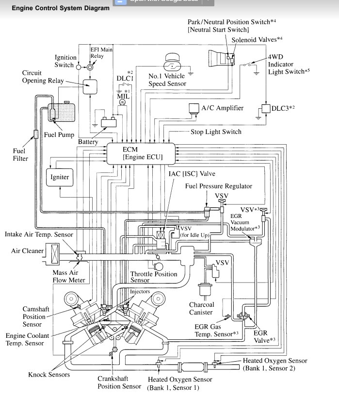

    If you still need diagrams, check my sig for the zip file

    Right click, save.
    That's a good visual to have on hand for quick peeks when you don't need the full manual:cool:

    :thumbsup: That whole PDF I pulled that from is insanely helpful. I think it came from an MR2 forum (they do 3/5VZ swaps). Those guys and the Supra guys have been very helpful lately.
