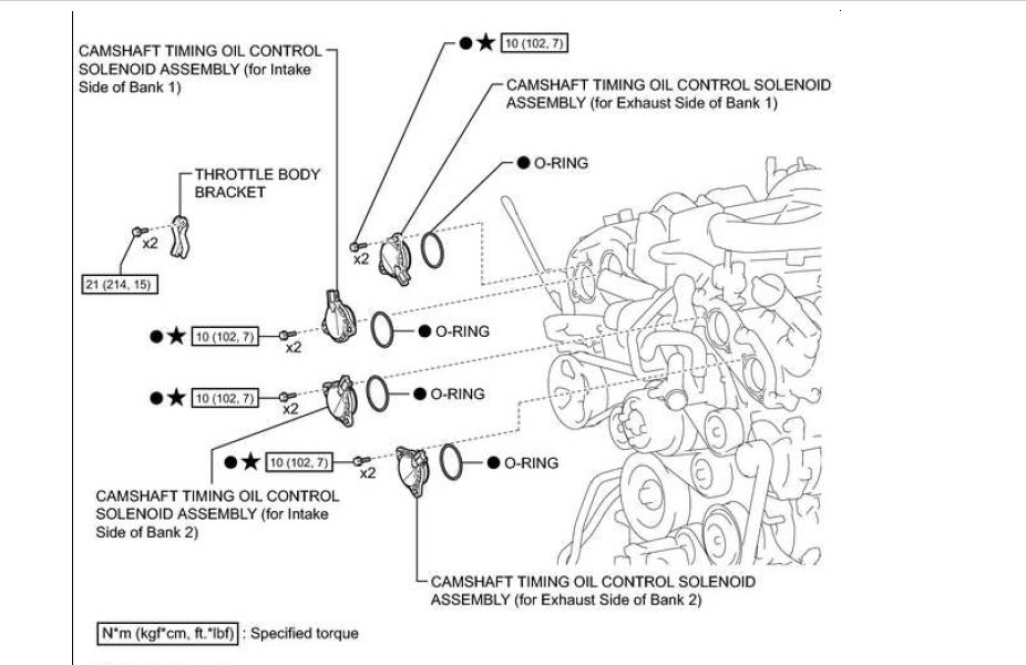

    Vvt solenoid location on a 2016 3.5 i can't find it anywhere please help

    I’m likely wrong but pretty sure that there is not a vvti solenoid due to the engine being an Atkinson cycle.
