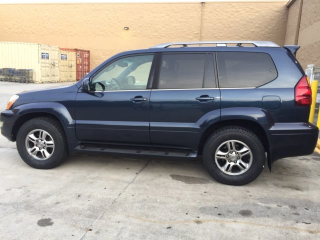

    Hey everybody. Been looking for a GX470 for awhile now and finally found a one owner with all records 2005 Lexus GX470 sport in Florida with no rust.
    Used to own a 2006 Tacoma double cab sport. Sold that for a v8 4Runner but couldn’t stand my head hitting the roof with the sunroof option. Quickly sold that and finally found what I really wanted which was this GX470.
    Looking forward to modding it.
    Stay tuned.

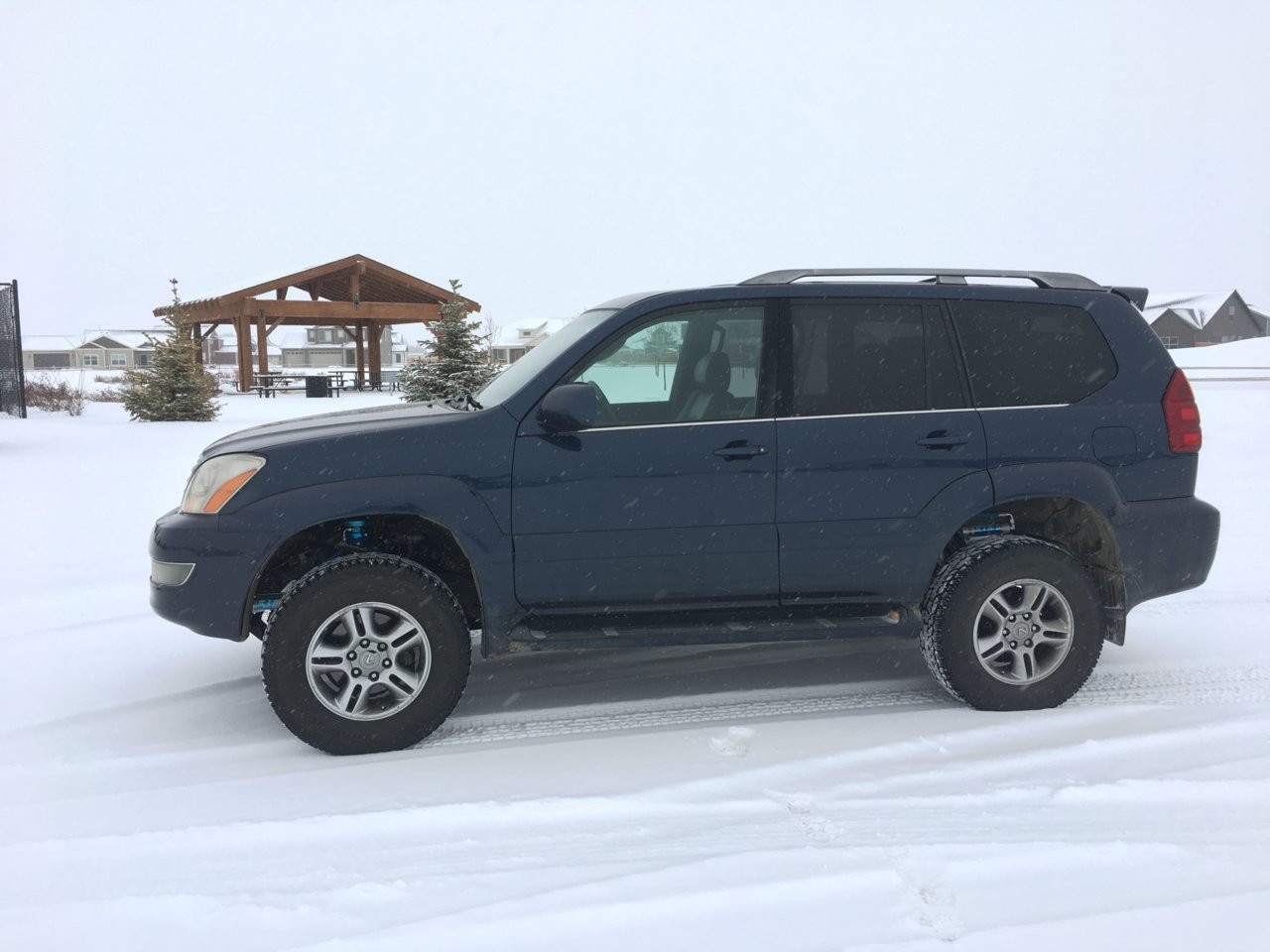

    The tires needed to be replaced so I replaced them with Cooper ATW 265/70r17. I am impressed with there performance in the snow and ice.

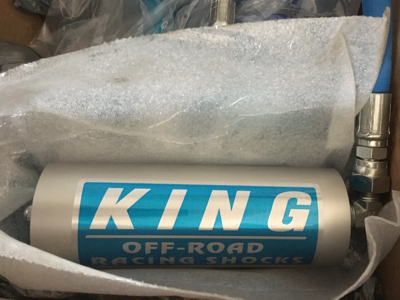

    Ordered some King’s remote resi front and rear.
    Fronts are going to be extended travel 700lbs spring rate for a 2010-newer 4Runner with KDSS. The resi brackets and longer resi hose should be the best solution for mounting on the GX470 with KDSS. I will reply back with how they work out.

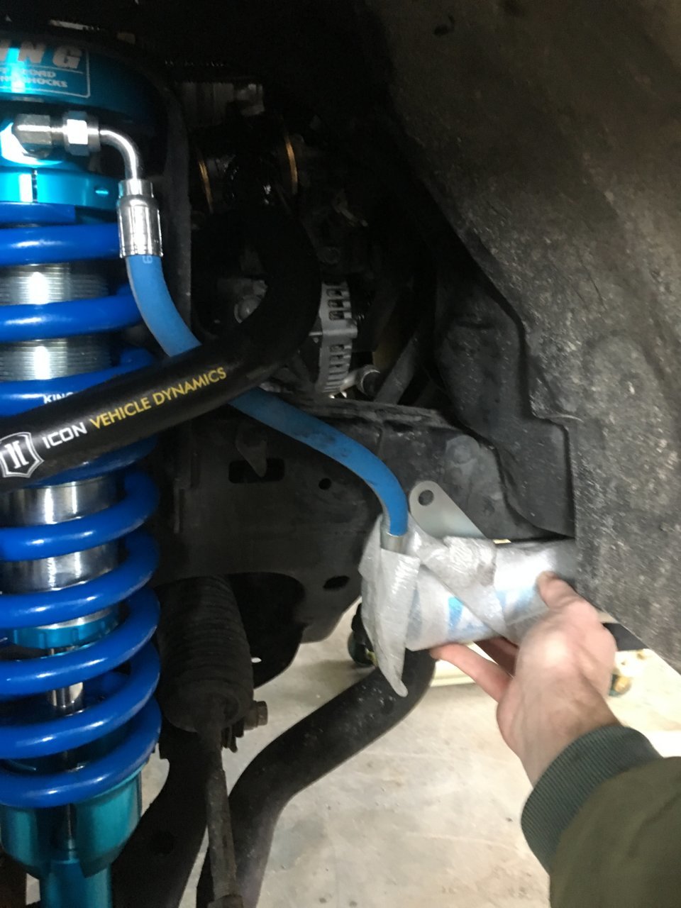

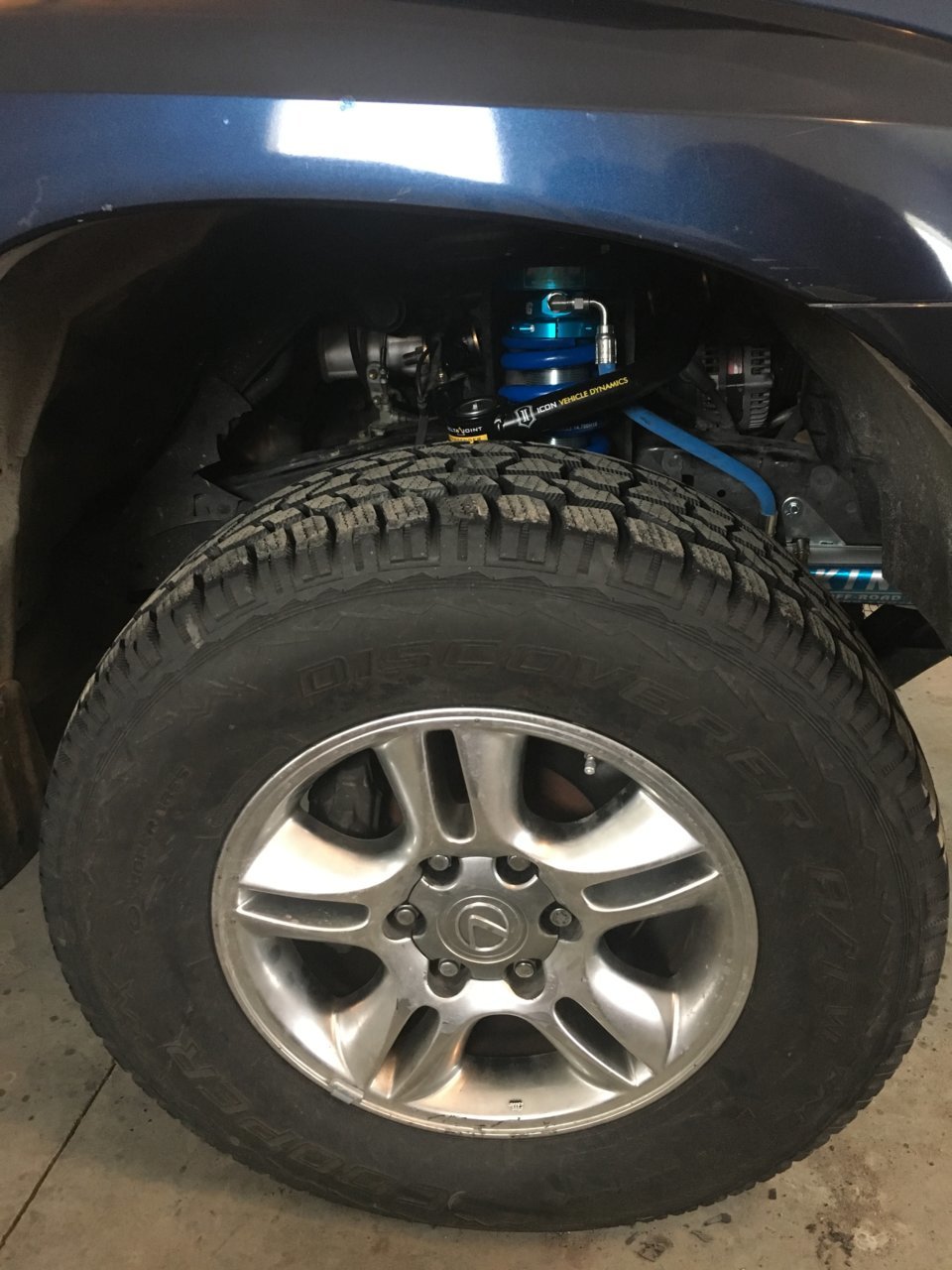

    Well, got the kings and icon delta joints on. The mounts for a 2010-newer 4runner Fit perfect with a self tapping screw. Before and after. Also working in a garage with no overhead lights truly sucks!
    Gunshot-6A and Biscuits like this.

    The jack that I borrowed was just a little short and I didn’t have any blocks of wood laying around so I had to improvise. I wasn’t supporting the vehicle just compressing the piston of the KDSS sway bar.

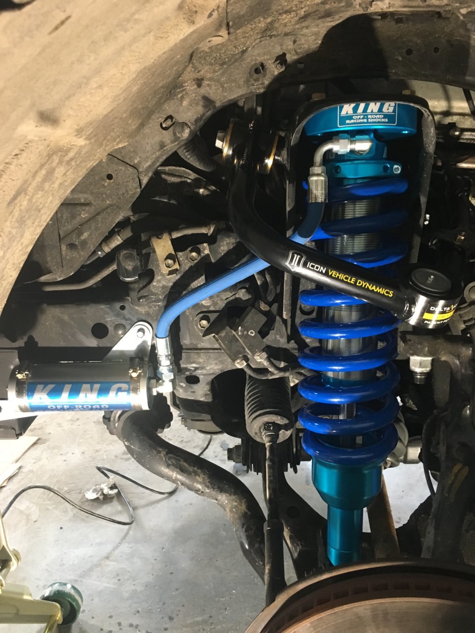

    Figured out how the resi mount mounts to the frame. Will need to drill the frame on one spot each side. Any tips? Do I just drill a hole and use a self tapping bolt? @Gramps @TMFF @Squeaky Penguin @Night Eagle

    If you have self tappers it would work fine. I used a netcert in mine were the swaybar would bolt up to the bottom of the frame.
    It looks like it also bolts to the front crossmember so it's not a large load on the self tapper screw.

    Cool, I just bought some self tapers. It has a big bolt that goes into the front crossmember

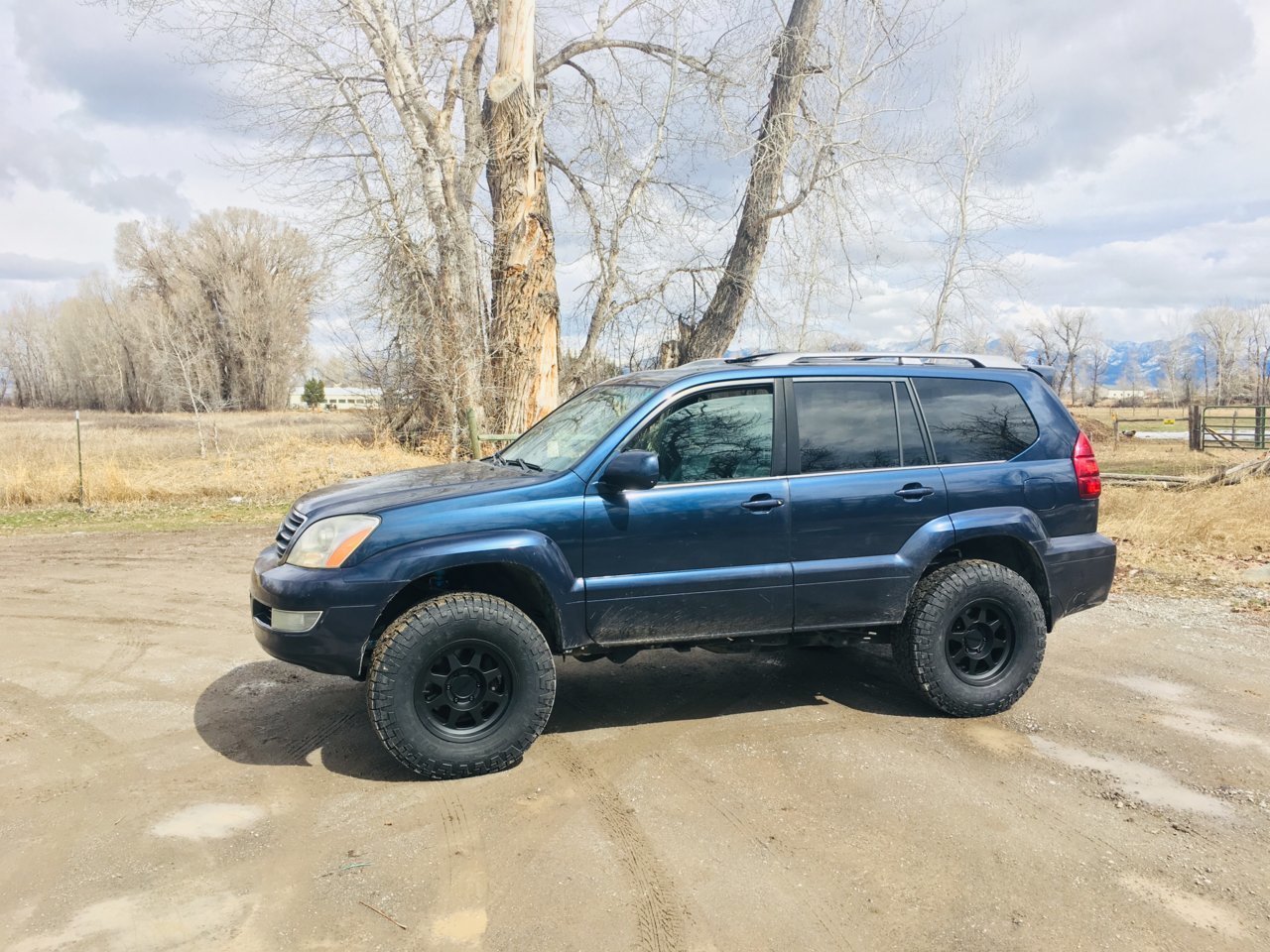

    Finally finished the front suspension. Sittting at 4” lift over the stock suspension. Guess I need to hurry up and get some armor to make it sit lower. Went with the 700 spring rate knowing I would be getting skids and a bumper eventually.
