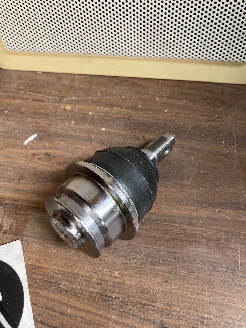

    Finally getting around to rebuilding the front end.
    -Replacing the wheel bearings (thanks @05Taco4x4 for the hubs)
    -replacing the LBJ’s with Sankei 555
    -installing white line lower bushings
    Got everything removed on one side and rebuilt both LCA’s

    Where did you source the press in LBJ's? Just curious. Will check in over time to see if they are worth it over OEM...
    *edit: to see if it's worth if over all new OEM LCA's.

    Bought them from carid for $63 shipped for both.
    Sankei 555 SB3842 they held up great on my Tacoma

    Just curious to see how they hold up. Also have a press an all the fixings, just wondering how the ball joints hold up over time.

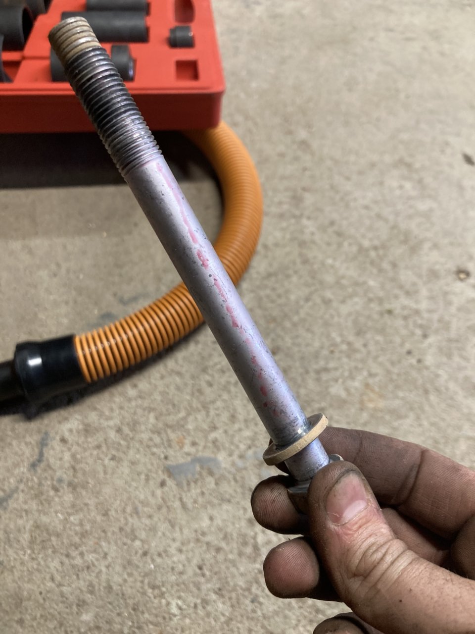

    Got super lucky with the LCA cam bolts, weren’t seized at all. Will definitely be putting anti seize when I re install them

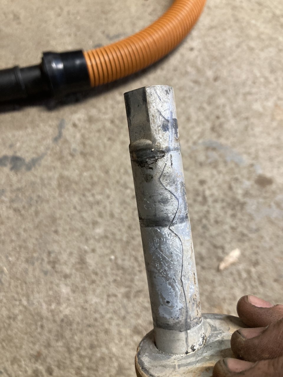

    Finally had time to work on the GX. When I had everything apart I found out the inner tie rods are bad so I will have to replace those before I get an alignment.
    Having fun with CV axles. Can you guess the good one?
