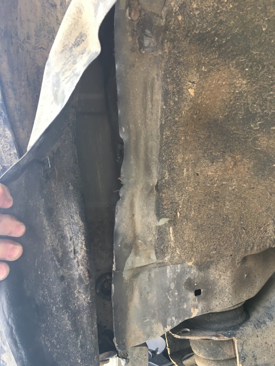

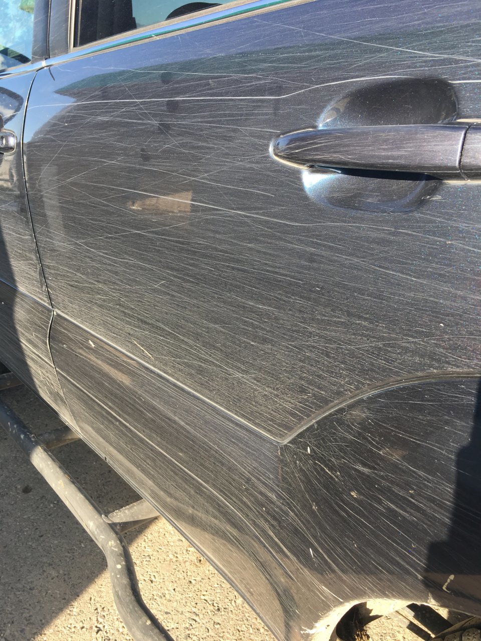

    Hammered down the pinch seams. Need to work on my heat gun skills.

    I put a 6mm rivnut in that square hole and used a bolt with large washer to help hold the liner back. Worked on GX and 5th Gen.

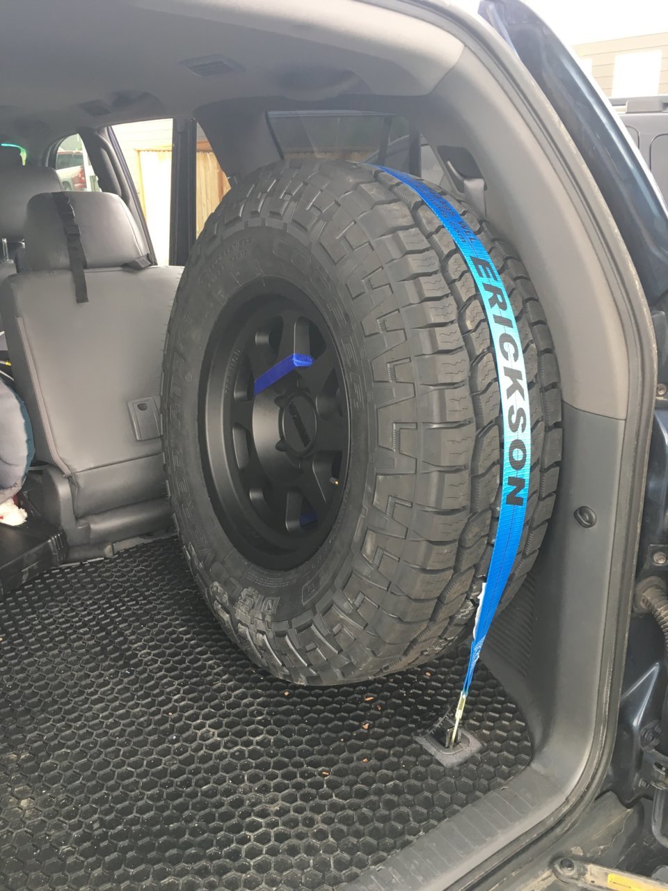

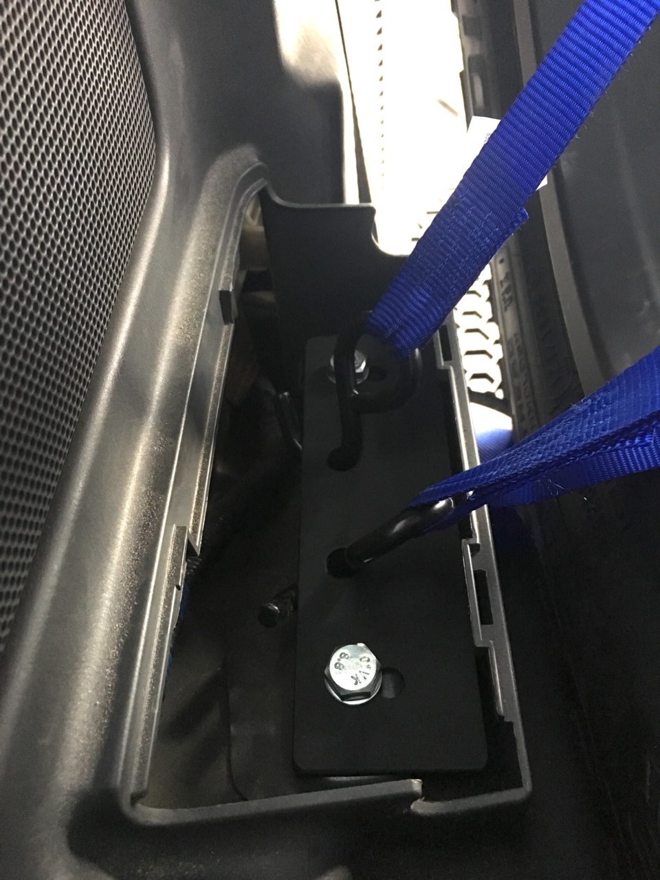

    Jerry rigged a spare tire tie down system. Wife said there is no reason why the spare should be inside the cab. Guess I am getting a rear bumper come tax return time!

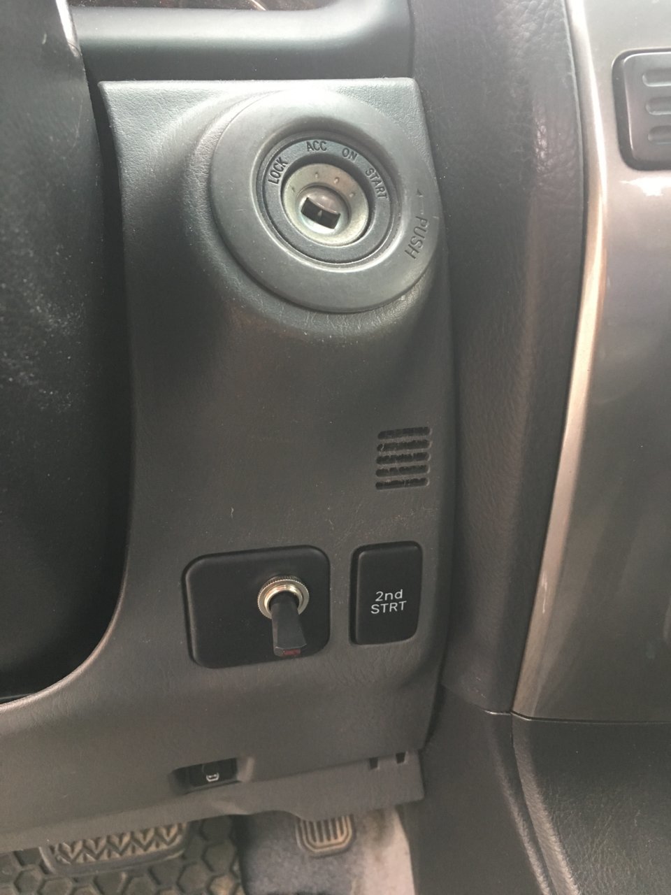

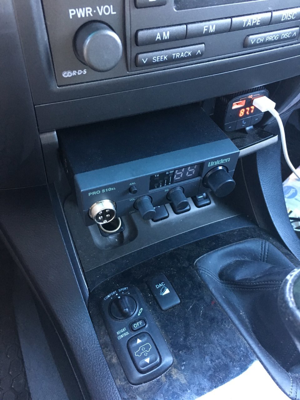

    Installed a CB radio in the coin tray spot. Had to cut a little bit of plastic for it to fit but you can still install the coin tray back if needed. Radio sticks out farther than I would like but it isn’t in the way of anything.

    Too big to fit under the rear I take it? I’m running 285/75’s on my GX as well and am about to get the spare this weekend. I’ll have to do something like this too if it doesn’t fit underneath.
  16. Aug 15, 2019 at 7:41 AM
    #156
    w.adventures
    w.adventures [OP] Adventure is out there
    Nov 28, 2013
    #117482
    11,023
    Nowheresville, SC
    2005 Lexus GX470 Family Hauler
    Not sure about a non KDSS gx. No way to fit it with the KDSS swaybar.
  17. Aug 15, 2019 at 8:03 AM
    #157
    Katchaser00
    Katchaser00 Well-Known Member
    Jun 16, 2016
    #189782
    2,353
    Luke
    10,000 lakes
    Non-KDSS over here. I'll have to try and squeeze it in. :fingerscrossed:

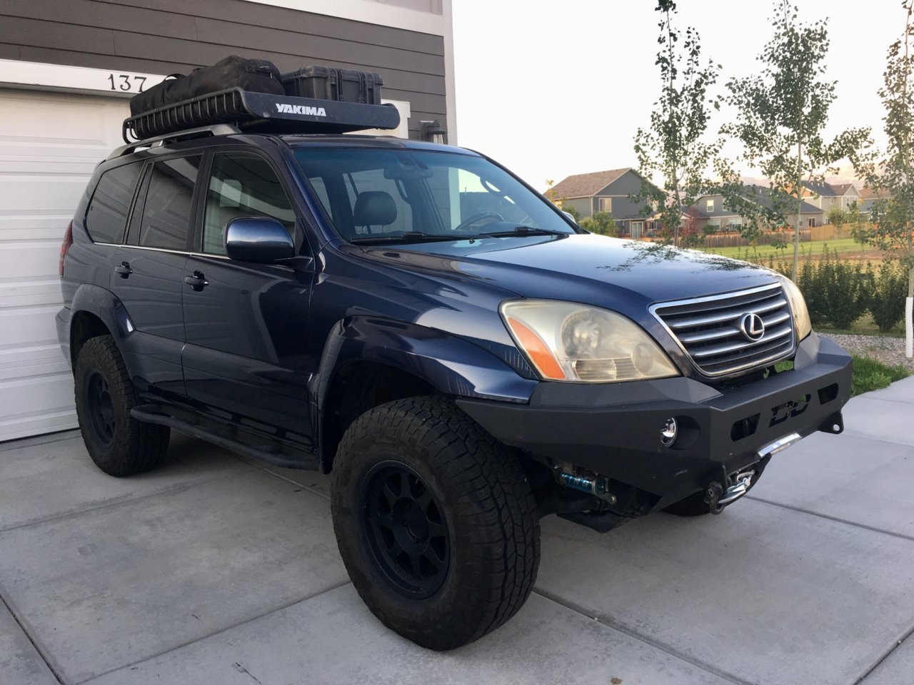

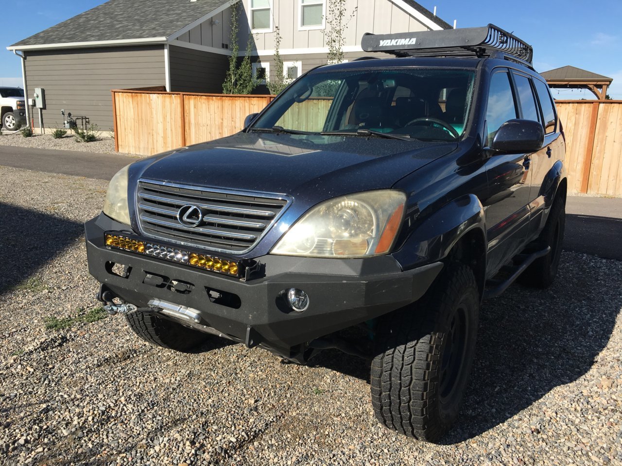

    Installed a Baja designs Onx6+ 30” light bar from @state48overland . Looks great on the bumper. This light bar is BRIGHT! If anybody is interested in a bumper for their GX I highly recommend @demello bumpers. They even have a new bumper out now with a cutout for a 30” light bar.
