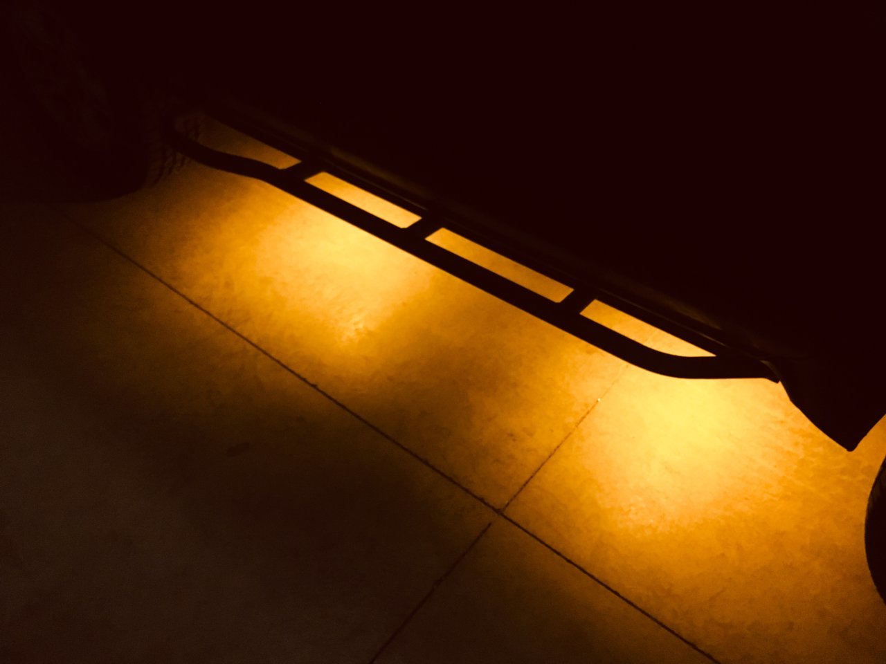

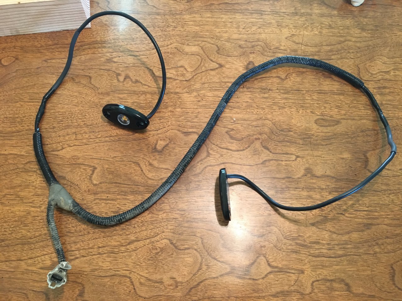

    Added amber rock lights. I spliced them into the factory running board light harness so they turn on when the doors are opened and when I unlock the vehicle.

    What lights u get?

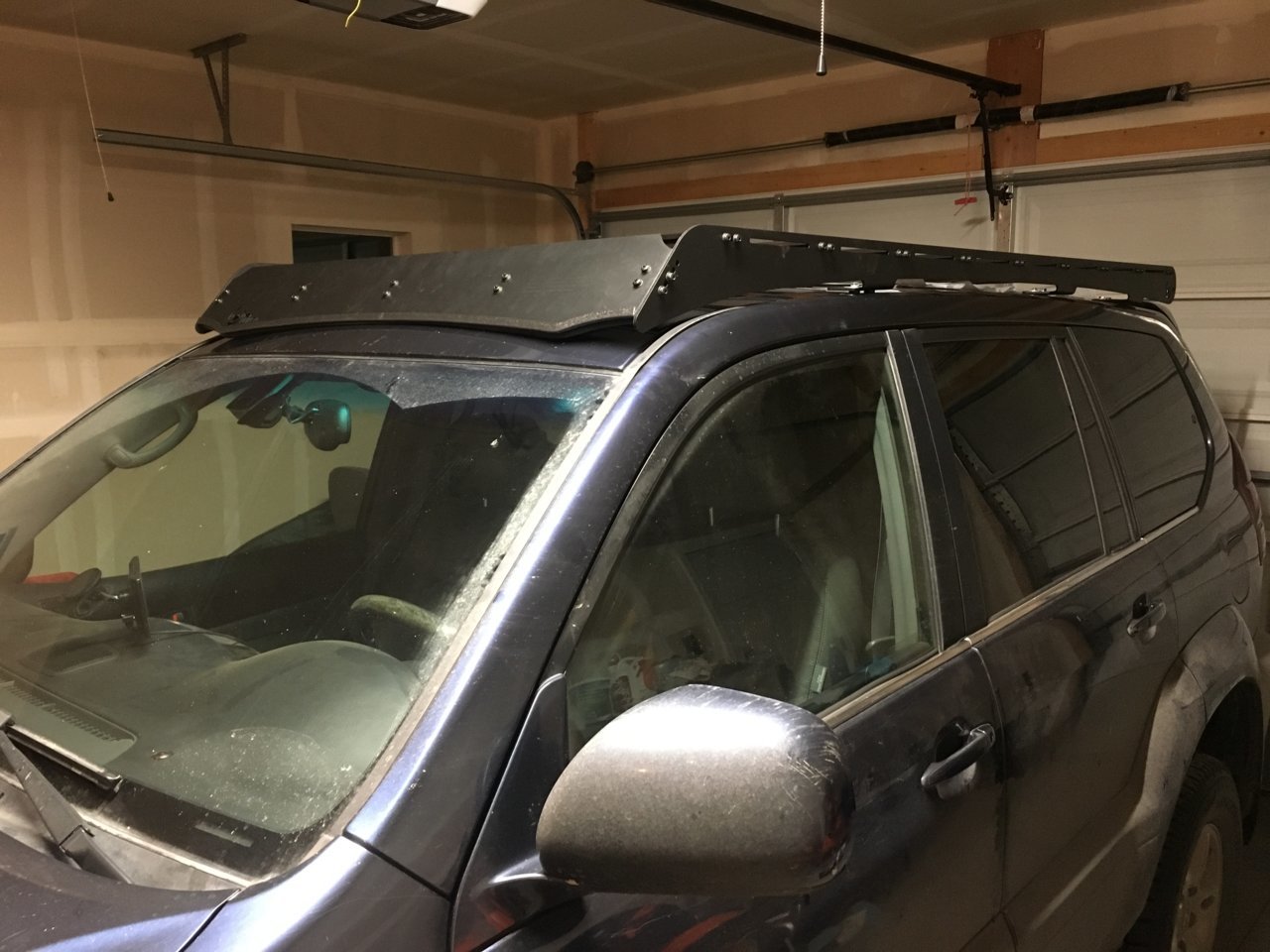

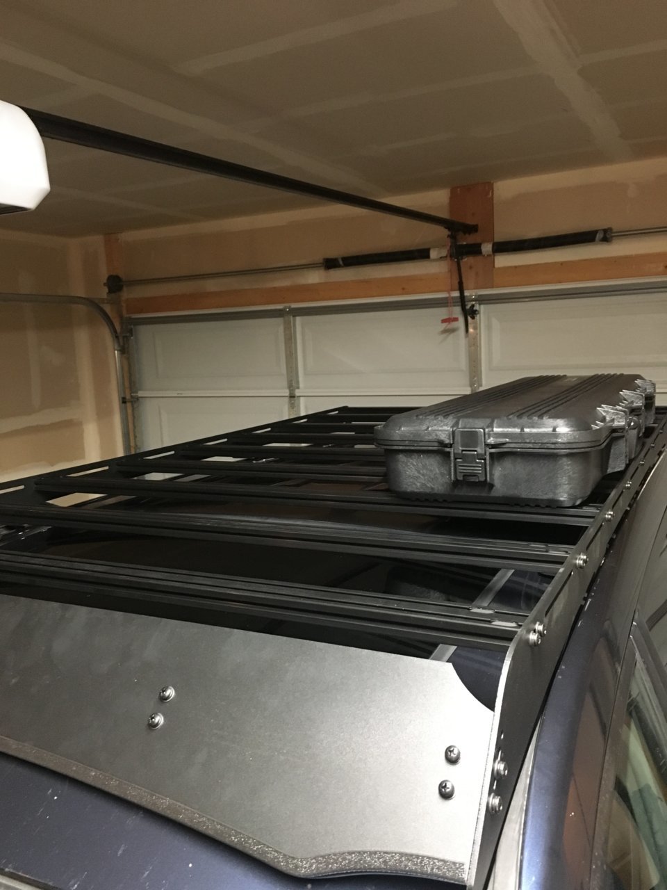

    Installed a prinsu rack. Going to add a Plano case with all of my recovery gear. Have to make room inside the cabin for baby #2. I also want to mount some flood lights to it, haven’t decided which ones yet.

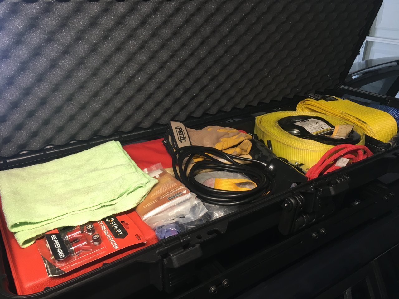

    Installed a Plano 42” case I had already. Loaded it with all of my recovery gear.

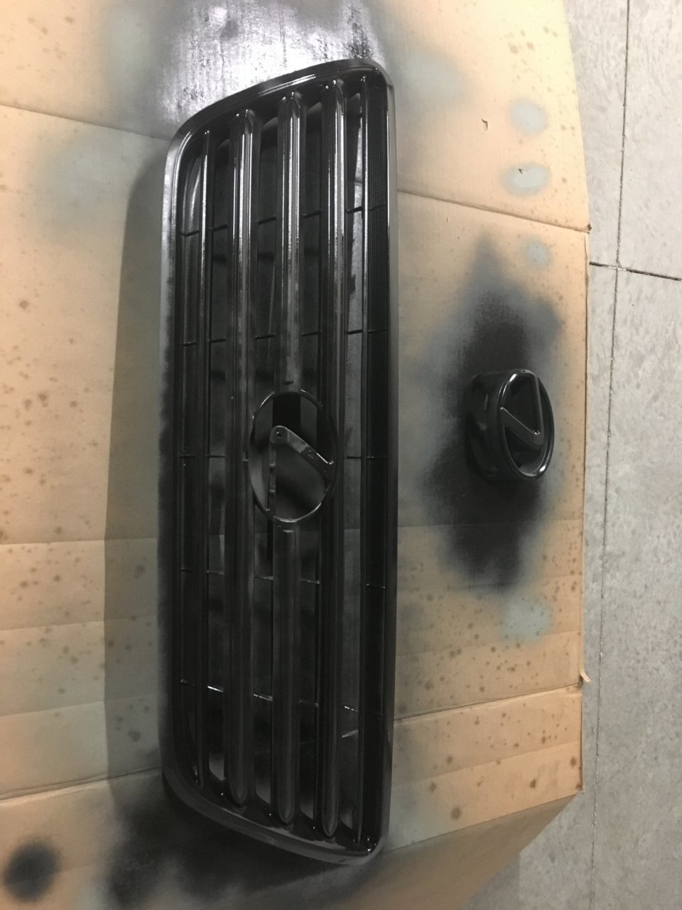

    Working on getting rid of the chrome. Window trim will be here next week, went with the cheap eBay Chinese trim.

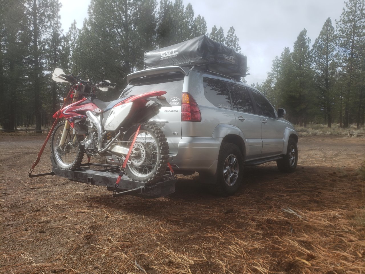

    I was hoping to keep the bags because I have a variety of loads and like the option to be level (a.k.a. not dragging the ass end). Biggest load is the RTT and motorcycle carrier that cantilevers weight way out back. The carrier rides danger close to the ground without the self leveling option...

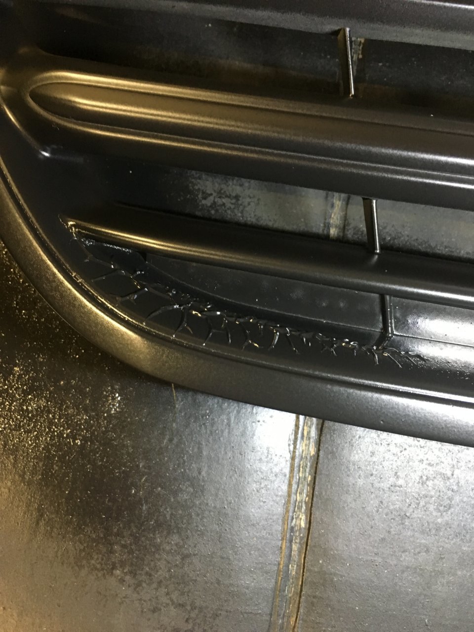

    Waited 48hrs to apply the clear coat but since the first 10hrs were in a 50 degree garage the paint didn’t set enough. Screwed that one up!

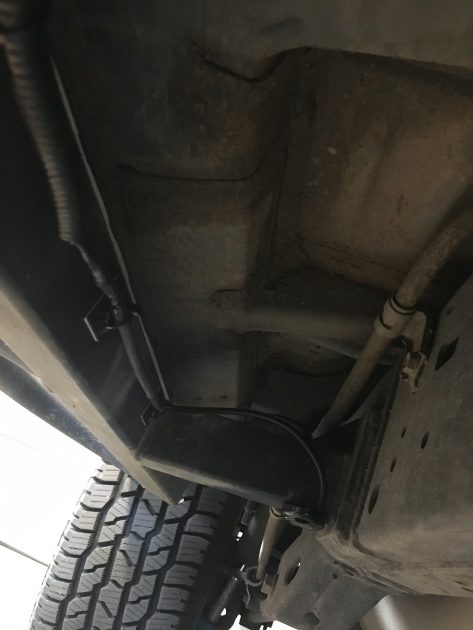

    I had the firestone in the coil bags connected to the stock compressor and air ride system. If you cut the ends off the stock line off, heat it, the .25 air line will slide in inside and seal great. But trying to calibrate the system when running 2"+ rear springs is hard to do. I was able to make it work great with the eibach 1" lift springs but not reliably with taller springs. I ended up taking the compressor out and installing a schrader to fill my self.
