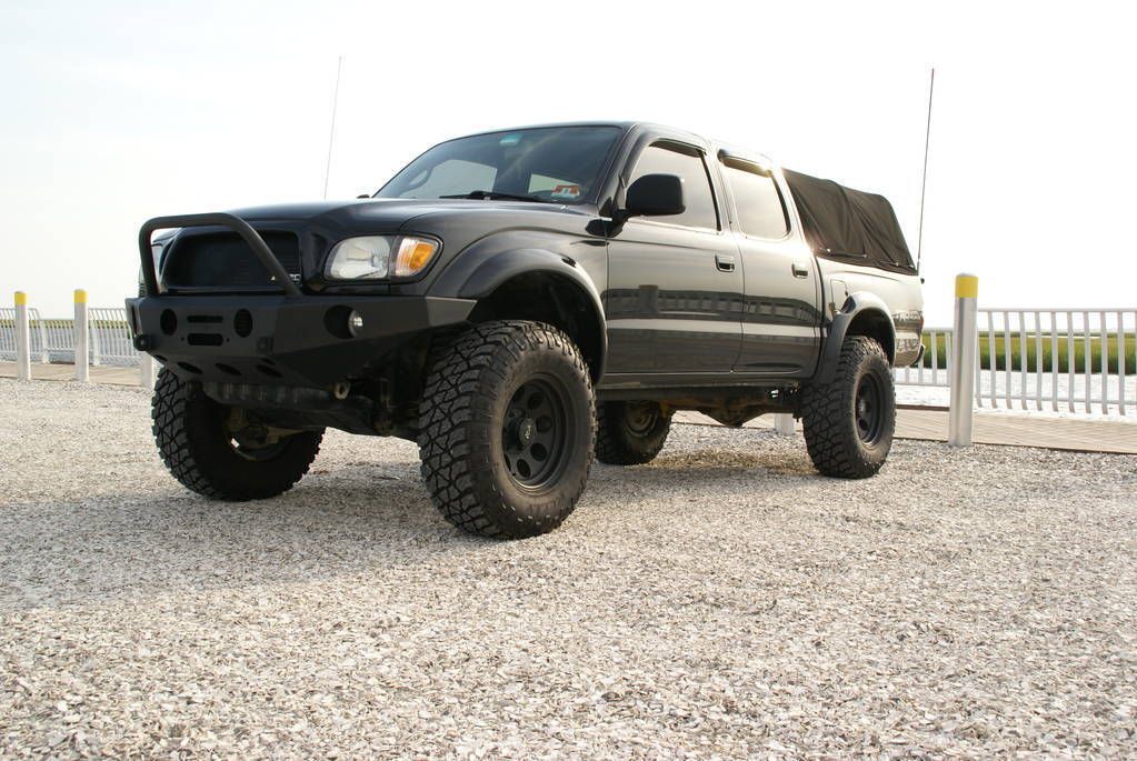

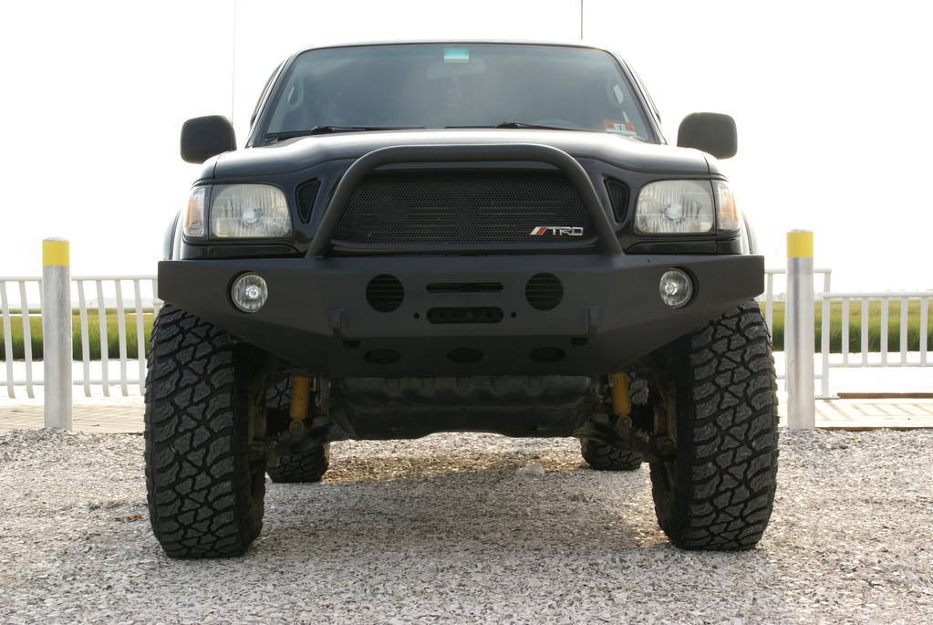

    My favorite fishing/crabbing spot finally opened back up since it was destroyed after Hurricane Sandy last October. So I took a few pictures.

    she's looking good now-a-days :D
