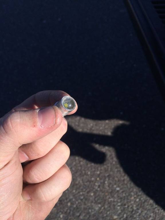

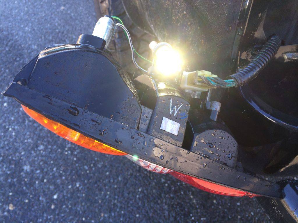

    Installed some LED reverse lights today.

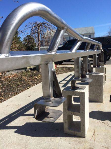

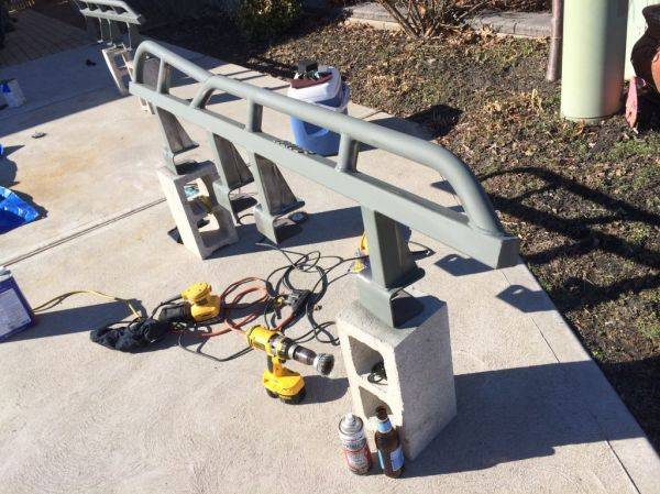

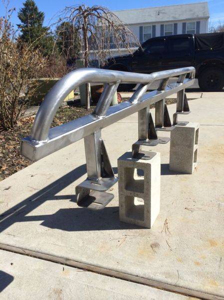

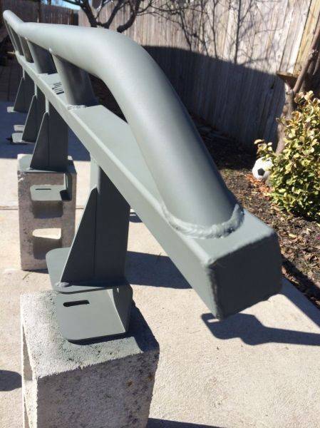

    Thanks Tyler! I followed your thread as a guide. I also used the same Rust-oleum you used.

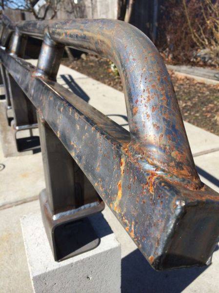

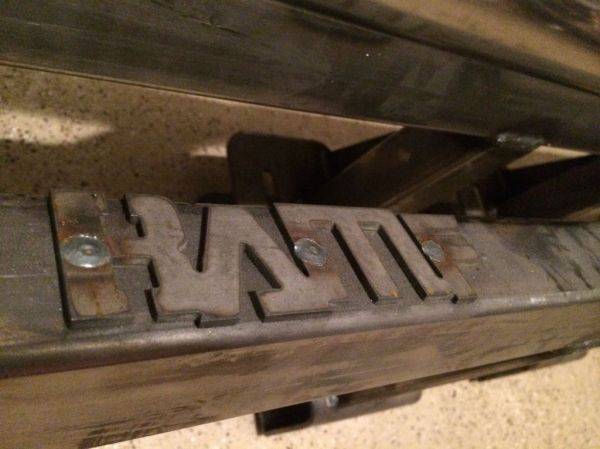

    Picked up my BAMF sliders from ConWay on Friday night. I started on Saturday morning prepping them for paint. I used a variety of wire wheels, a palm sander with 150 grit and brillo pads.
    I found the wire wheels work the best.
    It took me about 4 hours total to get them ready. Once I was done, I wiped them down with some denatured alcohol.
    I used some self etching primer on them next. This is what I used.
    Using the February sun to speed up the process.

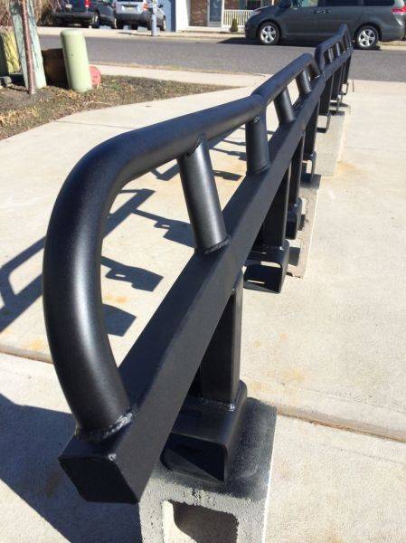

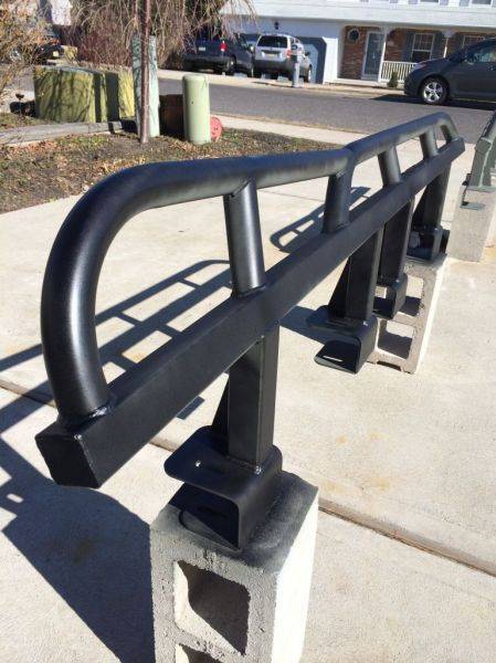

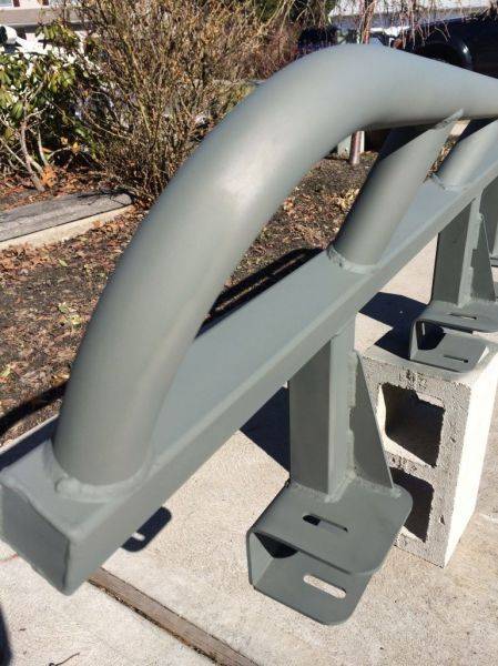

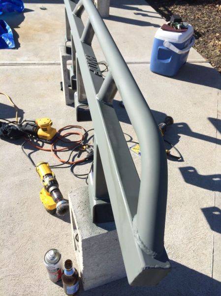

    I used this for the top coat. I saw another member used it on his sliders and I like the results he had.

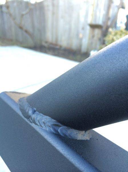

    1st coat
    2nd coat
    Close up
    I used 5 cans in total. I probably went overboard with the final coat, but its only $6 a can.
    I plan on installing them next weekend.

    WOW man! Great needed prep

    Oh i know surface rust comes quick. I was meaning how you got it to bling. Most dont do that lol

    Slidas look great man, sooo jealous
    Eddy, I gotta say your fab work looks amazing! Keep up the great work!

    So $30 in spray paint and maybe 5 hours of labor? What does jerry charge for powdercoat?

    I didn't even inquire about powdercoating. But I would assume the shipping would go up.
    The shipping cost doubled and then some when I added the bolt on leg option. I couldn't imagine what the cost would be if I added PC.
