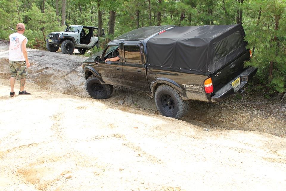

    Kev said you had your truck apart just to change a zerk fitting. Pretty good spot. Couple of different lines, some pewp wooder and a few locals.

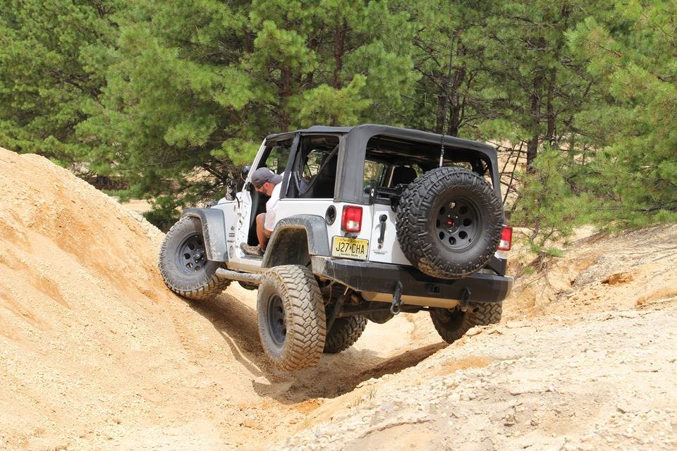

    I really like the AEV rear bumper on the 4-door Wrangler. Those are great bumpers.

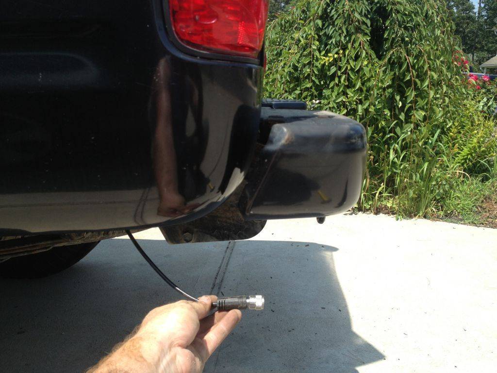

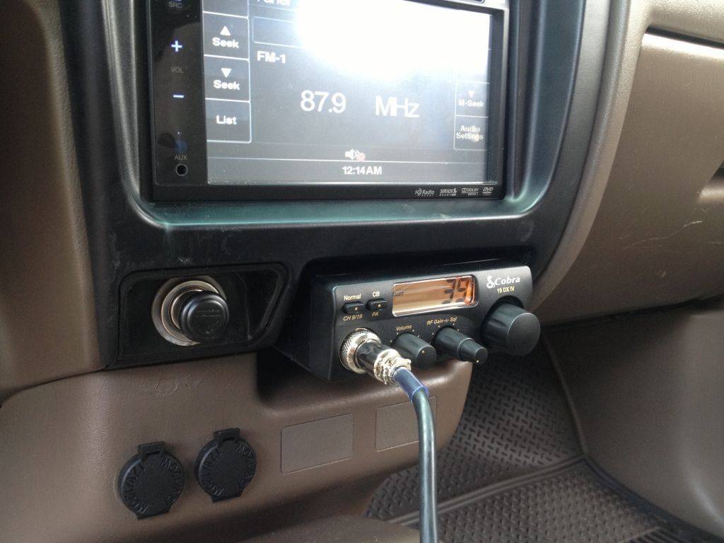

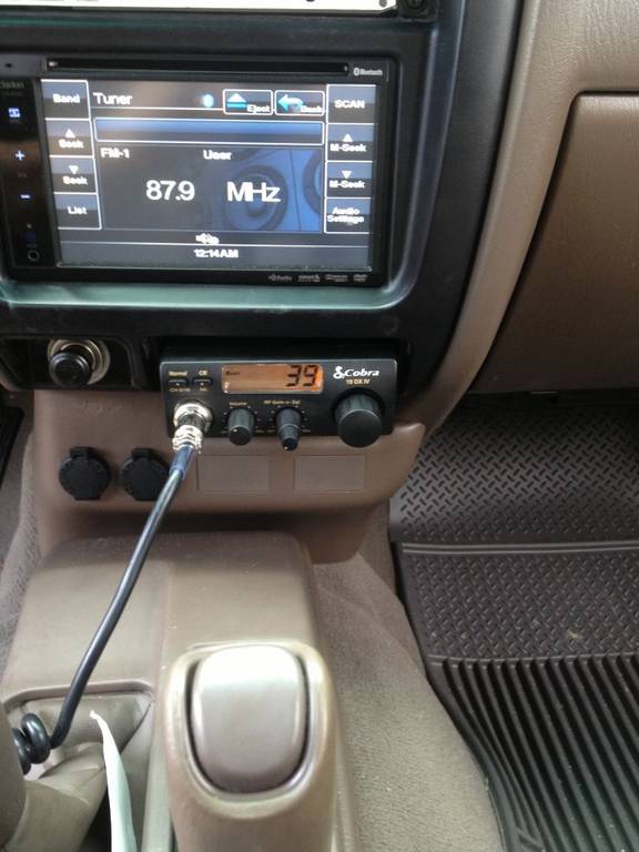

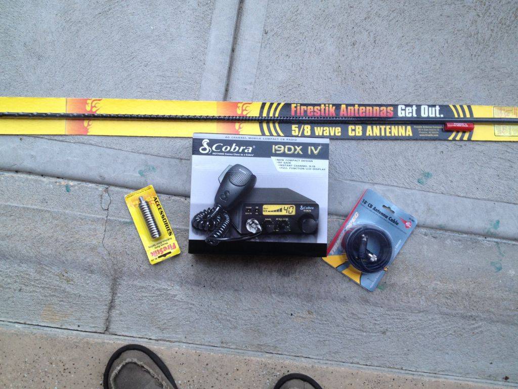

    Installed a cb today. Just need to get it tuned.
    This stuff I got from Amazon (Prime).
    Cobra 19DX IV $42.00
    Firestick II 4 feet Tunable Tip - Black $20.16
    18' RG-58/U Coaxial Cable With Pl-259 Connectors $9.90
    Firestik SS-3H Heavy Duty Stainless Steel Antenna Spring $10.99
    This stuff from RadioShack.
    Right angle adapter for PL-259 $5.99
    CB antenna mount for PL-259 $8.99
    Flex tubing 1/2" diameter 10' $5.99
    I ran the power wire from the cb right to POS terminal on the battery using an insulated ring terminal. I grounded the cb to a screw under the driver side. I ran the coax cable down the driver side and out a cab plug behind the rear seat. I followed the path used by the brake light wires.
    All in all, Im super happy how the install came out. I think the best place for the 1st gens for a cb is the ashtray. Well since I have never used the ashtray and it would NEVER stay closed.
    I just need to get it tuned now and im good to go.
    I used this 90 elbow for behind the cb. This way I could tuck it back as far as possible.
    Stud connector
    With the coax run/tucked properly, here is how far 18' of the coax got me. Right where I need to be.

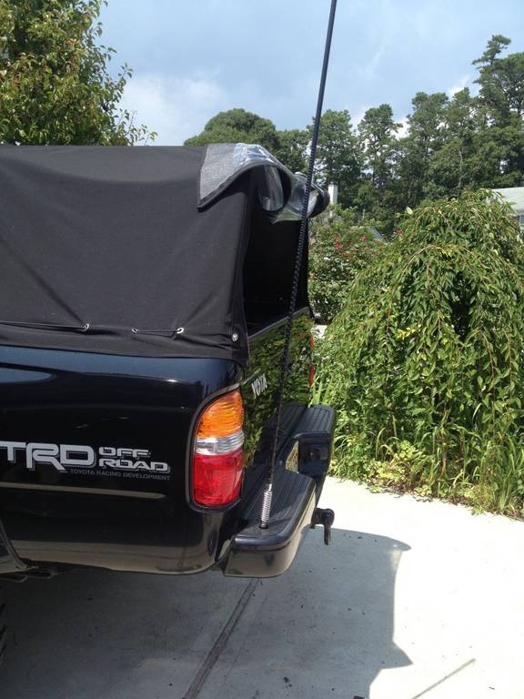

    Antenna mount. I may change this if I order a BAMF tailgate bracket
    All installed

    Very nice Woody. Thats exactly the same way I done mine but put the bracket up front. Im running dual antennas though with a PRO 520 XL uniden. Nice job though. I guess u were quite happy to have the right amount of coax.
