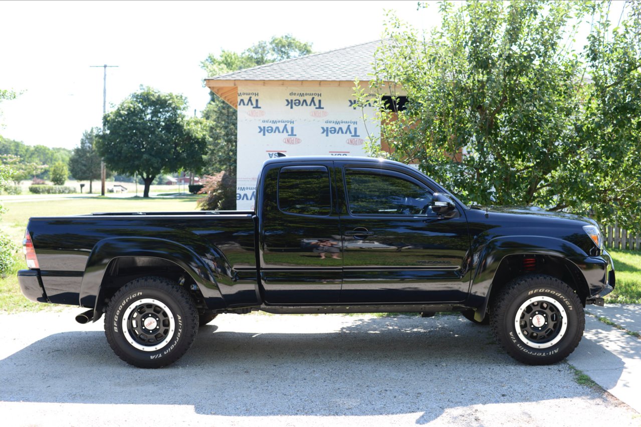

    Earlier this year my parents had a friend that passed (mid 40s, brain cancer. FU*K CANCER) and left me the opportunity buy a 2015 Garage kept ACLB Pro for 26k.....oh yeah with only 7,5xx miles on it! I was on the market for a 2017 OR double cab but I could not pass up on that deal.
    After few weeks finally got around to sell some of the accessories and cut the flaps.:(

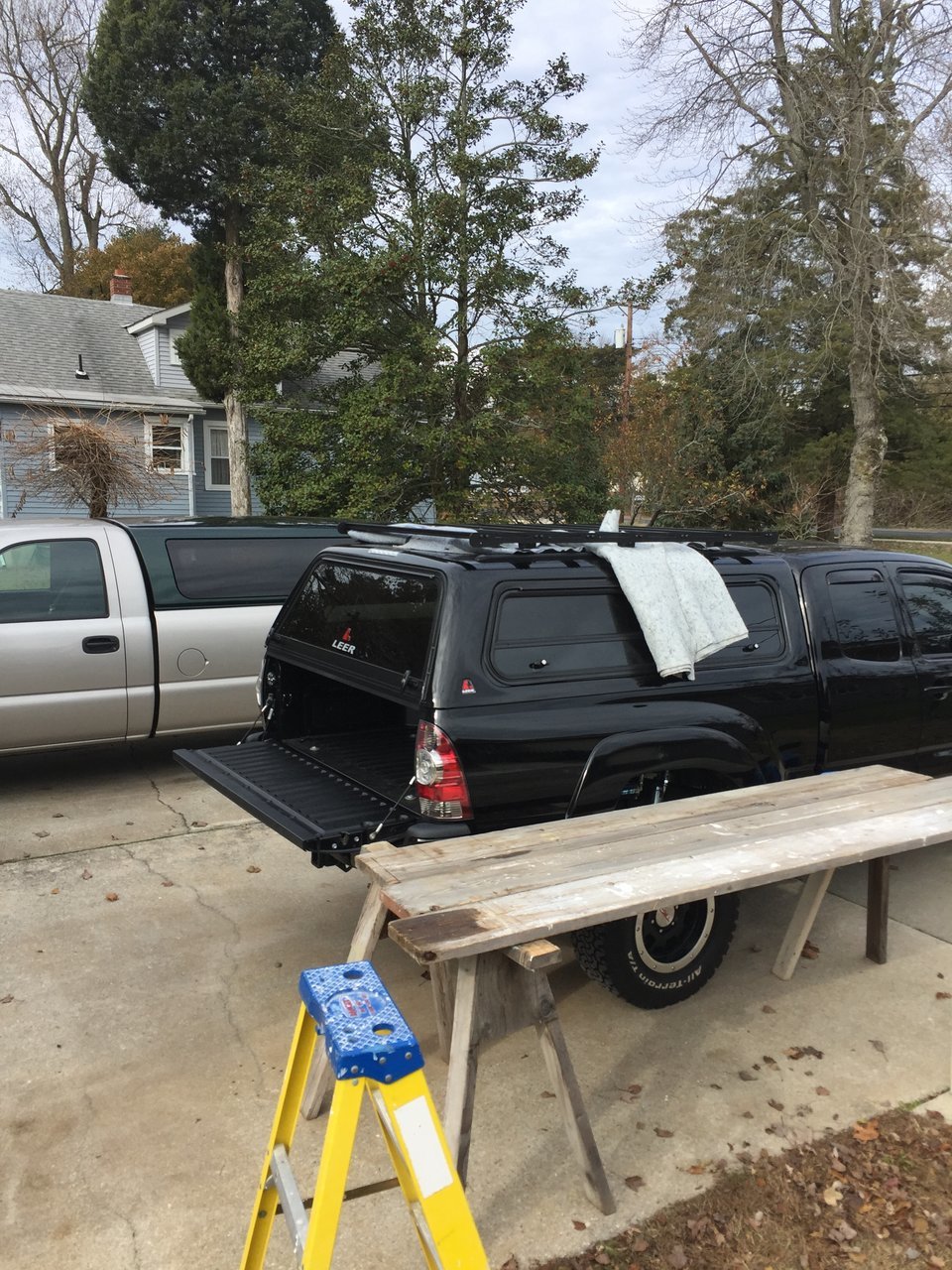

    I added a Leer 100R shell to keep stuff locked up in the back. Mostly snowboard gear / camp gear
    How she sits on 9/19/17. Her ass is dragging.

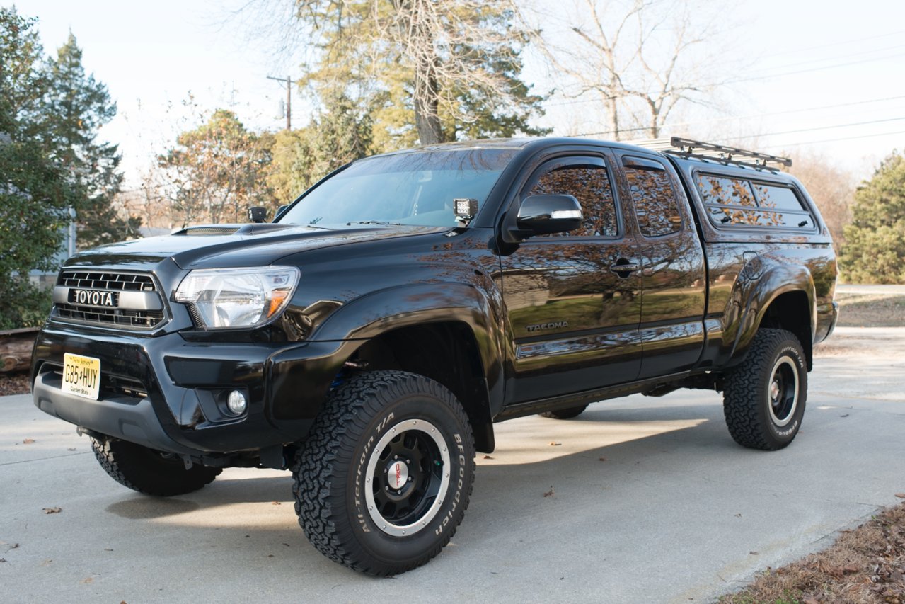

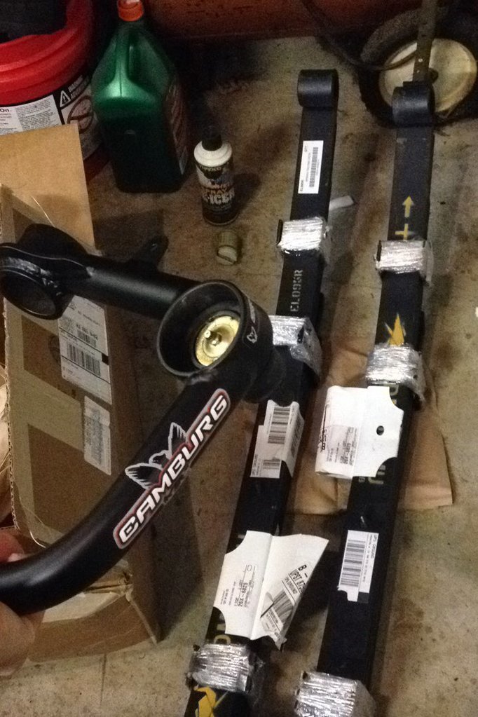

    New Dakars, Flip U bolt, UCAs, front superbumps are in. Rear superbumps and OME aal are back ordered. It will all come together after my elk hunting trip in 2 weeks :taco: IMG_0986.jpg

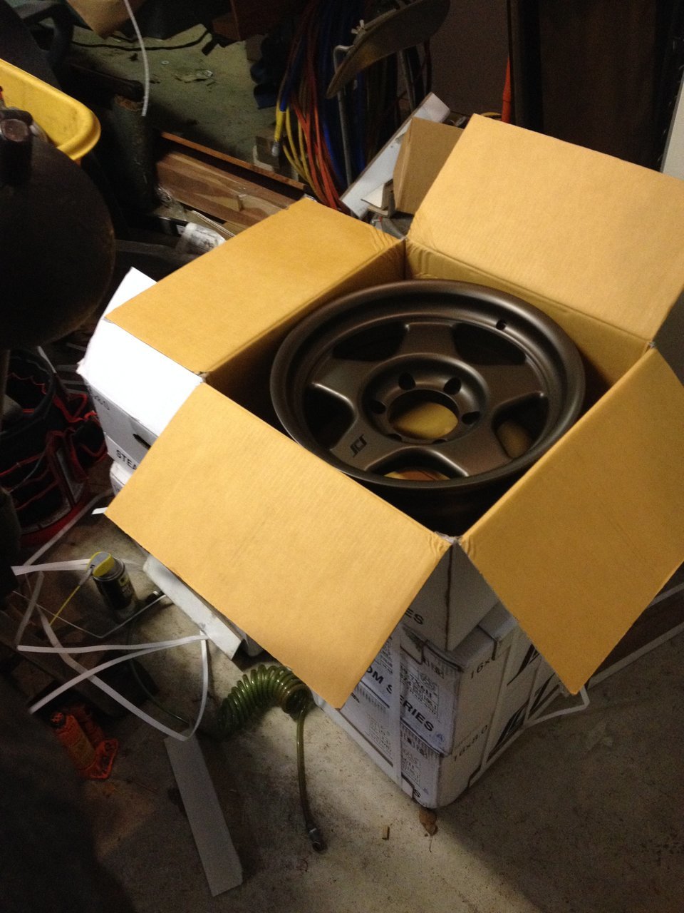

    New 16x8s are in. Waiting for the shocks to get in and get started on the build.

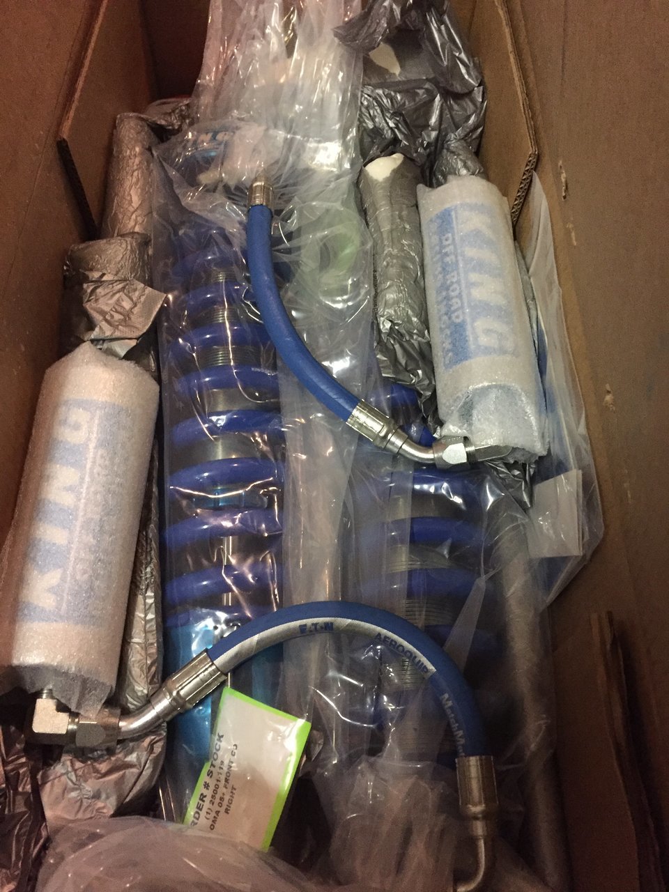

    Bit the bullet and went with Kings.

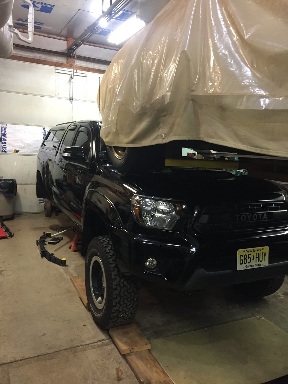

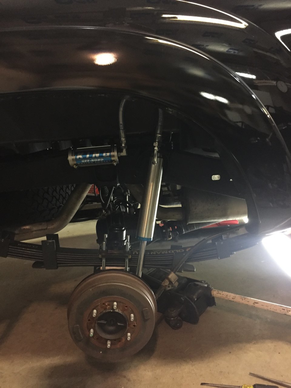

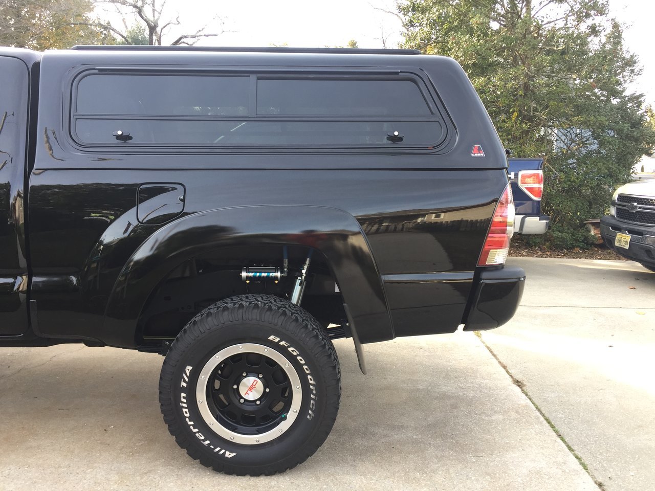

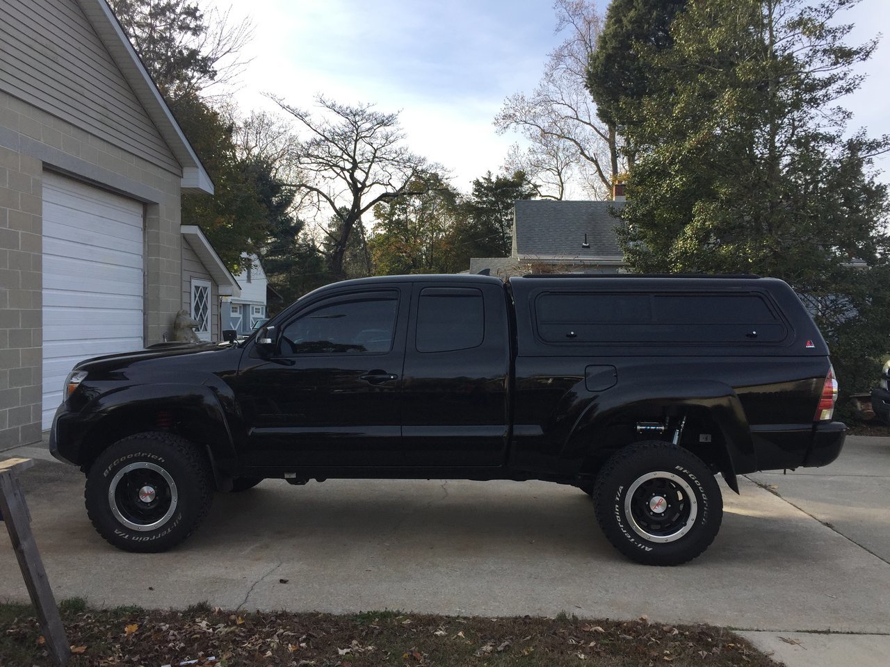

    Installed the Dakars and rear kings. It was about 25 degrees this morning so i put her in the garage, she just made it. I ended up using the 095 springs + 1 AAL and removed the overload. Super stoked on how it came out and how easily it was. It took around 4 hours (could of been less but a bit to much partying last night). A bit stiffer then the stock, but plan on putting on more weight.

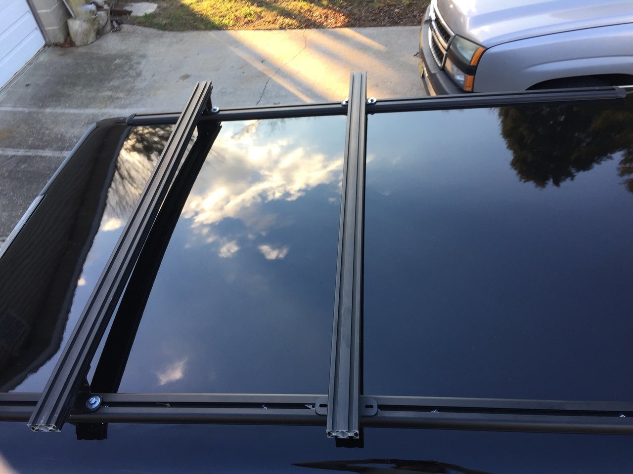

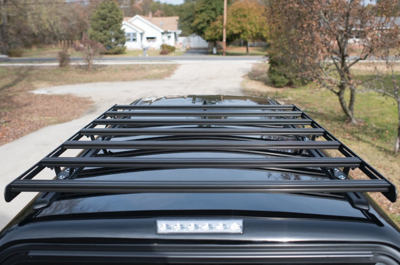

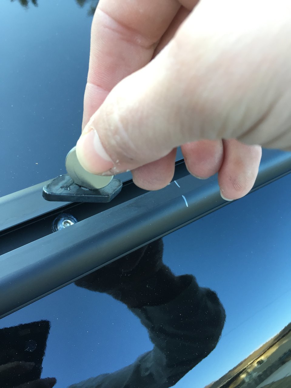

    Installed the Prinsu. It was not as bad as i was expecting to install by myself. The hardest thing was to make sure the feet were lining up with the Thule track and install the track nuts. I found it was easiest to use a magnet to install the track nuts.

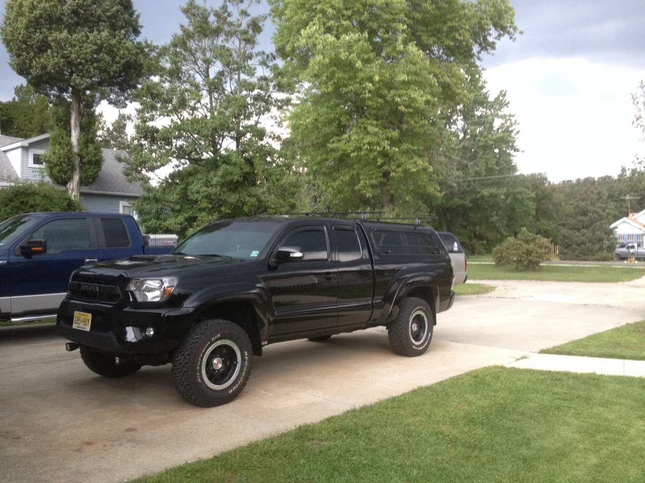

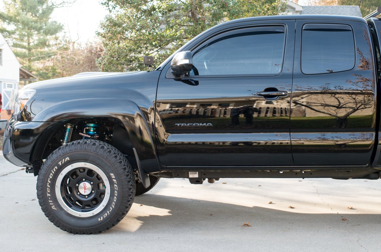

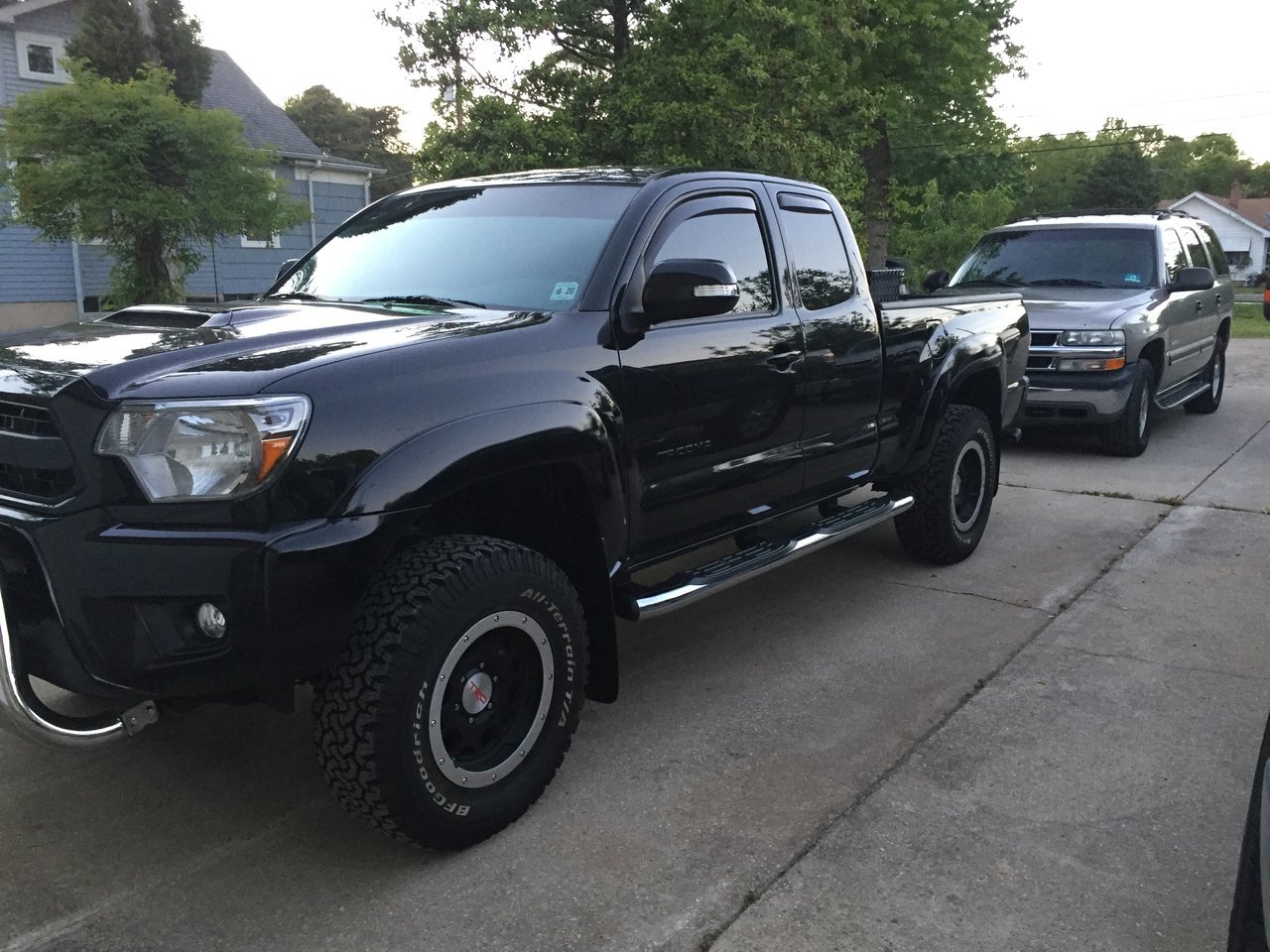

    Finished up putting the front coils and UCA on. Very easy to do, a pain to remove the UCA bolts but other then that it was enjoyable to do and learn. Close to 2.5" of liftScreen Shot 2017-12-04 at 8.12.31 AM.jpgScreen Shot 2017-12-04 at 8.12.21 AM.jpg

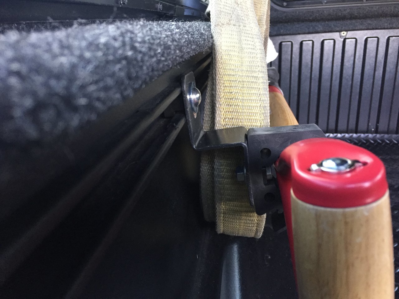

    Installed shovel bed rail mount. Had to make some clips up to push the shovel out.
