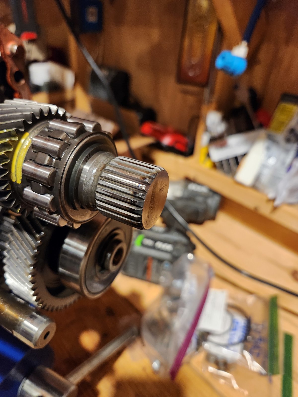

    These are the splines that mate to the transfer case. Why they look hot? Is it useable20240425_113703.jpg

    You look to be having some type of wear. Very hard to determine the type based off one picture but looks to be some type of three body abrasive wear or surface fatigue. The dark marks are most likely varnish. Which is caused by thermal and oxidative degradation of the oil.
    What maintenance are you performing and talk about any previous maintenance you performed on the transfer case. Last time you changed oil, what did you use?

    This is a salvage w59 with transfer case. Unknown miles. From a truck that rusted in half. One dude took the 3rz for a swap in an 80s 4runner and I took the trans/case as I'm mating it to a new 3rz and wanted to have a rebuilt trans. I got the rebuild kit and fsm. I can post other pictures of the shafts but honestly they look REALLY good. I haven't split the transfer case and wasn't planning on it. The seal looks good and the sleeve doesn't have any cracks. Basically I have no idea.

    most likely oil was never changed and oil degraded and lost its film strength which caused the surface fatigue. Should be fine to continue to use.

    i see a small amount near the end of shaft...likely (as prev stated) lack of oil/lubrication
    weird thing is that the rainbowing is only on the end.....not entire length of spines
    i revwd with by boss
    i think he nailed it.....
    heat was used to remove the input shaft....it was stuck at salv yard
    i would re-use all day long
    maybe even sand/file the rough areas
    GL

    Interesting though. It IS only on those few splines showed in the photo. There is minimal play on the input and just too be sure I slid a new pilot bearing on and there's no wear there either. It looks all around "low mileage". I'm tempted to just replace the input shaft bearing but am worried I'd put it behind a new engine and start to drive and it screams in 3rd gear or something so now I'm going all the way with it. Does anyone know about selecting snap rings for minimal axial play? Does anyone even sort that out or just reuse the old snap rings? Wonder if there's a kit with the different sizes

    I wonder if those heat marks come from the factory. Could be a part of the machining process where its heated and the edge of the shaft is rolled for the bevel idk.

    Yeah maybe. It still has paint on the gear sets to check the setup or something. The receiving splines on transfer case are clean too. Maybe it wasn't burned off on the finish pass on the machine properly

    You will see the same type of markings on CVs sometimes too. Must be something they do during production

    I think they use heat when machining splines as I feel like I've seen it on CV axles and other splined stuff. I don't think they'd both machining it off. IMO it's fine. Doesn't look like its damaged at all.
