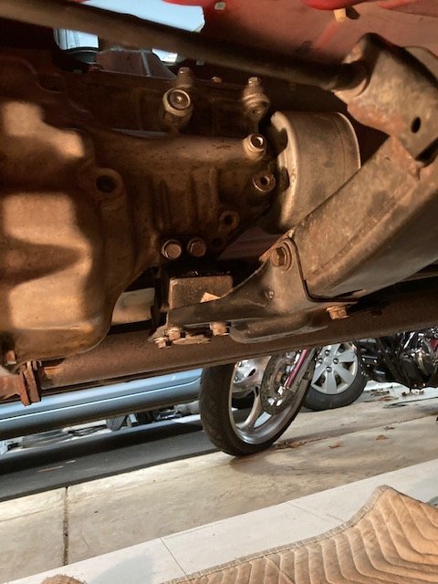

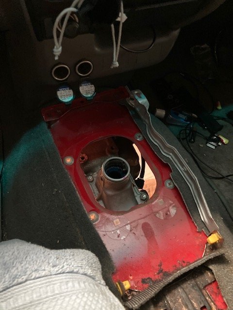

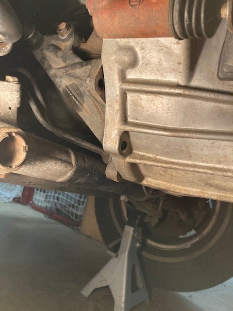

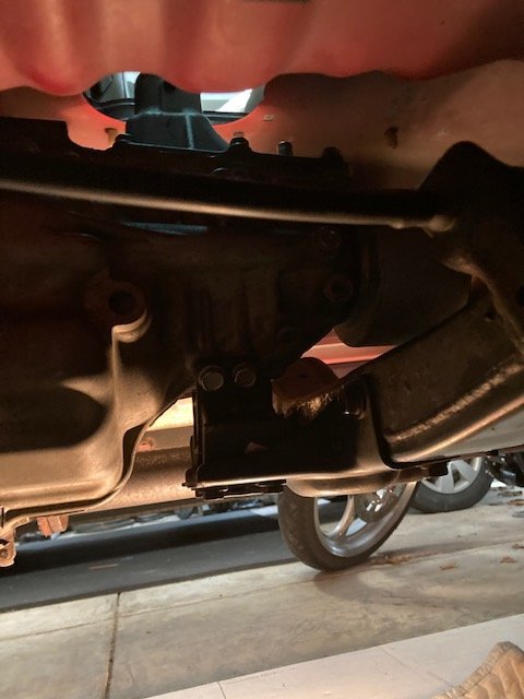

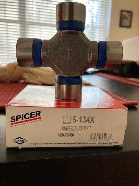

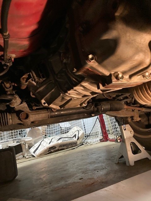

    Hello Tacoma Peeps, I wanted to share my experiences with swapping a R155 into my 01' 2wd tacoma 2.4L. My original W59 was showing its age @ 455,000 miles. I had a little bit of fourth gear bearing noises and thats it.
    I was able to get the R155 tranny installed using factory tranny mount and cross member in my truck. The R155 came out of a wrecked 2012 tacoma 2.7L with 117,000 miles($750). I had the yard include the shifter, slip yoke and clutch fork. I also used a Spicer part # 5-134X to adapt the the 1330 series slip yoke(from 2012 tacoma) to my factory(1310 series) oem drive shaft. I want to also thanK Madtacco461(Mike) for his input. IMG_9605r155swap.jpg IMG_9604R155swap.jpg IMG_9603R155swap.jpg . See pics attached...IMG_9601trucktrannyR155.jpg IMG_9600trucktranny.jpgIMG_9713 (1).jpg

    I will be posting a couple more pics of final install. I will be working on a solution for the left side stiffener plate. I think I will purchase another passenger side stiffener plate. I will be cutting it up and welding it up with the drivers side stiffener plate. I believe the passenger side has the correct bolt spacing.
    I will post when I complete the fab. I will say one thing... getting this tranny installed was kinda a bitch. Tight as a frogs ass lol! I had to jack the engine up and down to find the sweet spot and the case still scrapped the pressure plate going in. I just wanted to see if I could do it. I was planning to fab a new cross member, btw- Kevin
