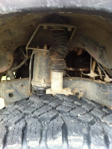

    And on to looking at the lift kit. BTW I've never done a lift so this should be interesting. I am mostly looking to delete the lift for now, with the idea to maybe look at a shorter one in the future.
    As we can see here, we have a mess. As far as I can tell this lift kit was a combination of things. We have a shock spacer that measures 6inches. The top of this appears to be mounted to some sort of aftermarket upper control arm. I think I should be able to remove that and the failing extension that connects to the upper part and put on normal upper control arms.

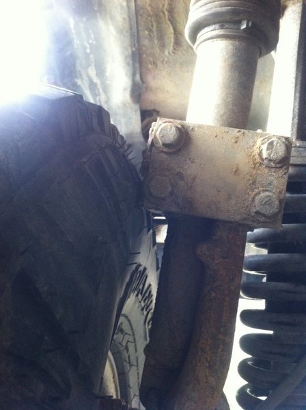

    As this next picture shows we see the real reason I want the lift to go, besides just being in poor shape, it just doesn't fit in this configuration, as it rubs the tires. Not good for the tire, makes a bunch of noise, and generally poorly done.

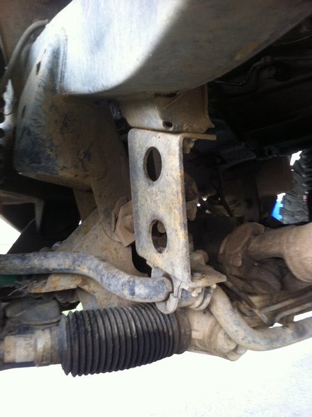

    Found these extensions mounted for the sway bar. To me that looks like it would fold pretty easy, but seems to have held up so far.

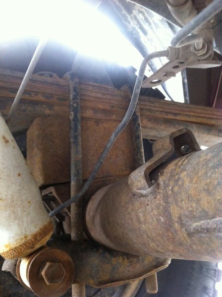

    Moving to the back we can see that we have a simple block and longer u-bolts. However when measured this was only 3 inches. Truck sits pretty even and I'm trying to figure out where the other 3 to make 6 inchs to match the front is. I didn't see shackle extensions but I'll have to look again.

    I'm subbed, good luck with the repairs. The 95-97s have some minor differences from the 98-2000s if you need any help lemme know, I may be able to help. That old lift looks really dangerous, especially the upper control whatever that is (arm, strut, bar, crap?). Hopefully the cross member wasn't cut out to put in that drop bracket.

    Yeah it's not road worthy at the very least. I haven't seen any cuts so far as far as the lift is concerned except for a slight hole in the front wheel wells where I think the bolt on top either rubbed or didn't fit. Looking at it, it was kinda a hack job of a bolt on lift. Definitely going to needs to find some upper control arms at the very least.

    When you are in there, it would be a good idea to replace any front suspension joints. This includes balljoints, tie rod ends, sway bar links/bushings.
    Also, it could have a different leaf pack in the back, or an add a leaf. Looking at everything else I would examine the leaf pack and determine if there is an extra leaf in there.

    Yup by the looks of it you've got an AAL in the rear. Its pry 2" giving you 5" in the rear. That would make it pretty level considering the factory rake.

    That lift has me confuses in the front... Rear looks like block and aal. Id just remove the block for now.

    Could be an AAL, I'll have to compare it to the rear end of the 2000 when I get home.
    I doubt we're the only confused ones. What gets me more is that someone installed this and then just went with it. Then the next guy bought it and drove for a year like that, with the tires rubbing. He was only selling it because the lift was failing, and apparently it took a shop to tell him that it had to go before he realized it was an issue! Not sure what I wanna do in the back. Going to remove the blocks either way, probably see how it sits with the AAL and go from there.

    stock leaf pack is 3 leafs not including overload. yours has 4. 95-97 has different leaf springs than your 2000.

    I figured it was probably 3 for stock, but didn't remember. Leaf springs should be the same style and design, except for possibly length or mounting I would think. Therefore I could've compared the packs and noticed the extra leaf, unless I'm mistaken?

    Whoa that front end is definitely a mess. I am really impressed at the upper control arm/shock the have bolted to the spindle, so when you turn it rotates the shock? Also it does look like that cross member is gone for the original lower control arm mounts, that can be replaced but its quite a bit of work

    When you turn it rotates the smaller shock that would normally be where the original upper control arm connected. It doesn't move the main shock anymore than normal I don't think.
