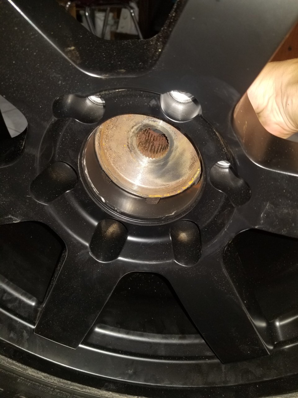

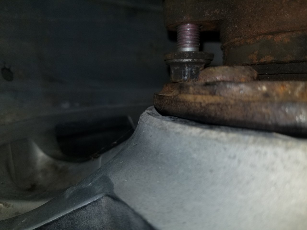

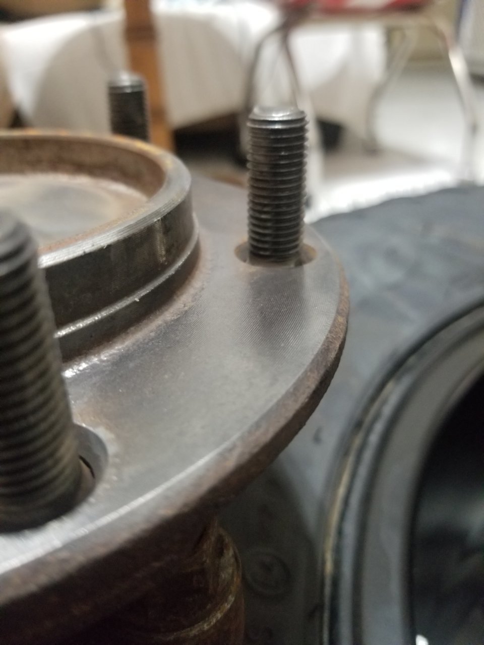

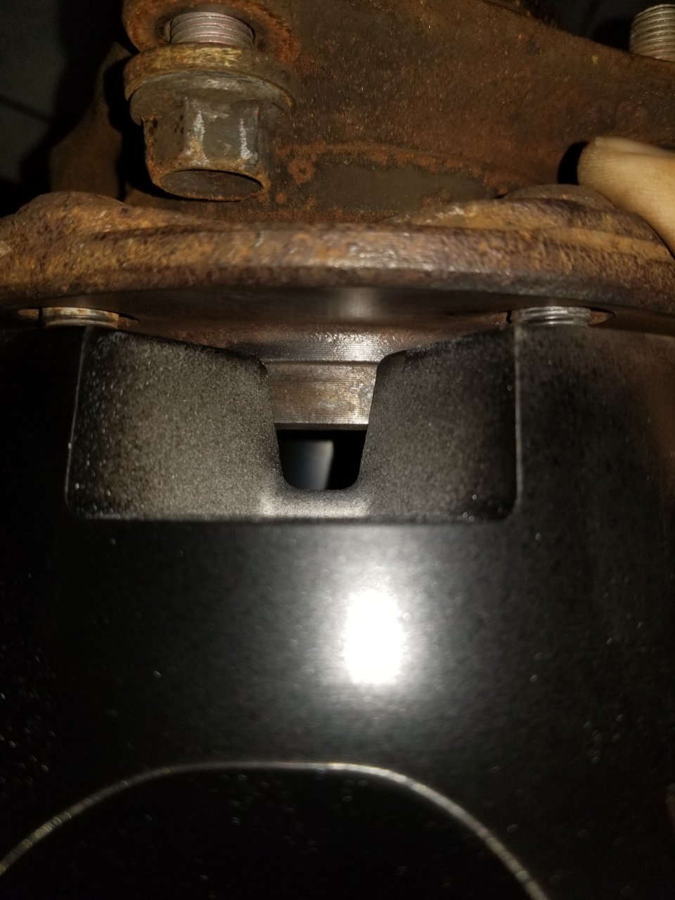

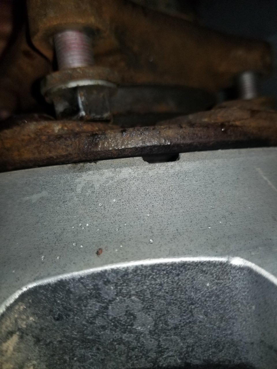

    I joined the club and got myself these wheels!
    Ido have a question for those that current have the wheels on their tacos.
    As I am upgrading my truck with gears, gussests, and everything else I noticed that the wheels do not fit flush or mount on the actual hub it self.
    At first I thought it was rust so I wire brushed my hubs and they fit perfectly on my OEM wheel 16.
    Then I tired the level 8 wheels and there is a gap on all 4 wheels...probably a couple millimeters.
    After looking at everything the Toyota hubs have two machined lip, including the rear axle.*Edit, the rear axle does not have the same machined lip as the front hubs.
    Seems like the wheels are only machined to fit the first section of the hubs ( at least mine).
    So I was wondering if a couple of people could take pictures of their wheels from the inside to check if it's fully seated to your hub
    Wheels spec
    17x8 w/ -10 offset.
    I've attached some pictures.
    First two pictures are with the OEM wheel.
    Third pictures are level 8 wheels.
    Last one is the hub.
    Thanks guys.
    Edit* I forgot the rotor! Sorry!

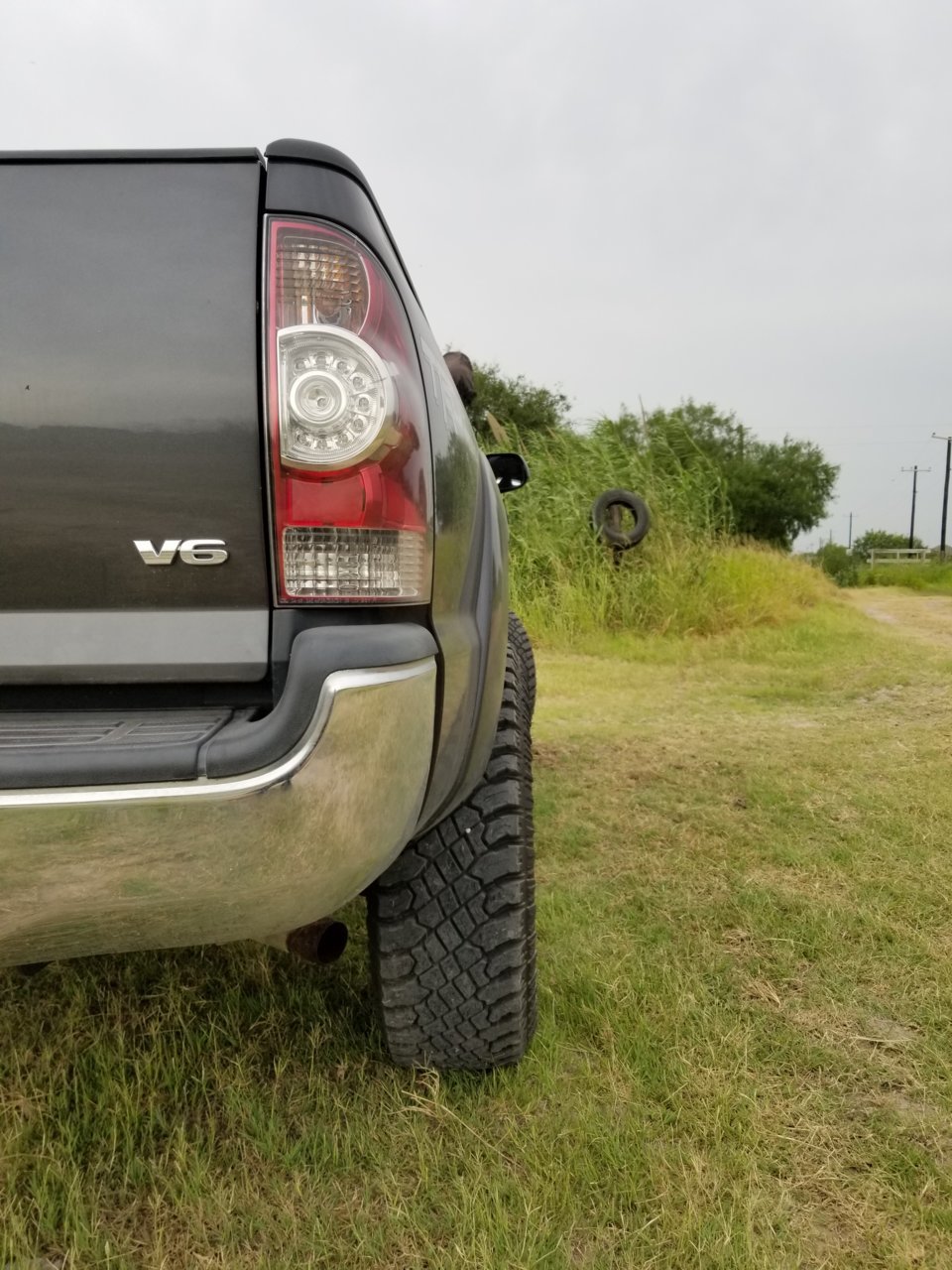

    Wheels: 17 x 8 w -10 offset
    Tire: Atturo trail blsde XT, 285
    /70r17
    Lift: Bilstein 6112 on 4th clip with upgrade B12 coils.
    After trimming the plastics I rub a tiny bit while driving normally but I'm sure I will rub more once offroading.

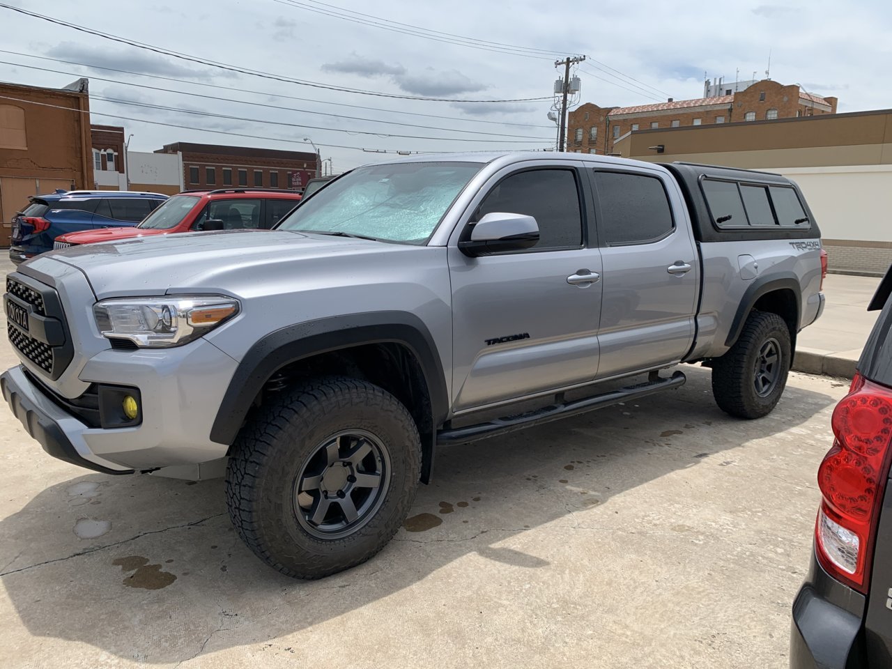

    EC42926A-73FB-4C16-AC6B-A20B726EB8D6.jpg 167083A4-3204-40D6-9C2E-6E61086DE82A.jpg
    Ordered the same back in April and just got them Friday. You won’t be disappointed

    This could also be due to you checking the wheel with the hub and not the hub with the rotor. The rotor fits on the lip closest to the hub(the raised lip)

    This was the case - the OP caught the mistake.
