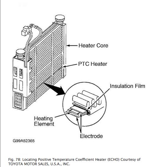

    For the 3.5l Tacos, search PTC heater.

    There's an electric supplemental heater, but it only kicks on if you turn it all the way to hot, and the truck thinks it's less than 50 degrees outside.
    The 3.5 just takes a long time to warm up. 11.1 quarts is a lot of coolant I guess.

    As stated above, the truck is equipped with an (PTC) electric heater, no coolant warm up required.
    To operate, simple turn temp control knob to the heater position, press recirculate button to on, turn fan to max. This should activate the electric heater to begin warming cabin air.
    Hope that helps
