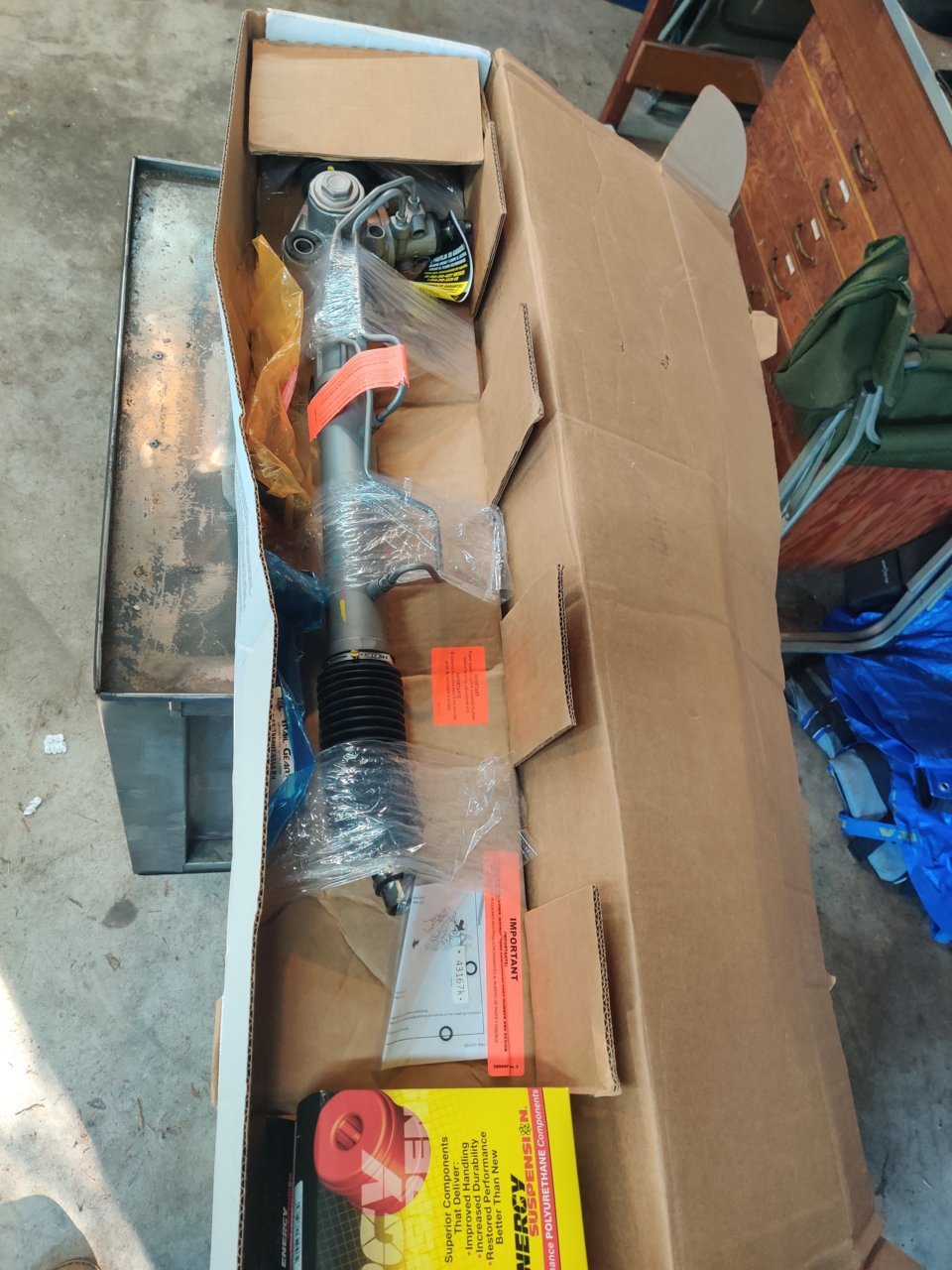

    Now I take back that it's a rebuilt OEM. I got the part but it's an aftermarket one. It also - does not have the updated guide. Well shit - back to the drawing board. Gonna see about returning it. Funny thing is the website shows the updated rack (from 2001-2004) but it's not what you get.

    Those bastards :( I'm sorry you're dealing with that trouble
    Did you keep your old one? They're rebuildable, but it's not exactly an easy job. I did it with the dirty pool write up on this website and a Gates rebuild kit I bought from rockauto
    I regretfully can't tell you how effective my backwoods rebuild job is tho, cause I have yet to install it :laughing:
