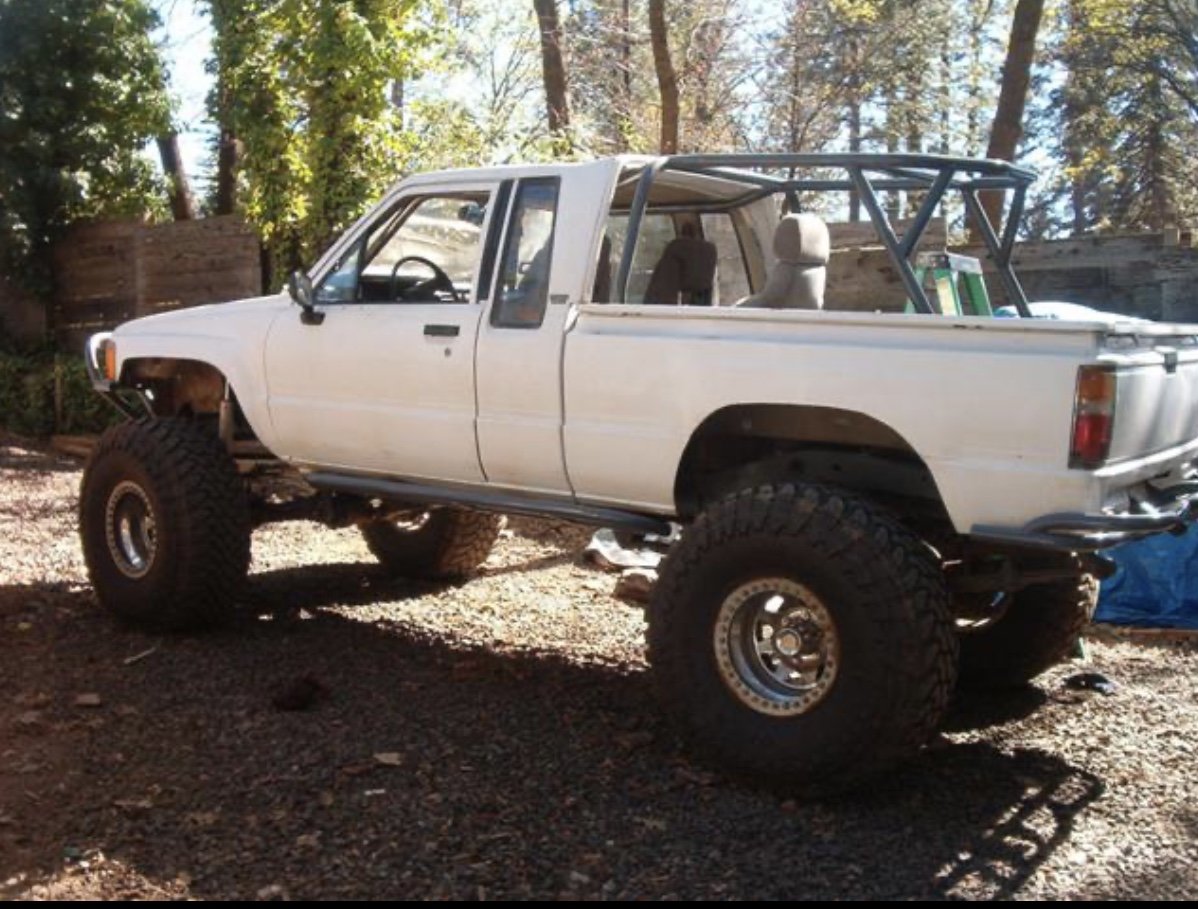

    Ill see if I can find more pics I built this a few years back
    SailorWA and Wulf like this.

    Some shots of it

    Thanks Beut4ce that’s pretty close to what I’m looking at doing, and it looks awesome! From the thread it looks like it’s pretty water tight. Did you have any issues over time with the material you used (cracking, fading, etc.)?
    I would love any pictures of the process, seams, etc and or any advice you have for making it simple and water tight.
    Also did you have any problems with the bed after it was cut? Pictures of the floor (cab to bed) transition would be fantastic. And did you feel the need to stabilize the bed to the cab in any way?

    Used bmw material for top and 19oz clear vinyl for windows used on Volvo c90s....front lip used a fold over c channel like the front of a jeep with a small rod in front then velcro...rear used snaps it rolled over the cage and t used then snapped.
    Rear window I made a 1inch ledge all around that the window velcro to and because it wwa recessed it avoided water or weather coming in...the sides were heavy duty plastic ykk zippers with over flap in back for any water to not get in....the sides snapped into place on bed...the frame work 4 bolts held it to bed rim so you could remove it....left rear bed in place built up a wall and welded it in did bench seats and seat belts back their for the kids...
    It was pretty damn tight I did do weather foam strips in a couple places for wind but water stayed out like a jeep top....as far as UV break down it would be the same as any convertible since all material used was from German convertibles....was all quality and it DID NOT flap while going down freeway it was pulled tight when you I ull rear material over and under tune to snap.
    Mt. Man-Mitch[OP] likes this.

    Don't have any more pics....just my thread i had....it worked out amazing....I had hopes for it and it exceeded them.
    .that rig resides in reno truckee area for last 4 years now....
    Good luck with it and keep it simple....
    -look how jeep tops fasten down as far as 87 to 96 wranglers...don't use the material they use it breaks down quick so does that shot plastic vinyl for windows....use quality stuff if you can...
    Look at scout soft tops and see how they snap to body or soft top rears for k5 blazers....
    I already knew how I was doing mine but I've been around rag tops, low riders, convertibles, jeeps, broncos and scouts my whole.life...we have build some crazy rides for show and customers...
