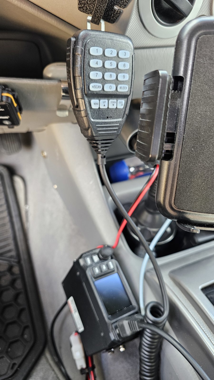

    I went through this a couple months ago. Decided I needed something better then a typical handheld blister pack radio. After watching a ton of YT videos I ended up getting a GMRS license and a Baofeng UV5G plus, it's a 5W GMRS radio similar to the others. The primary difference is some menu tweaks, a little bigger color screen. One of the reasons I picked this one is I can run it off the battery or the USB C plug on the back of the radio's battery. Basically making battery life a non issue while in the truck. It's not waterproof so it's dedicated to the inside of the truck.
    I added the programming cable, a better 17" antenna and a speaker mic along with one of those retractable clips for the mic so it can hang from the rear view when I'm using it.

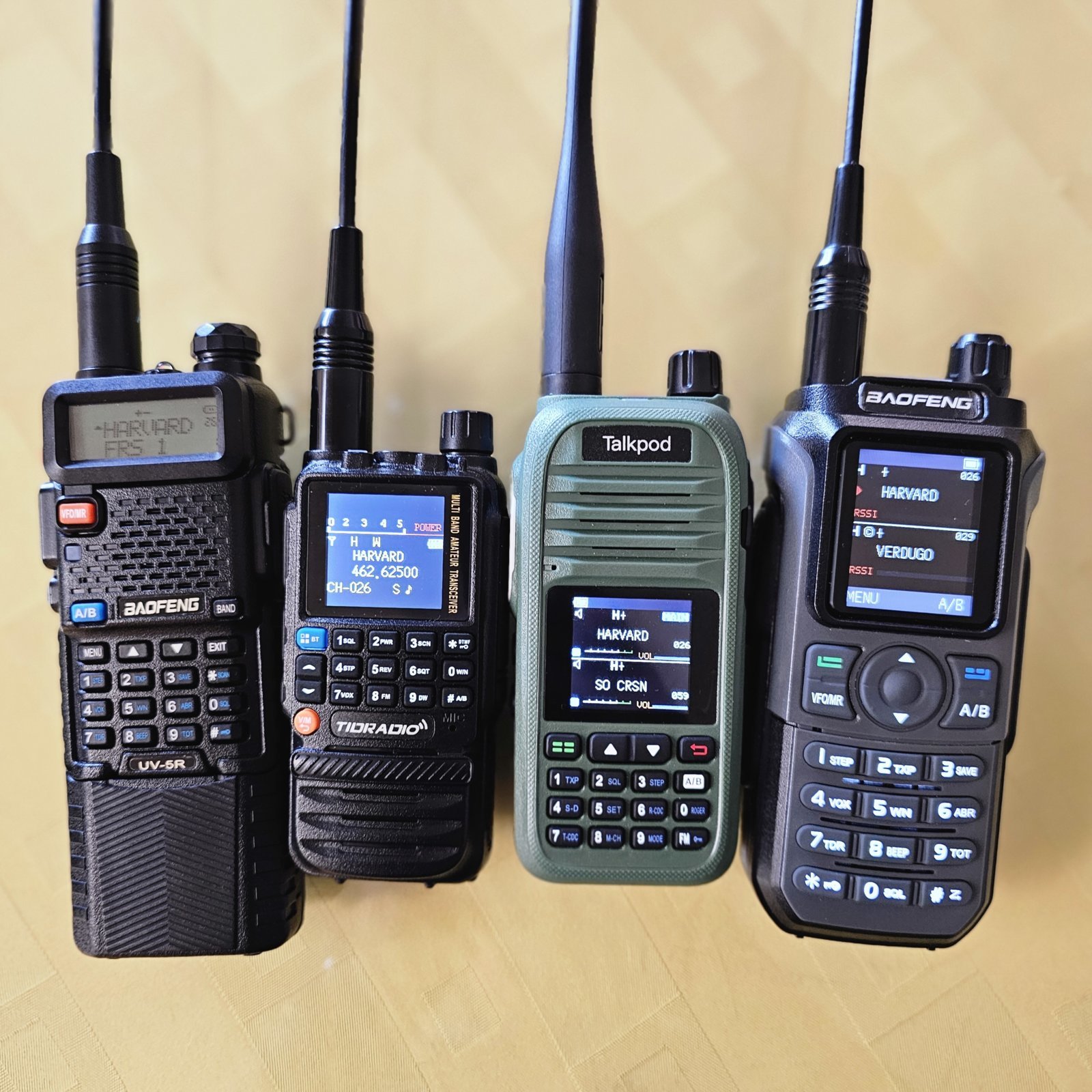

    I started with the UV5Rs and eventually gave them to my daughter out of state who does a lot of hiking and camping with her friends. I gave her enough for her and each friend when they go out. I have them programmed on GMRS with the simplex and GMRS repeaters in their area. She uses my call sign when need be.
    I still have my UV5R GMRS but I have switched over mostly to the newer radios that have USB-C charging ports in the event I need to recharge in the truck. I like the Tidradio H3 due to its compact size for keeping in my daily backpack. The Talkpod is lighter weight but still solid build. It's a deep radio with the extended battery pack so it feels really good in hand. The Baofeng GM21 is a relatively new radio so there are no reviews on YouTube yet, but it has even more girth so it feels best in hand. (insert masturbation joke here).
    The UV5R-G and GM21 can't seem to be jailbroken to transmit outside of GMRS as I like having MURS frequencies. The other two can be. The Tidradio can be programmed via Chirp or from their proprietary app called Odmaster on Android or IOS phones via bluetooth. Not shown is the UV5R-8W which can be unlocked.

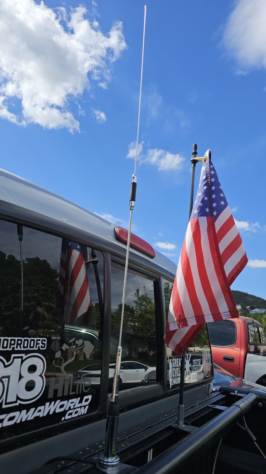

    For both of my Tacomas, I went with the Radioddity DG25G mobiles paired with the Nagoya 200C pretuned for GMRS. The radio works great but my antennas are not in a good ground plane, so I have them grounded to the chassis via wire. I don't feel like drilling into the roof. I may switch over to the hood lid mount instead.
