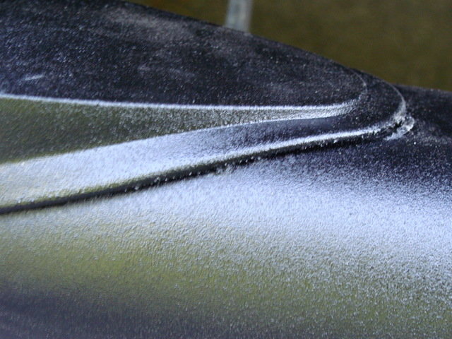

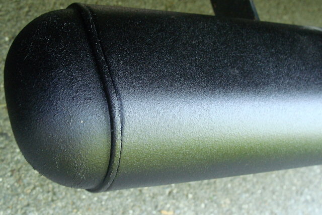

    I used it on my oval steps. Rustoleum Bed Coating
    The factory powder coat was horrible & had rusted after one winter.
    Sanded everything down, including plastic steps,
    cleaned with acetone, let dry
    sealed around seams with silicone.
    used rustoleum rust inhibitor primer first
    Then two light coats of the bed coating spray.
    They have held up great used everyday.
    If you put it on too thick the texture does not come out & will run.
    They now sell a $5 paint can spray trigger for cans works great.
    Spent about $25 in materials better than new.

    those side steps look great!
