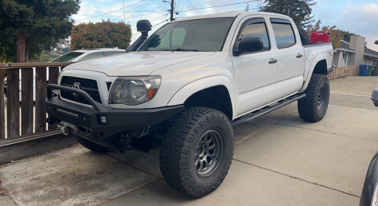

    first bought it 9/13/22 - whack snorkel, in need of paint correction and good detail, accessory wiring looking scaryD464D610-A90A-4B66-A654-7B14E557D929.jpg

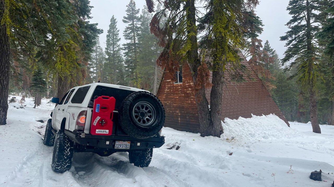

    Picked up a used Leer camper shell, started cleaning up some parts of the truck, installed TRD Sport hood, and iPad mount

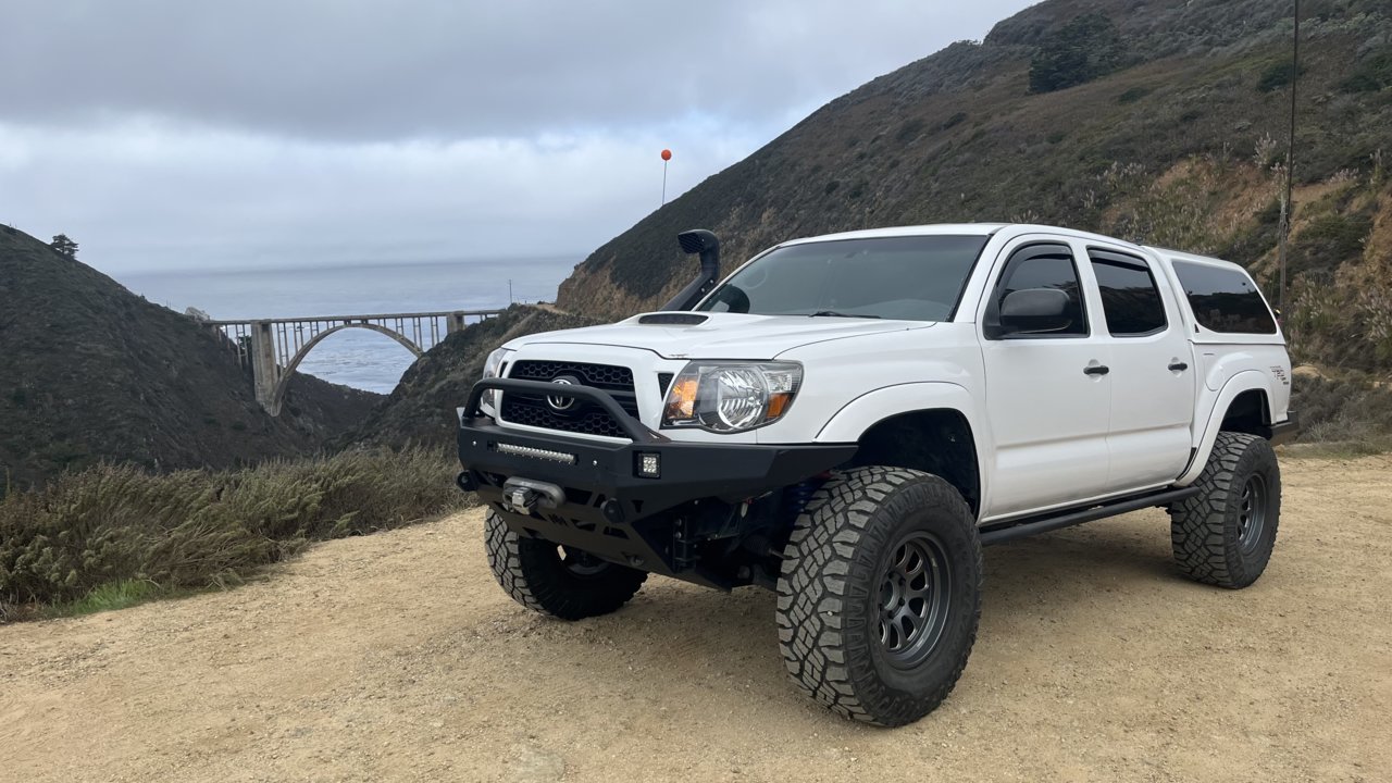

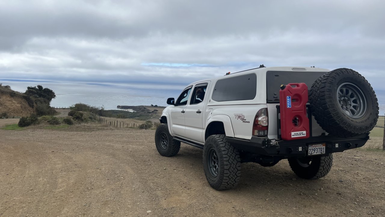

    First day trip in truck to old coast road then play around in the Big Sur area with lady and pup
    Next was a corral hollow trail trip and bear trap cabin to chill at lake alpine

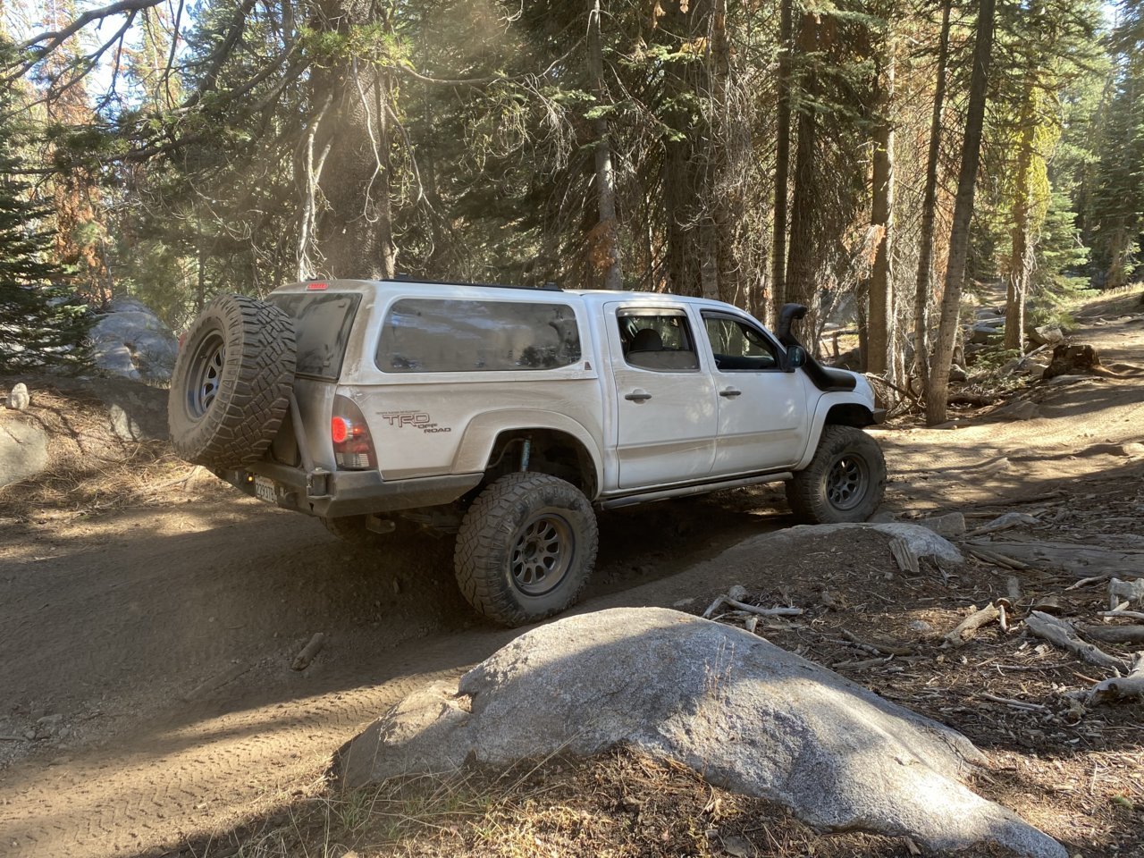

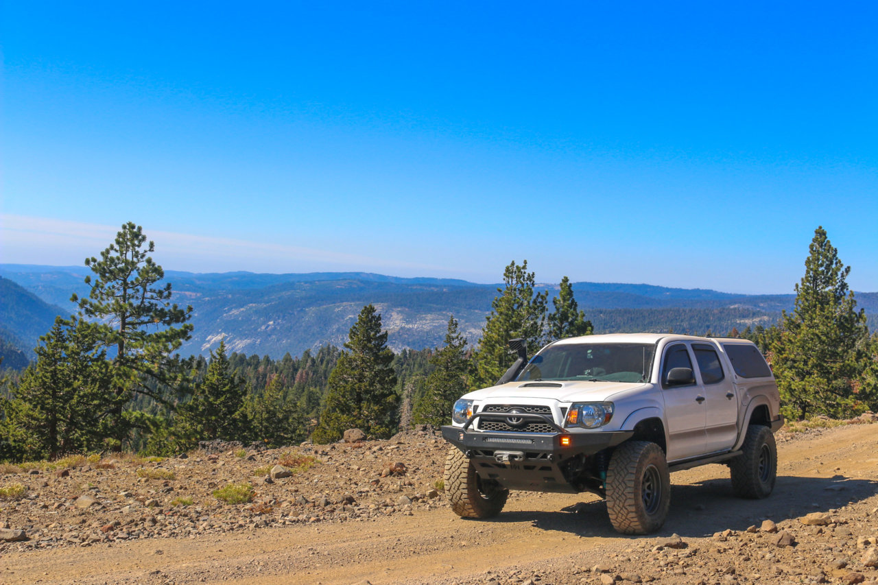

    We stacked these up almost back to back weekends right when we first got the truck. Coming from a background of rock crawling the adaptation to wheeling an IFS daily driver is quite the change. But I rallied some of my buddies together for an “overland” weekend in Mendocino national forest. Overall was a super fun weekend with some mild trails mixed in, camping, shooting, good views and great company.

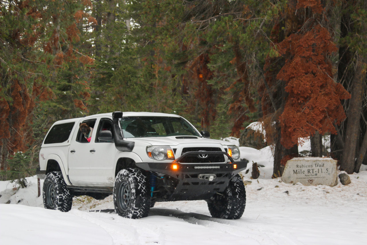

    I had been playing with cleaning up wiring and redoing some stuff done on the truck. Trying to dust and weather seal the camper shell I had was a constant battle since it had some issues. My lady pup and I headed up for an early snow trip to Tahoe where she got the first taste of snow, we played a bit on the rubicon east side and around the lake. DACF89EC-0AA4-4604-90E9-22A4F5DD8183.jpg 4848F7EA-715D-4A09-95C8-990C38F3C0FE.jpg E71643A4-7321-485B-AD5C-C280DE98C49C.jpg
