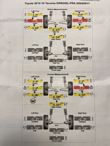

    Are you lifted? How much air pressure are you running? What size tire?
    Most on here will recommend 0* Toe, 0* Camber and at least 2.4* Caster. If everything else is correct (no worn suspension pieces), a low caster setting can make the truck feel like it is sensitive to road crown, ruts and side winds, especially at higher speeds.

    You could have more than opinions and the problem solved most likely if you put it on an alignment machine and get the print out. The red "before" stats will tell you what was wrong (caster). The caster adjustment starts to jack with camber after so much with oem adjusters and vice versa. LR UCAs will give you mucho independent adjustability of both caster and camber whether lifted or not. Money will solve the issue, either for better alignment, UCAs or both. If the alignment is spot on then wandering is gonna be worn steering rack bushings or the rack it self. Only other thing that could cause wander after all that would be worn ball joints, but the alignment guy will tell you if there is any faulty suspension/steering pieces when he's fighting it trying to align it so back to that as step one.............If all that checks out, only thing I got left is a real faunky set of tires doing weird shit, but still, if that's the case a good alignment tech should be able to spot that too.

    Getting in on this as my 2014 wanders on the highway that has ruts. Pulls left and right pretty hard. I am considering the steering shaft replacement or All Balls mod but have done two alignments. Air pressure at 35 psi.
    Here are my latest numbers. I believe these look good.
