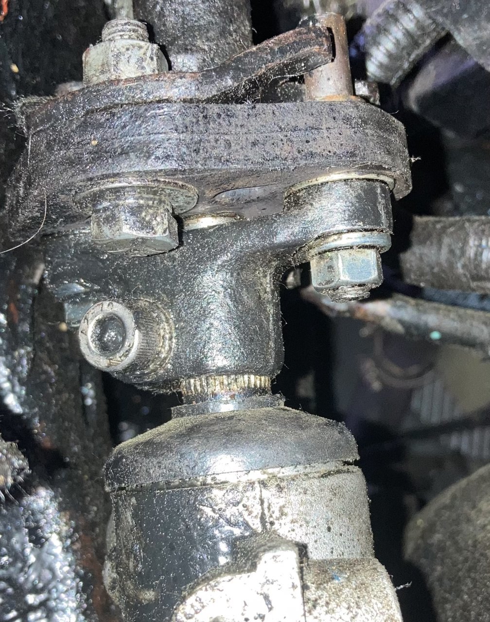

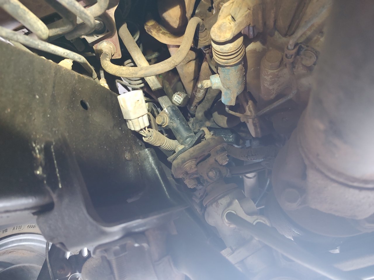

    Is this much of the spline joint supposed to be exposed? As it is, I can’t push it down, nor pull it up. I can slightly rock it. I did replace this part, however now I can’t recall if I can move it down somehow?

    Here is mine but I can't believe that would cause your wandering steering problem. Mayble the steering shaft fix is needed, plenty of info on that in a thread here or youtube. Otherwise I'd say check suspension or alignment. Good luck with it.

    Yea that's not showing on mine either, but I'll echo what @THatt said and say I don't think that's your problem.
    I'd still suggest fixing that, by loosening that bolt on the left side then sliding it down the shaft and re-torquing the bolt.
    The steering column steel pin or weld fix (to reduce play along the joints where it's designed to collapse upon itself) makes a world of difference for the wandering steering symptoms.

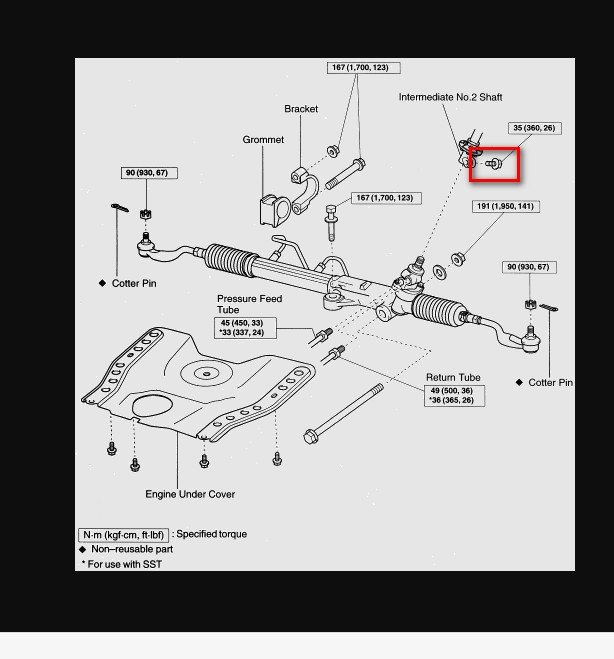

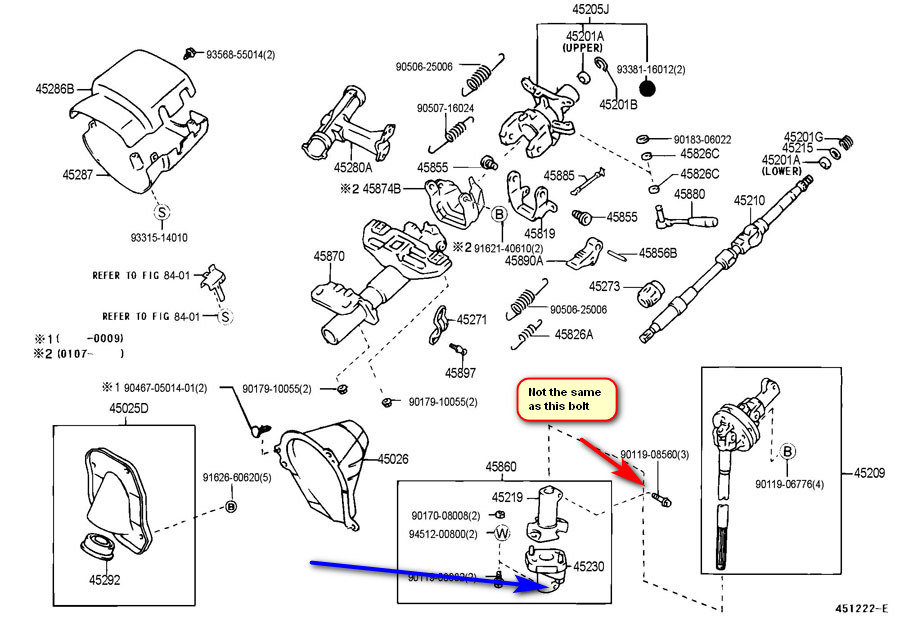

    Does anyone know what part number this bolt is? It is tapered (not sure what the correct term is for that type of bolt) whereas the bolt that is on the joint above is not.

    The yota part # is not there on the diagram
  13. Jun 8, 2023 at 4:40 PM

    Correct. I guess my question could have been, any suggestions on a replacement since there is no part number?
    As I looked more at those splines showing, I recalled that something had happened to my original bolt rendering it unusable (can’t recall what) when I was replacing this part of the shaft. Someone on here stated I could use a regular one, so I found something that would thread at least part way in. What’s going on with the splines is since the bolt is not tapered, as it goes in, it’s pushing the shaft up. Not sure why I didn’t notice that before.
    I was able to get that part to seat better & there is less movement. Just need a bolt to secure it. Not sure if I can use a smaller size bolt with a nut?

    You might have mentioned you did not have the correct hardware to secure the shaft to the steering rack.
    There needs to be a few floating around in part outs .
    Have you posted that your looking for one?
    if it was moving because of the wrong hardware have you done damage to the splines?

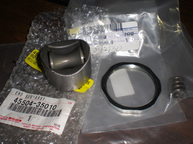

    Three places, at least these can slip.
    Worn out/loose bushings...whole dang rack moves..
    2) Somewhere along the steer shaft..splines....rag joint.....and then mine has another universal above that....
    Oh and the break-away steering shaft just below the steering wheel...they'll twist if thats damaged...

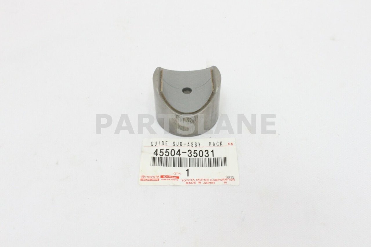

    3) Lastly other than the actual teeth on the rack....is a worn out steering rack guide.

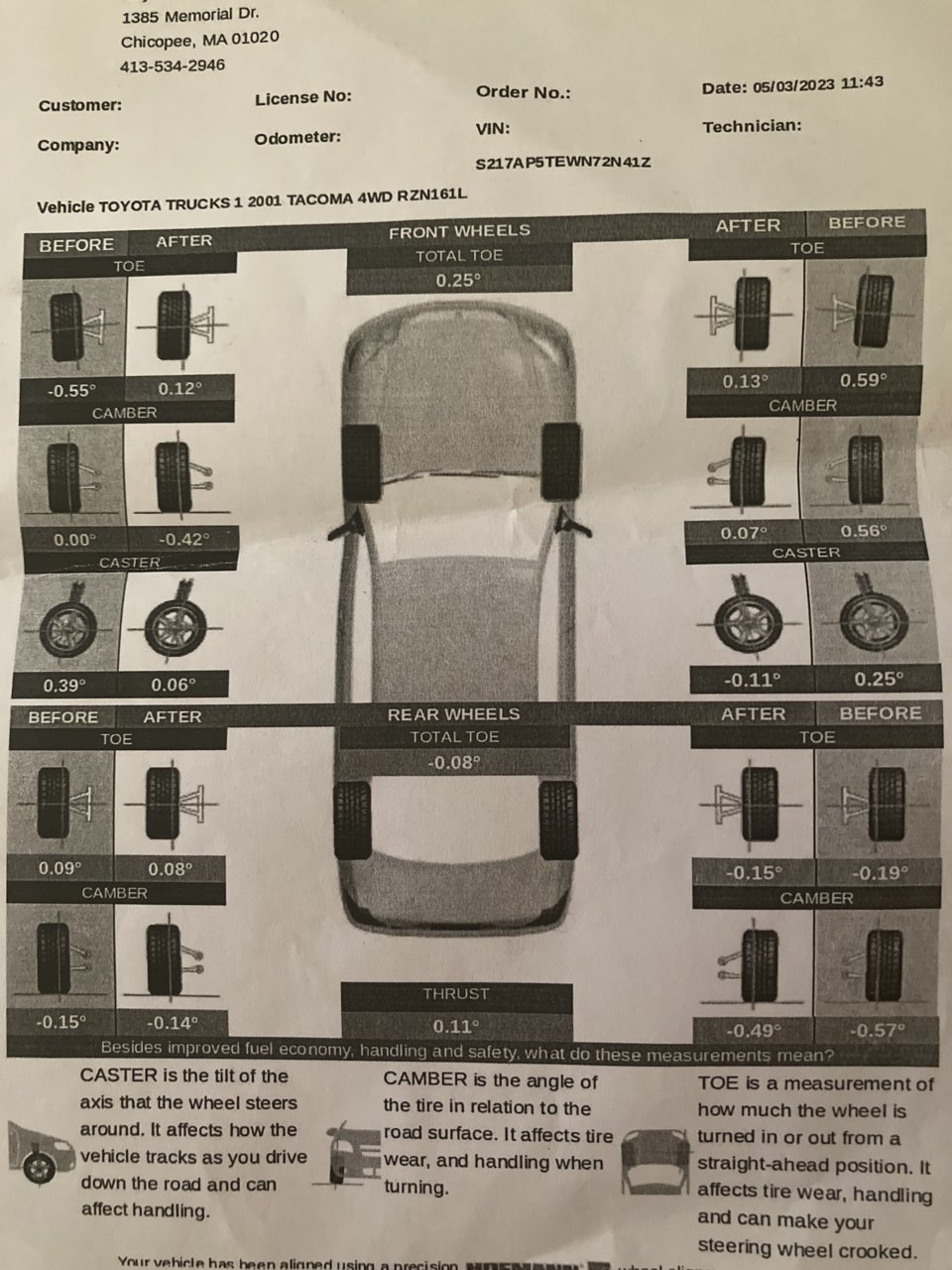

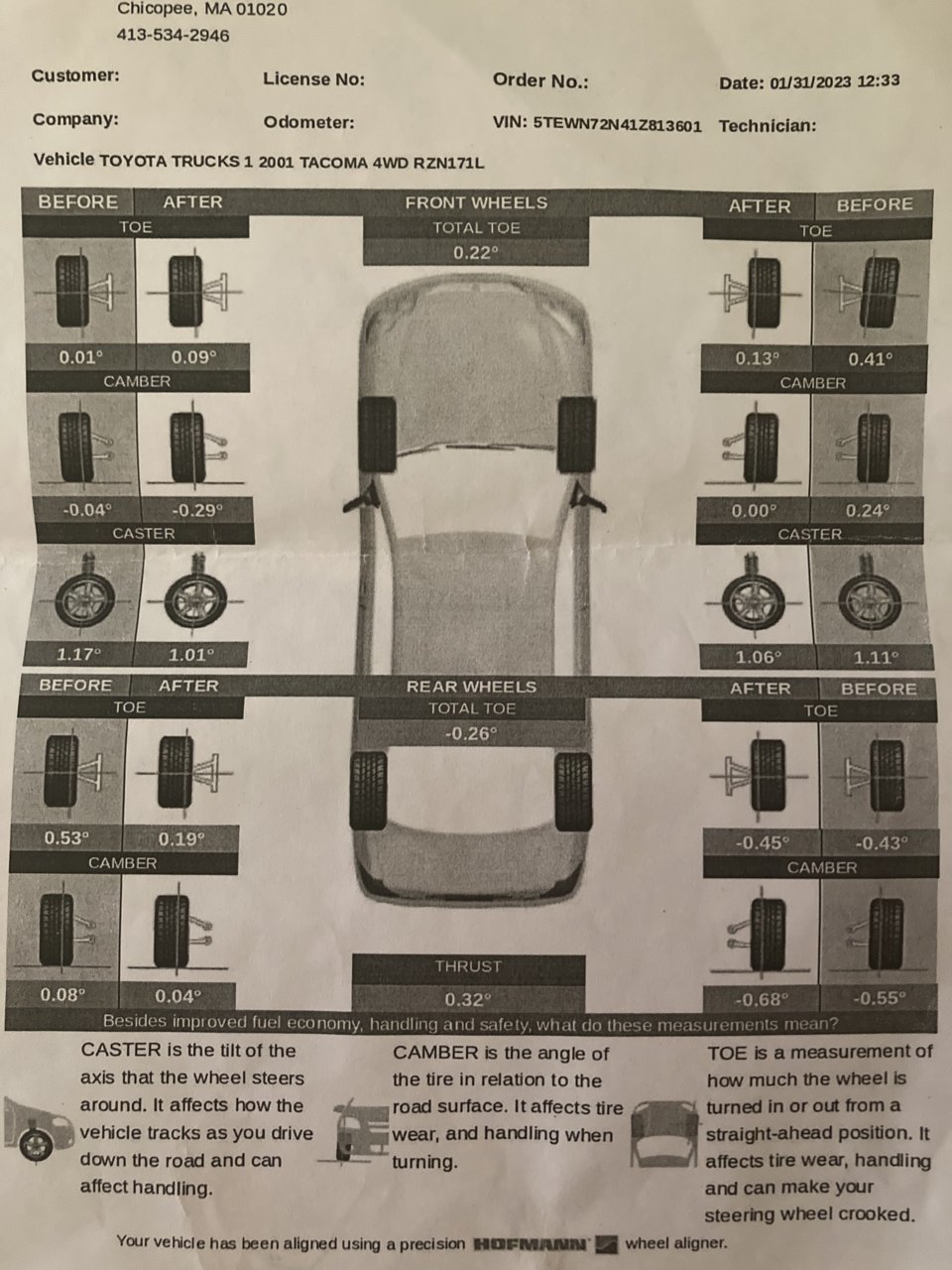

    I actually paid a frame shop to get the axle back on track & here is the resulting alignment numbers. Actually, I’ll put pre & post
