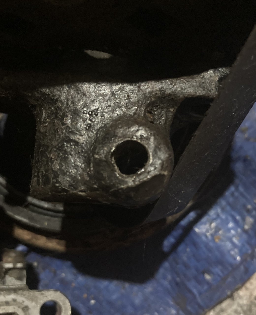

    & as far as the Toyota part goes, I found the original & it is the same way, so back to bolt confusion

    I believe there is a notch in the spline so you would have to remove the bolt to get it to move.

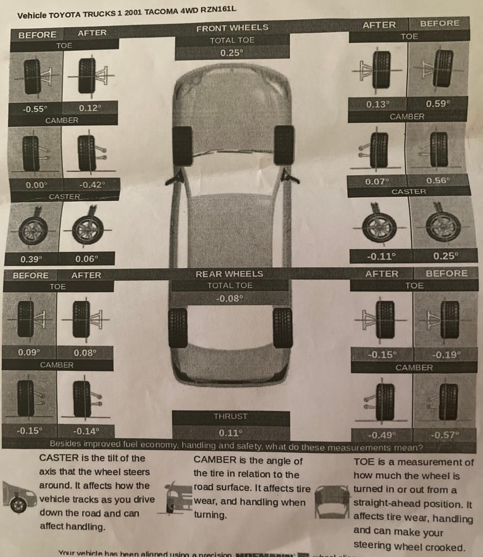

    & for now I am using a cap screw/bolt/lock washer/nut on the column. Working out much better.
    This is my most recent (pre-link replacement) & I had not paid attention to all the #'s on this printout. Basically I was looking for the thrust. The front left camber "after" reading, should that be closer to 0 or at the very least, more in sync with the right? Would this be due to the links? I'm asking because, of course, I'm curious. Like the learning & all. Also, wondering if I should go for another alignment after doing the links even though the truck is driving straight....

    I wouldn't think the sway bar links would have any effect on the alignment (at least not in your case). Maybe if they were bent or something, but that would probably be an indicator of a larger problem.
    Have you looked any further into the steering column tack weld/rolled pin mod? Until ruling "slop" in the steering column out I believe much of your other efforts may be futile

    I'm just doubtful of the impact the sway bar has on wandering steering. I understand it may effect things around a corner, but wandering steering is more of an issue with straight line driving
    So I just have to think your wandering steering has to be coming from an issue with your steering rack, steering column, or (less likely) maybe control arms.

    The notch and correct bolt is what really holds things in place.
    The tapered bolt allows taking up slack in theory.

    Still no clue on that bolt. I did a search on here & didn't see anyone bring it up as an issue. :confused:
    Maybe I'll harass my friends at Toyota of Smithsfield since they don't seem to mind putting up with me, just like most/many/some of you on TW.... :rofl:
