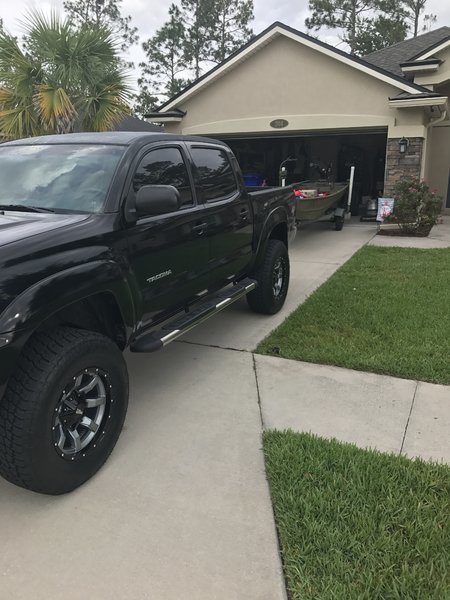

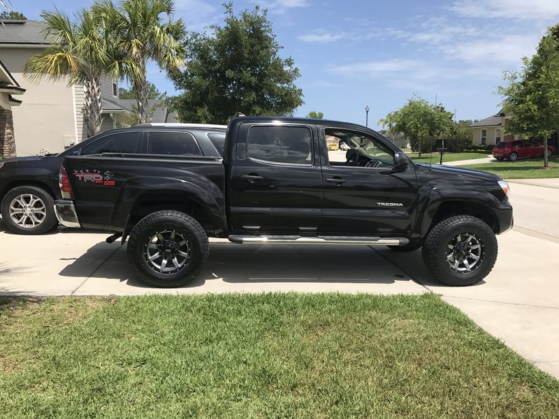

    Trey
    2015 Tacoma Crew Cab Prerunner
    I put a motofab kit, 3 in front, 2 in back. Installed Friday. Yesterday I put nitto TG2 285/70/17 on moto metal MO970 with -12 offset. Removed front mud flaps Only rubbed the little "mudflap" in front of the tire, so I removed those as well
    May not be what others suggest, but I love it. Feels like a new truck
