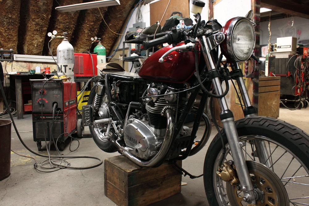

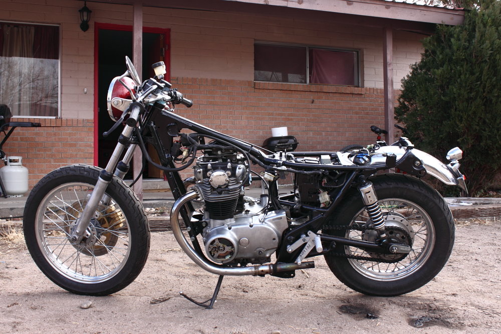

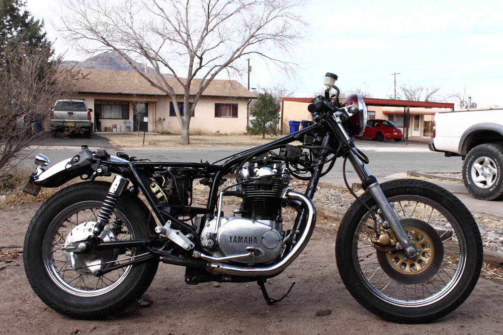

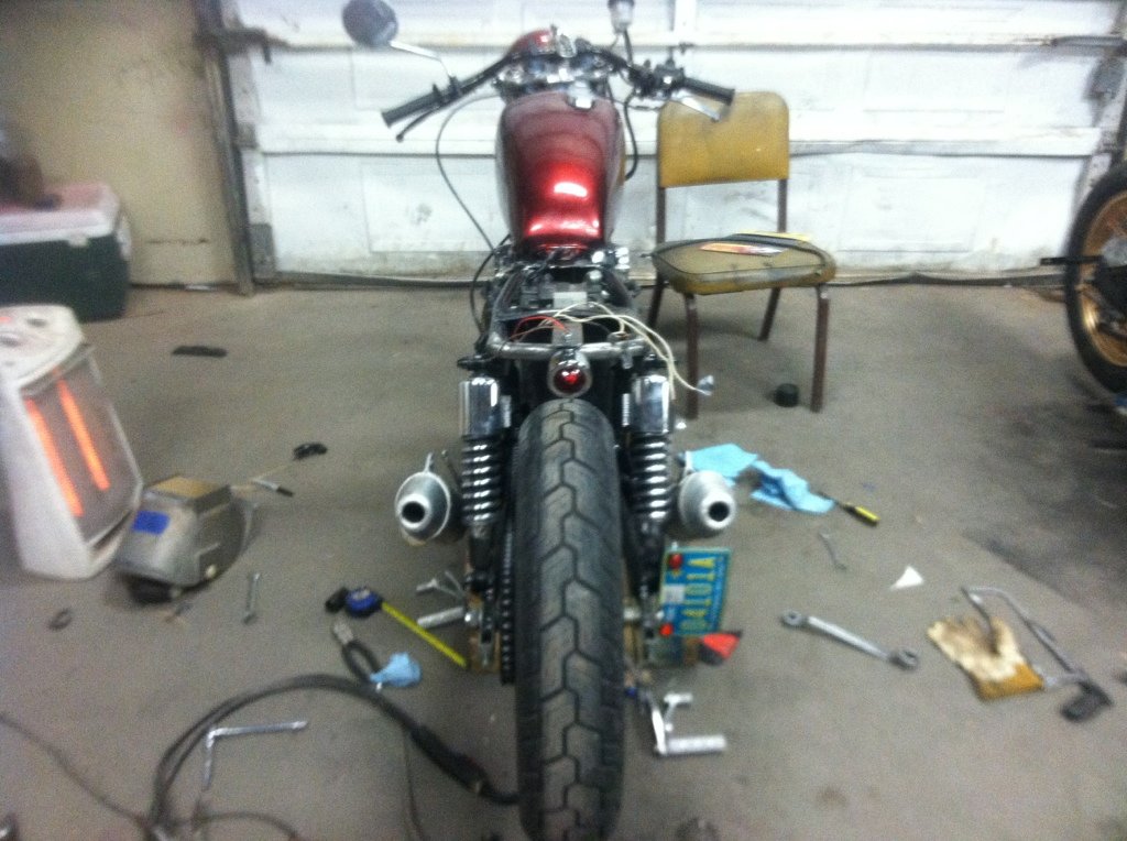

    So I picked up this decent, running '81 XS a few weeks ago and had been riding it up till about a week ago.
    on the way home:
    The mufflers were hacked up and drilled out so they were super loud and looked terrible. I ended up loping those off for the time being. I also found out the bike had no air filters in it after the purchase. :banghead:
    So instead of buying those overpriced replacement filters, I opted for some pods. Ordered up some Mikesxs pods and some extra jets. While waiting an eternity for mikes to ship, I began cutting the bike.
    First came the home made rear sets.
    Waiting on the rod ends to finish up the install.

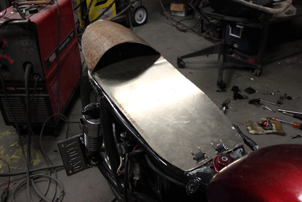

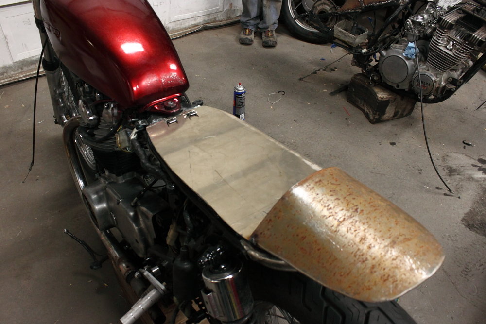

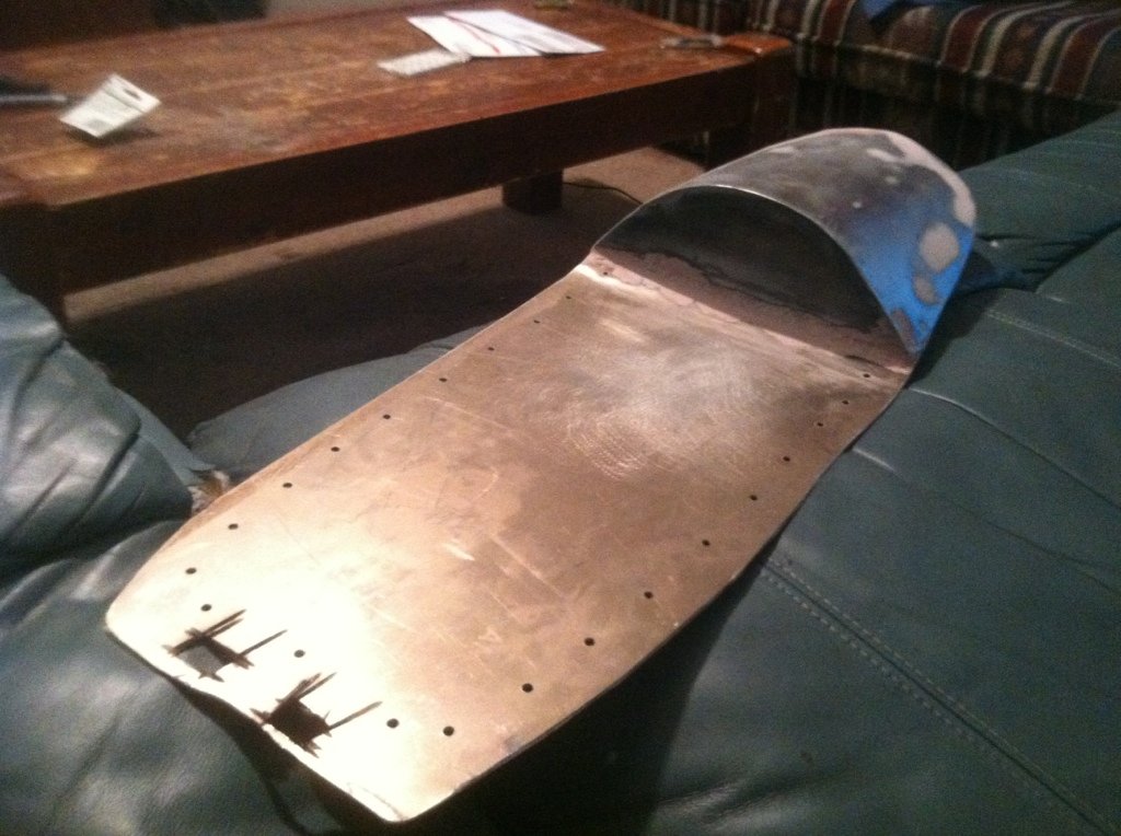

    Then the hideous seat had to go...
    some before pics.
    and after the cutting
    That was as of last night, I have since finished the seat pan and mounted the tail light under the tail.
    151C797A-8F9B-4AF9-AEEF-9BC86663EC18-780_ad924b43153990e6e7a07a7c84dd795260b7d4ec.jpg
    Going to try and get the seat covered this week, I already carved up a piece of foam that looks kinda like a seat:D
    Next will be the rear set linkage, carb reassebly, and to ride it! Some day i'll do some nice paint on the tank but for now this will do.

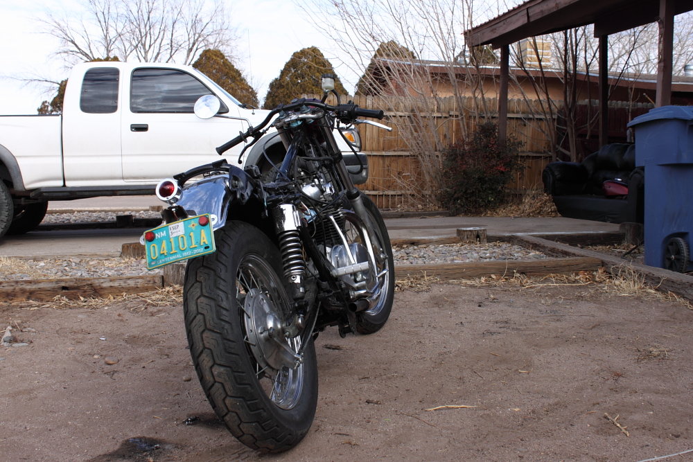

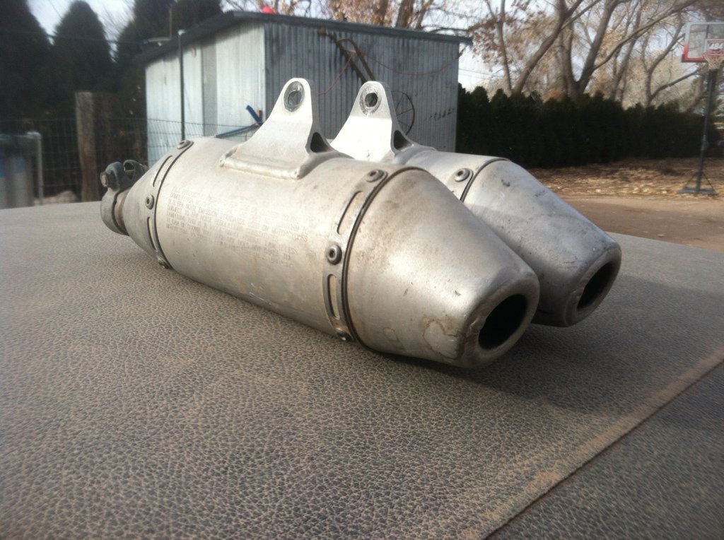

    Small update. Finally picked up the bike's future exhaust.
    BCD3338B-FAA4-4A0B-876E-9A5997D5C6C6-279_a1932722985f2b623da61d2d054ead0d083b4c79.jpg
    They're off a 2006 Honda CRF250R dirt bike which came with a pointless dual exhaust. The thing with these mufflers is that from the factory, they had different inner diameters left to right to even out the flow on the single cylinder engine.
    This poses a problem with my twin not running a 2 into 1 (because it ruins the twin sound IMO) because each cylinder would have different flow characteristics making one run a little richer than the other.
    Luckily I managed to find another guy selling just the right side muffler so ill be running the same muffler side to side. All is well and I can hopefully get these things installed when I get back to Socorro next week.

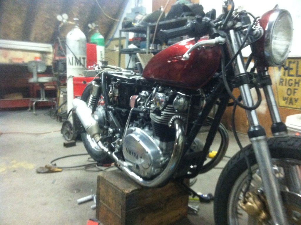

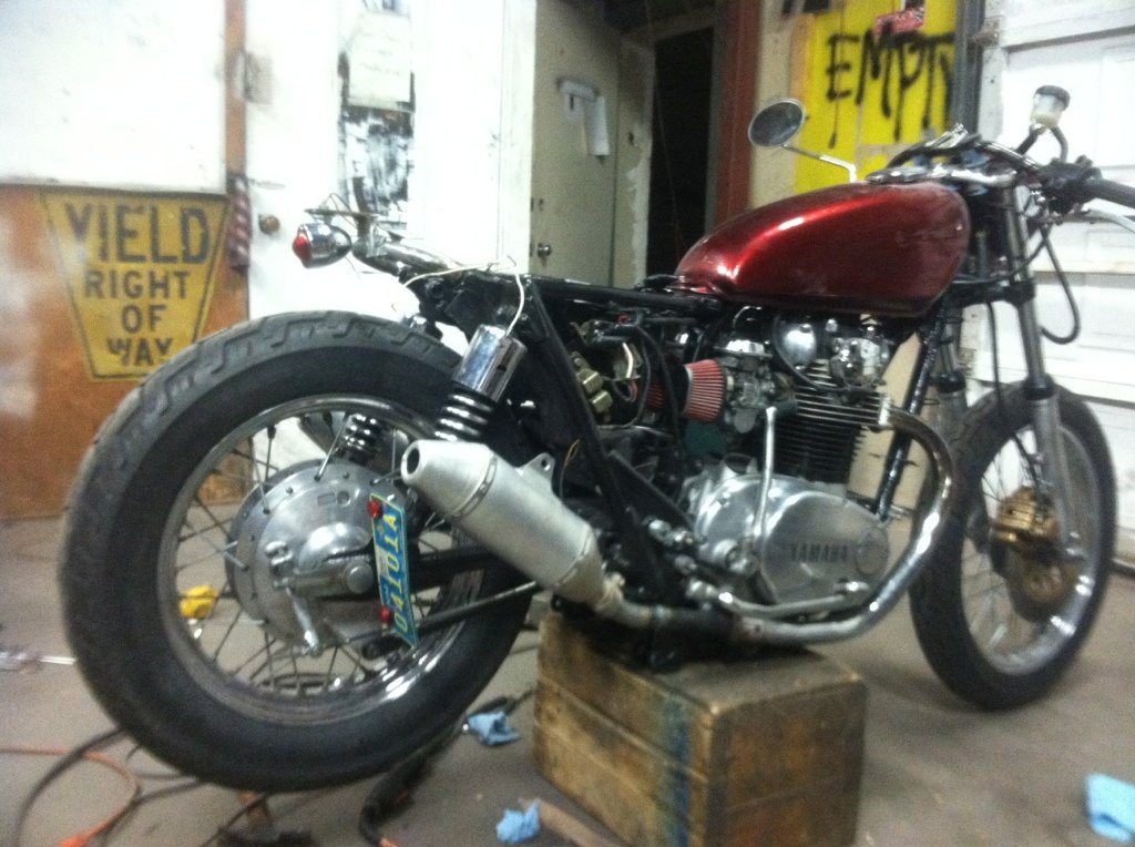

    Alright I finally got back into socorro today and imediately got to work on the bike. the 40 days and 40 nights waiting period to recieve something from MikesXS was finally over and I had the jets/throttle shaft seals waiting for me.
    Once the carbs were all back together and sorta synched using the "look at a bright object through the throttle plates, making the amount of light passing through equal" method, I got to work on that exhaust.
    Found out that 1.25" OD tubing fits absolutely perfect in the CRF mufflers, and is close enough to the stock exhaust size to just butt weld it on. So I bent up some tube and made this!
    sorry for the terrible quality, camera phones suck.
    E0D6EE22-A9CB-40CF-8995-81369A8DDF88-139_85ac8422e0878799bd8f1f373ffb02f11b5a5d2c.jpg
    68F79DC8-4625-4203-890B-1054D86AAB09-139_ec46fcc0ddcfbb7df201597bdfe4e2c046eba897.jpg
    2624C469-384D-4B79-B1D6-165FC812E69B-139_9206cf687585a2e2eccf35d943ff2db93eb6452f.jpg
    It sounds exactly like 2 450f dirtbikes right next to eachother, the resemblance is crazy. I love the sound, super quiet at idle and nice deep tone through the revs. cant wait to get the rear sets back together and take it for a spin!
    edit: forgot to mention I still need to make some exhaust hangers, definitely not running it as in the pics :laugh:
