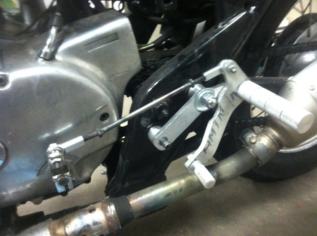

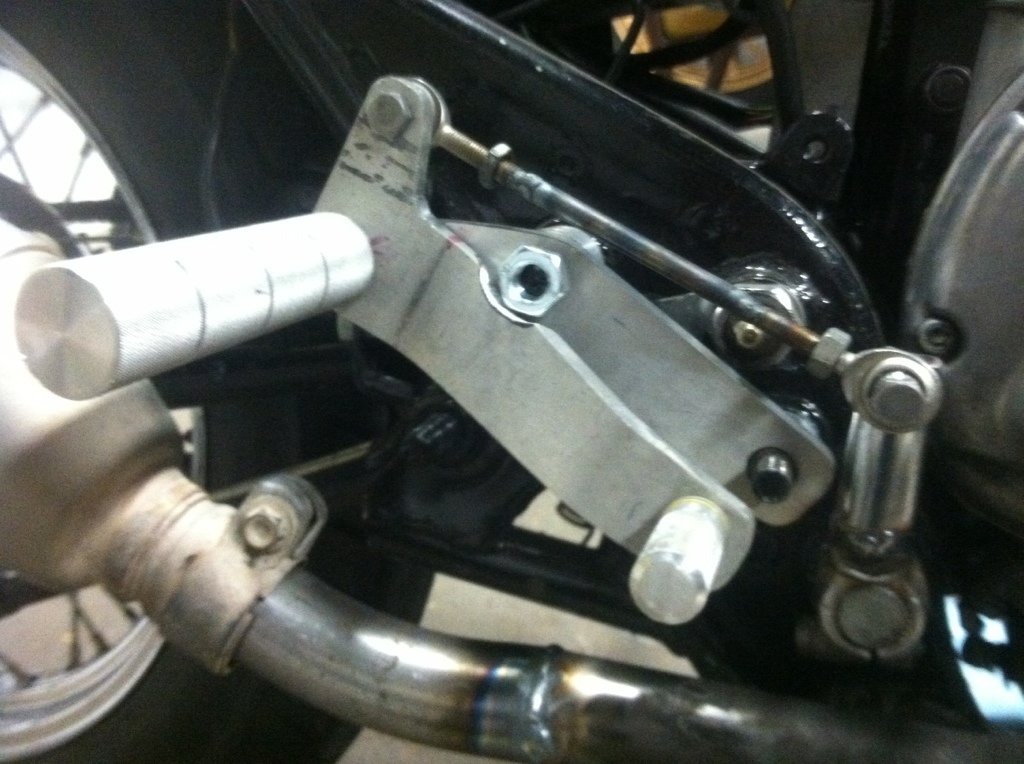

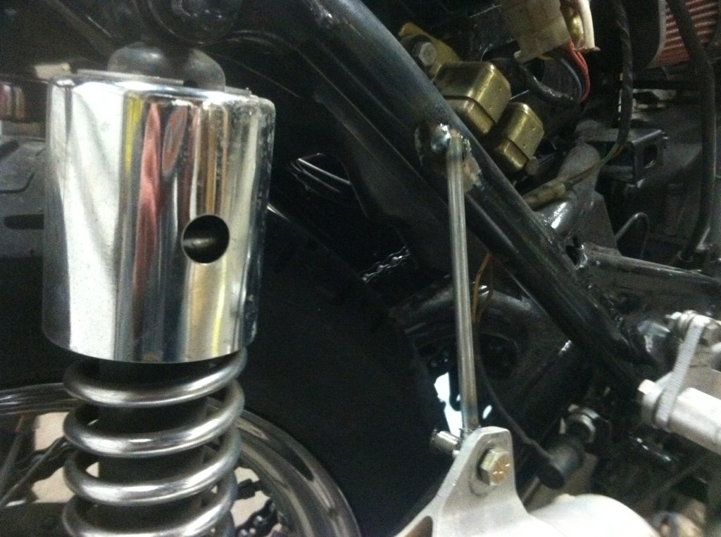

    Spent a few more hours in the shop today. First order of business was getting the linkages done for the rear sets. It turns out that 1/4"-28 Left hand thread dies are very hard to come by in a small town, so that'll have to be ordered.
    In the mean time I made some ghetto linkages by welding bolts to some steel rod and threading the rod ends on to those. You have to remove one side to adjust these because both sides are right hand thread but this'll do for now.
    128438D6-A0A2-41ED-BF8C-2580A9AE35D6-227_003dd05625a9439a5524054443eea0ca79150fe4.jpg
    on the brake side I ran out of female rod ends so I just welded some male ones directly to the rod. No adjust ability whatsoever!
    4C4A72F1-74C5-4B33-AF72-FAB5525827A0-227_f25c22a5cfdc2969962aa0f1b1e1cb1ac3482b26.jpg

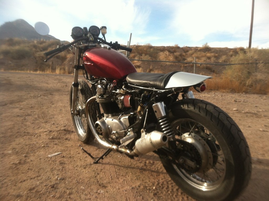

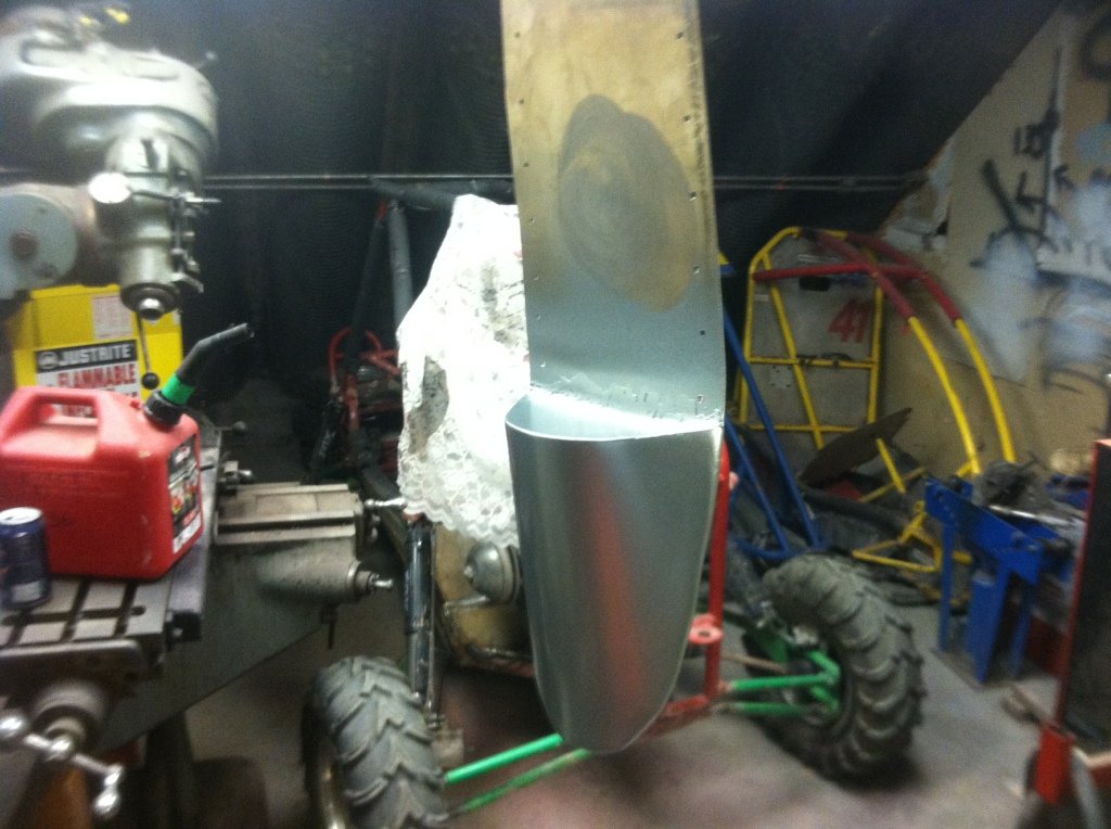

    Next I started painting the tail section, decided to go with a factory toyota silver color. This will be a rattle can special for now.
    2F7C1D5F-1816-4C8C-BE54-B910AC8E8CB5-227_9ce283124a7f1941c99edae4a06a58771c565f7a.jpg
    ECB11904-D35D-4F7F-B1E8-19E9073BD92B-227_b786cae528401ca5dea2a0cab957c8de44c1b726.jpg

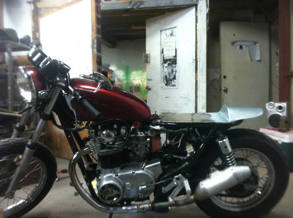

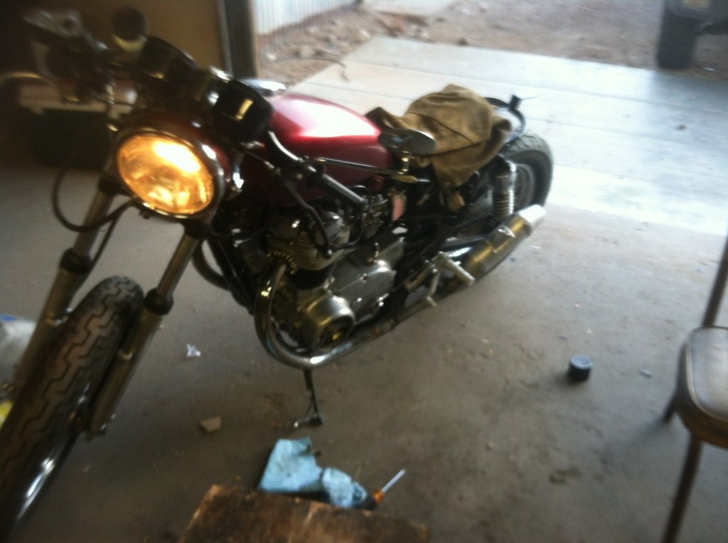

    At this point I couldn't take it anymore. I had to ride it. So I threw a welding jacket on the bare frame to form a "seat" and took it out. The shifter works surprisingly well, and the exhaust is just awesome!
    94AC319A-BC3E-45C2-8657-306C89A4DC30-227_663858ca62d2140b480ae56dec37b973922988d6.jpg

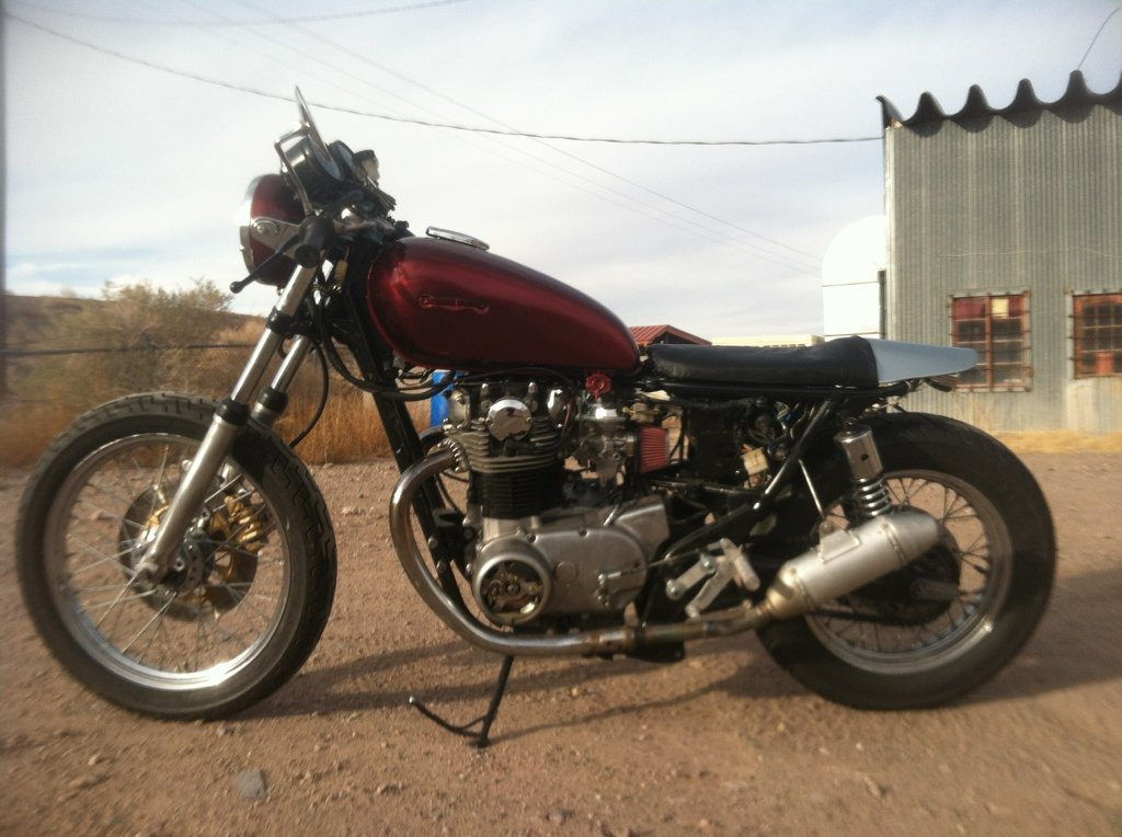

    haha Im doing all this in our school's shop, which is basically a tin can in the middle of the desert. Luckily it does have a heater which manages to keep the temp around 50*.

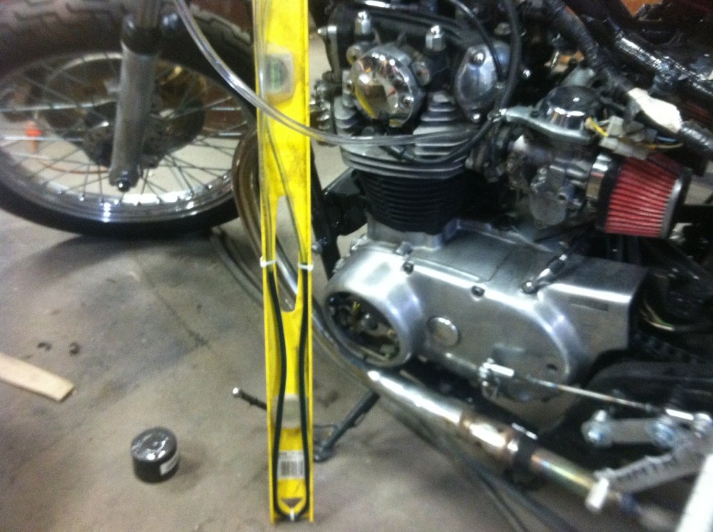

    So small update today, started the day with carb tuning. I attempted to set the mixture screws using the dead cylider method, but was unable to detect any change in idle speed with adjustments to the screws so not sure what's up with that. Im thinking my pilots may be too small still.
    So I left those at 3 turns out and moved on to syncing. I got them close to sync'd by ear, then hooked up my home made manometer.
    5D845F34-6600-4F2A-BDA7-2D6B4E286B98-350_96ee1965a09fdc74e3bcb6bd5b836b0fbd8e33cc.jpg
    Turns out my ear was pretty good! only had to move the screw about a millionth of a turn to get them dead on.
    Next I moved on to the seat. I had carved up some foam earlier for the seat and my mom helped me sew the cover since Im full retard with a sewing machine. I think it came out okay, better than expected.
    Rolled it outside for some pics.
    2CE7E69A-25E8-4078-9CCB-EAAD04C7CB35-350_c0129552ed28854cfb4c710eee410cc3d72d6fc1.jpg
    7C6F885E-328A-47E2-B171-71E20FAB2AE8-350_369c749d7bc9676042eceefa3e0698f489d07ab1.jpg
    CA552B6E-54BC-4B2C-BC46-182AEF063C5A-350_d56c0f1896d96c8785b6346f70d41849a33a7b63.jpg
    373DDCF1-4EAA-4BF2-AEED-E0BD9B7C903A-350_ffe68d206db4d5ca8435c80623a860bb9828fcd2.jpg
    Finally I was able to ride it home tonight! Found out that the rear brakes SUCK! also my gauges don't light up, need to figure that one out ASAP.
    Edit: forgot to mention that I also bent up the kick starter to clear the rear sets. It came out really nice surprisingly, other than the fact that I torched to rubber on it accidentally :facepalm:. I'll get pics of that tomorrow.

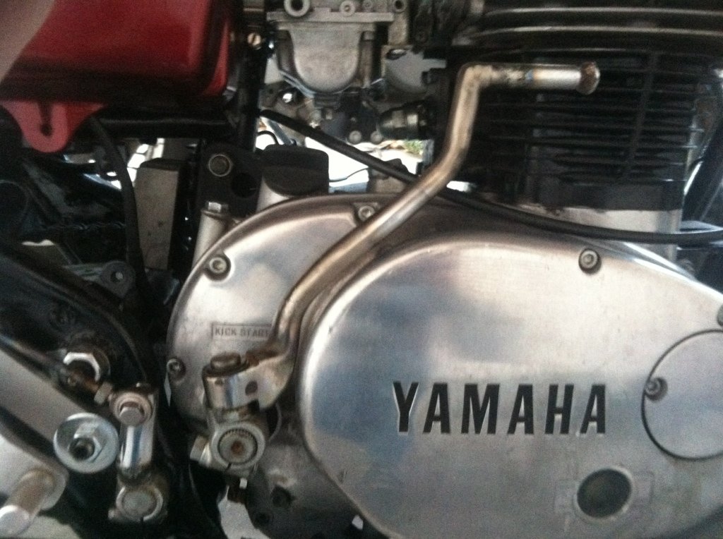

    sorry about taking so long for this but here's a pic of the kick starter.
    C636249D-6B8B-4040-8B5D-4801F990EA97-883_1ef4e05ba33e83b74a8e85fc33480d072728a187.jpg
    7A40F68E-7CEB-47DF-95BF-12DE86EA13BB-883_728953bf3fb598847422cf2e4d164ce7491bce65.jpg
    I've been day driving it this week. I love how easy it is to start now on those 20* mornings. Hate how my hands feel after my commute though :laugh:

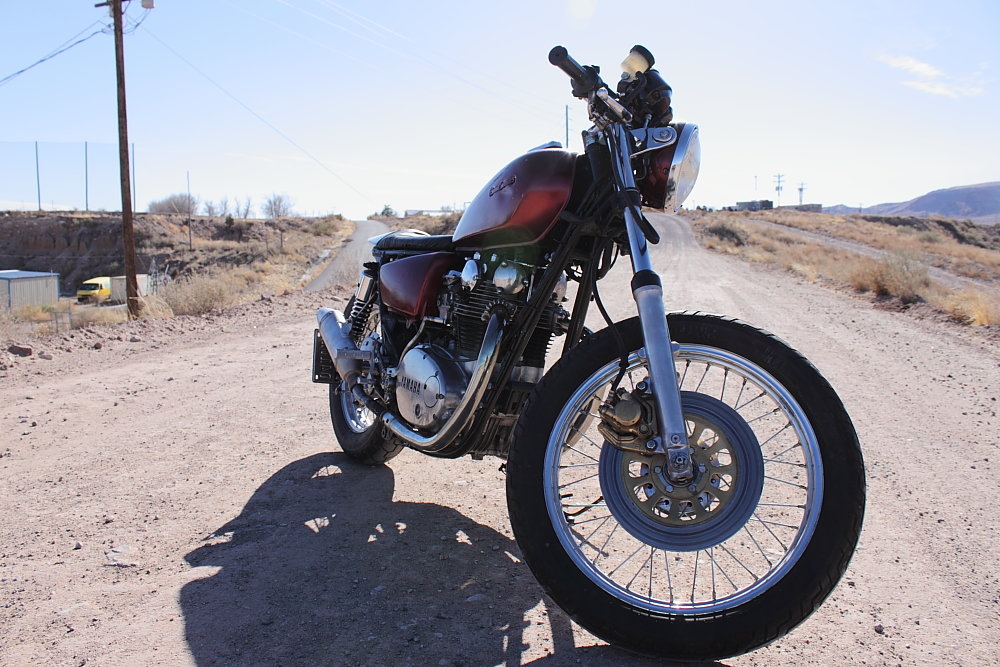

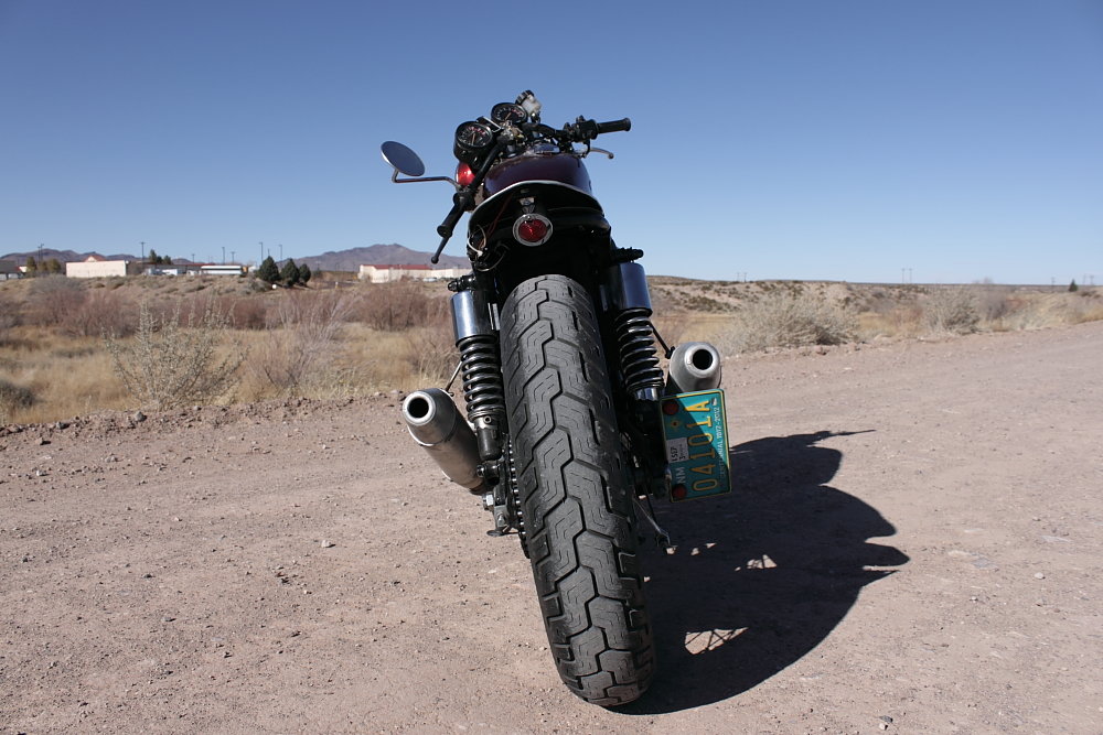

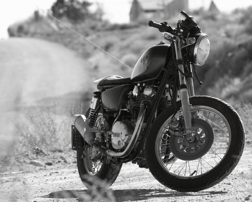

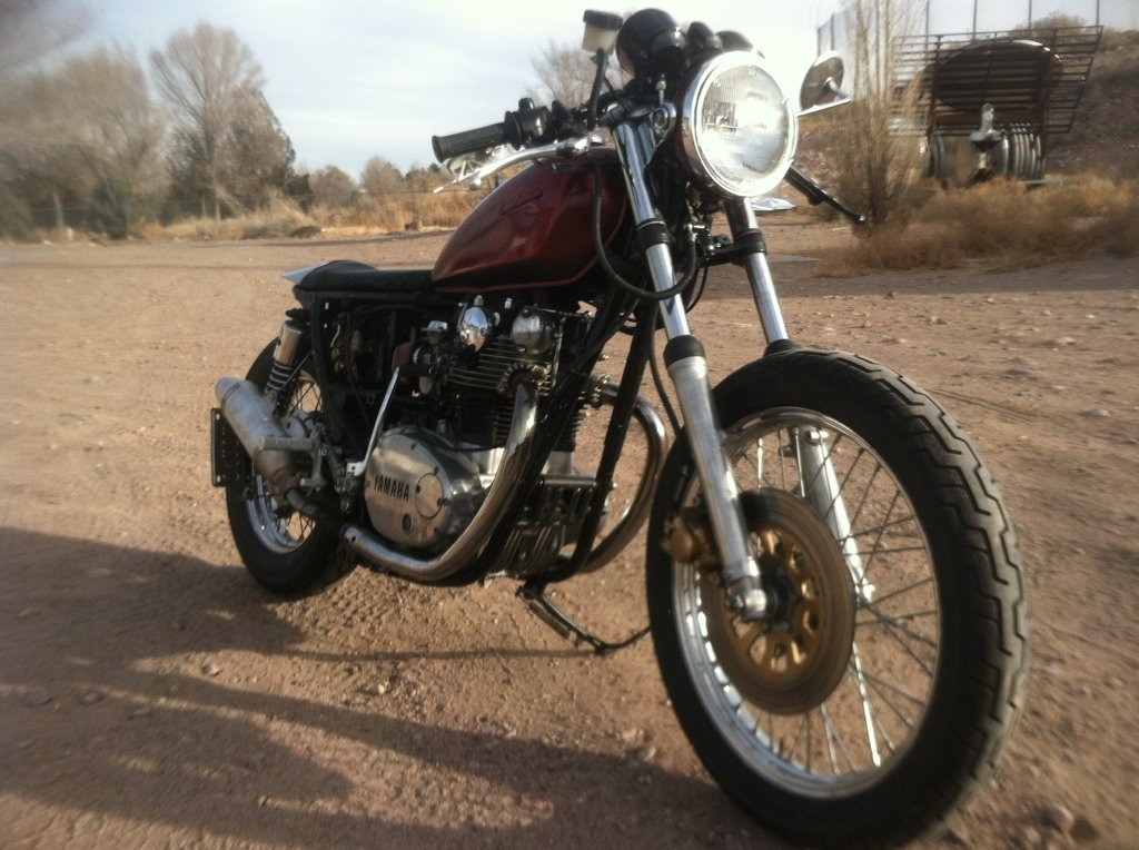

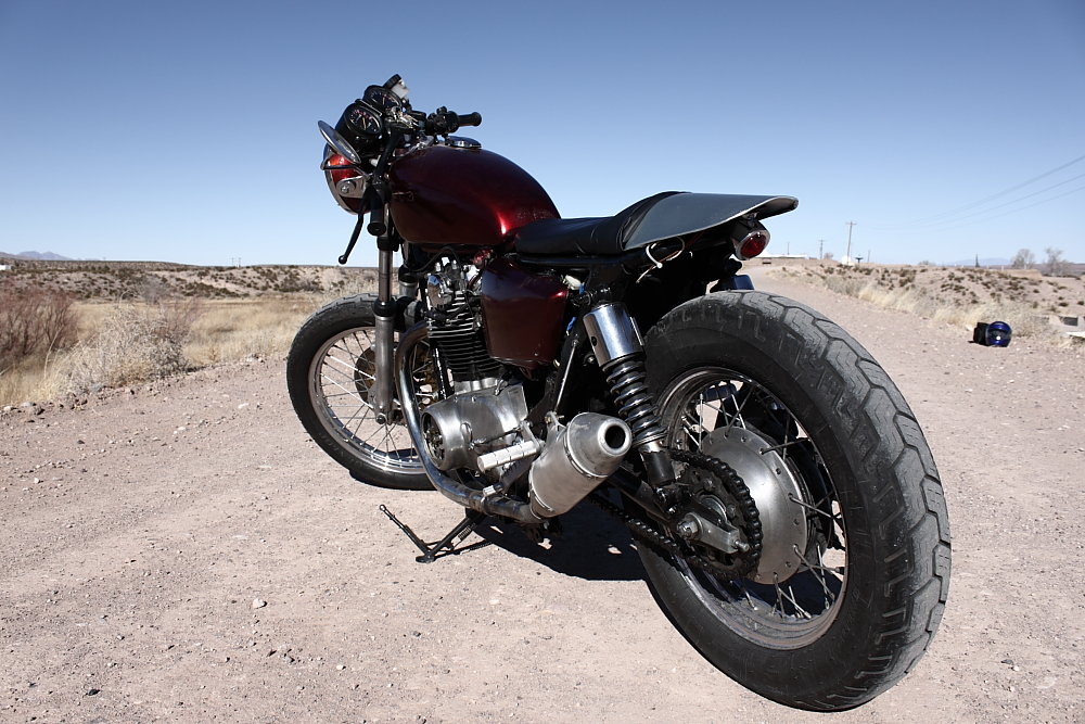

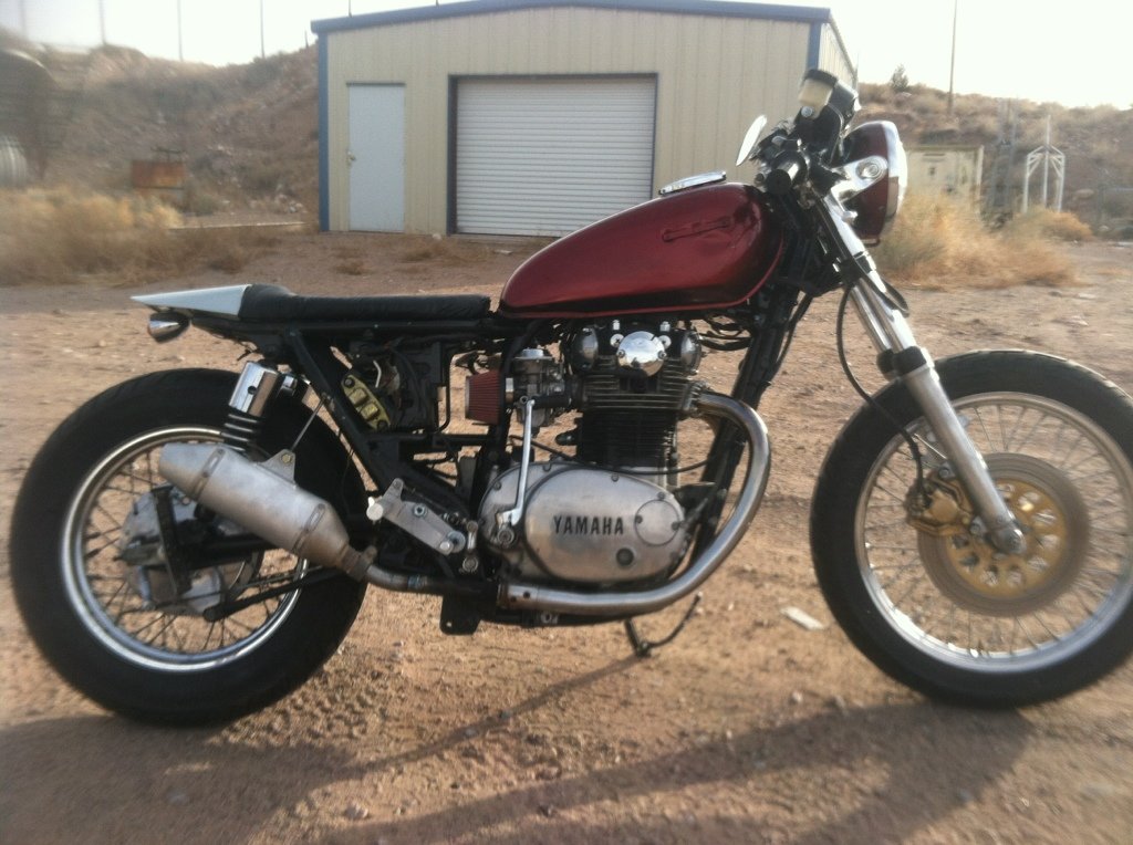

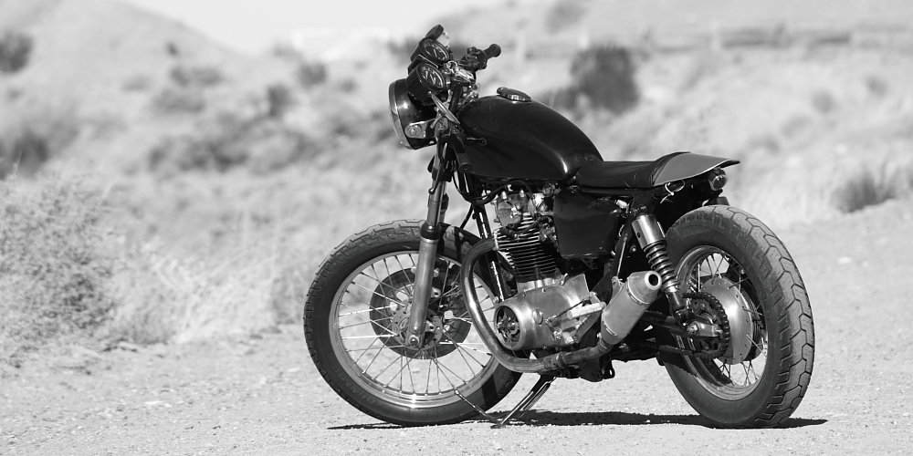

    So daily riding the bike has revealed a few problems. The biggest one being that the rear tire contacts my tail light when jumping speed bumps :anonymous: So I need to be on the lookout for something more low profile since I kinda smashed this one.
    Also my rearsets are a little too high, no biggie, I'll just make some new mounts.
    And finally the seat foam is way too soft so you sink through to the metal pan underneath. That'll maybe get fixed some day haha.
    I still need to tidy up the wiring and do some final painting but Im going to call it good for a while since school is starting back up and I now have a reliable bike to use for that.

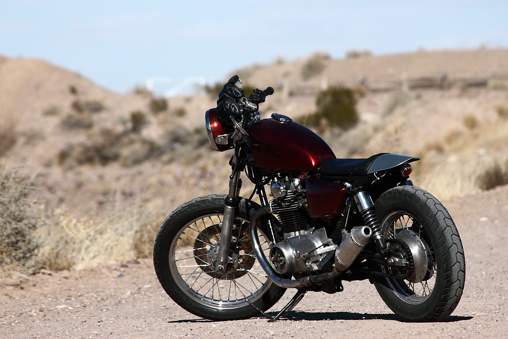

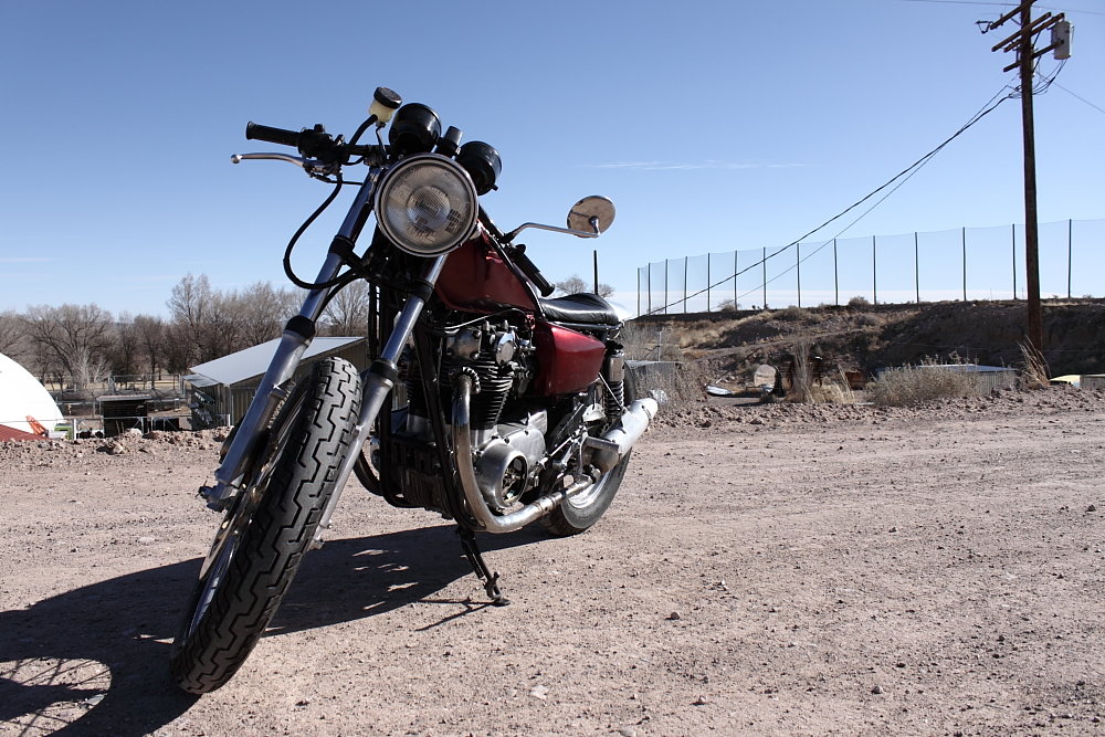

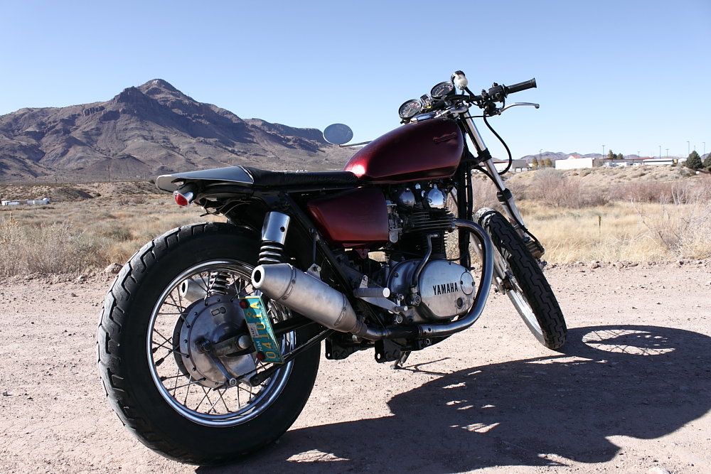

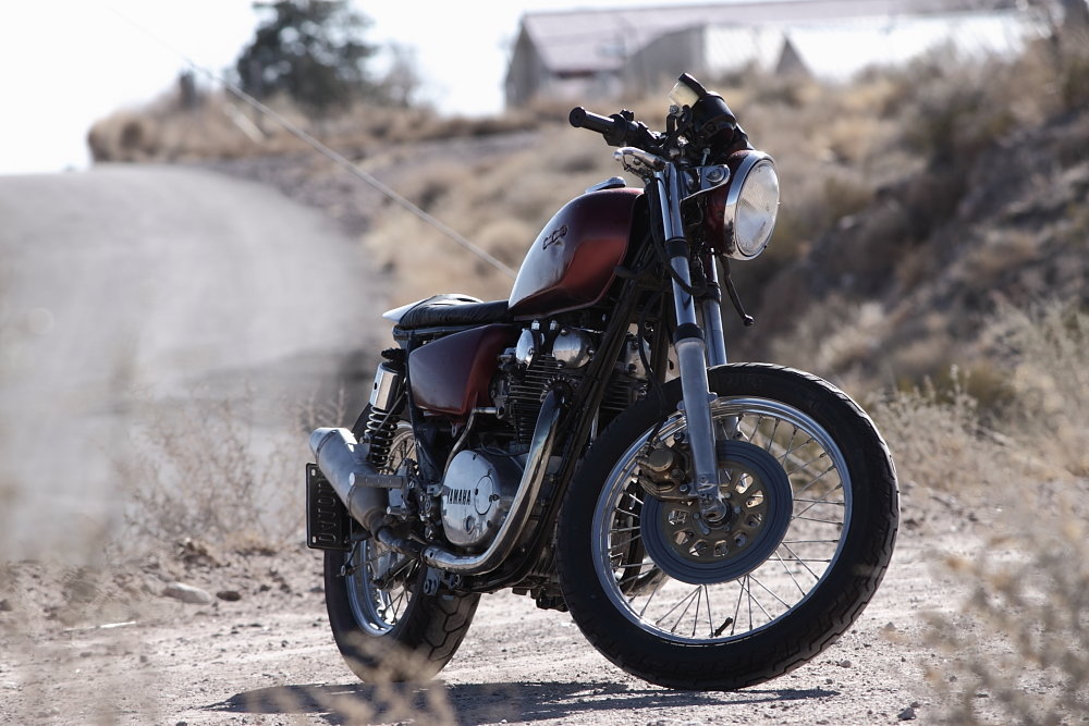

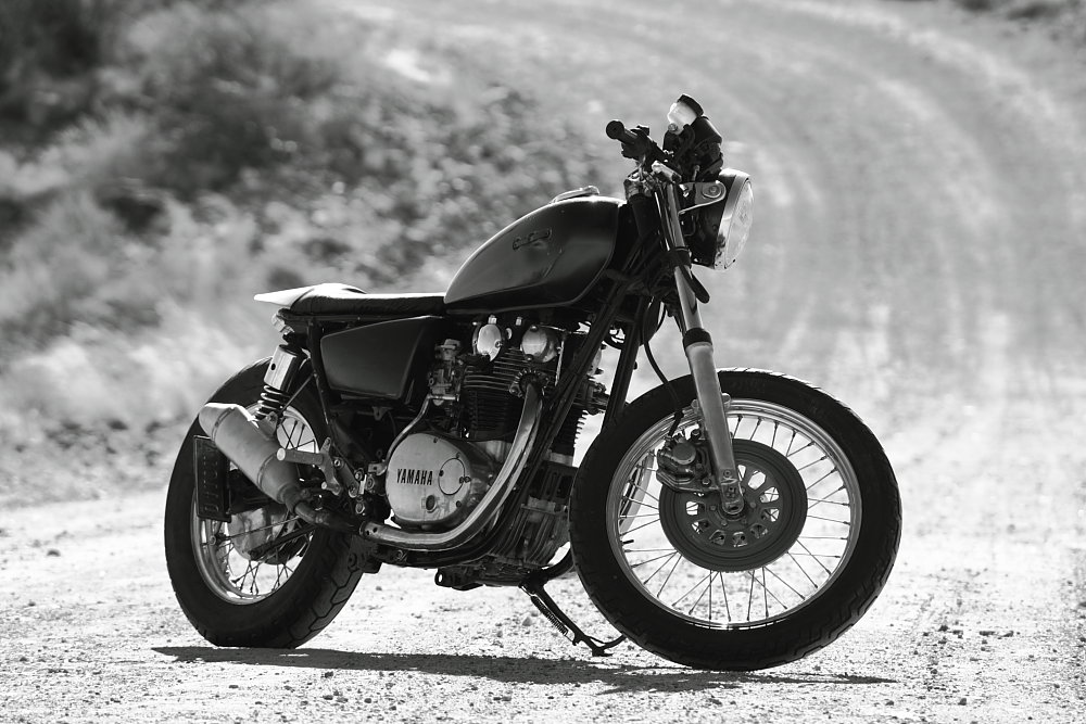

    I finally went out and took some decent pictures of it today as well.
