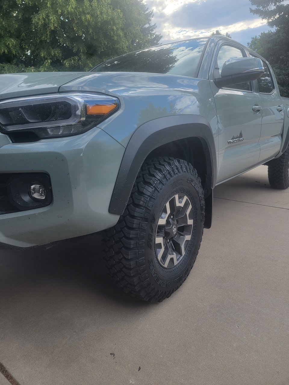

    Here's the Falken MTs in 255/85 r16. 33" tire w/o modding (you may rub the front mud flaps).

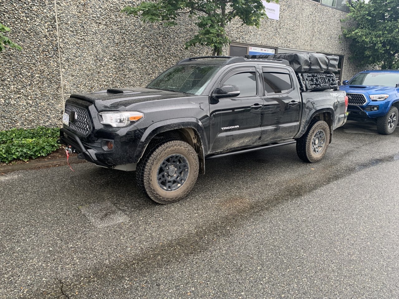

    I believe the new trd pro rims that come on the 2022 4Runner don’t fit because Tacoma has drum brakes and 4R has disks.
    But you could still get the OG pro/sema wheels that will fit your truck. 16” comes in a glossy black and 17” in matte black. I have the 17” and love it, a lot more tire options.

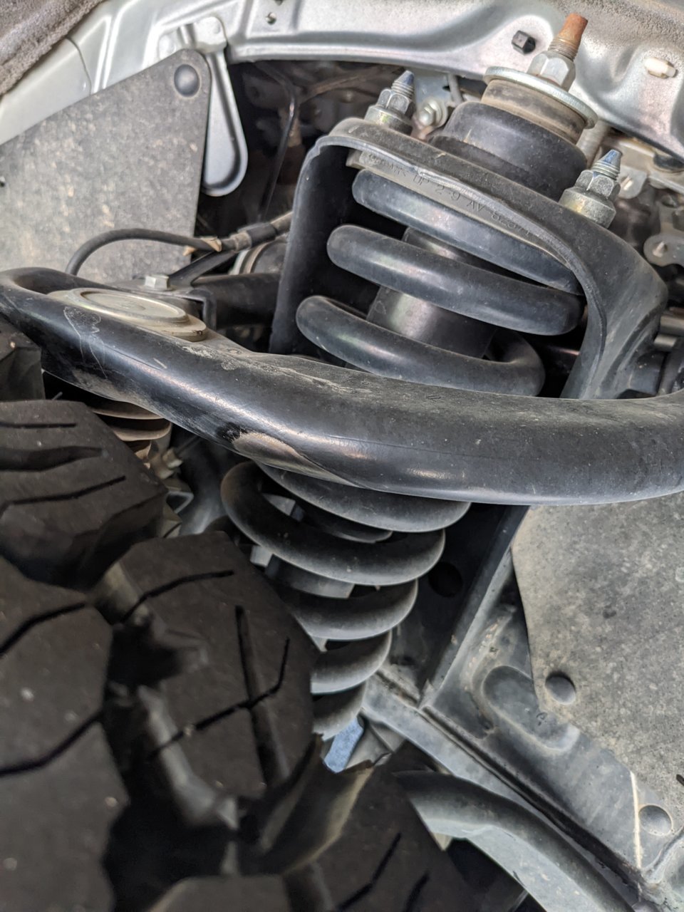

    How is it the best?
    Gotta chop your cab mounts, trim fenders, or buy new UCA to move caster forward.

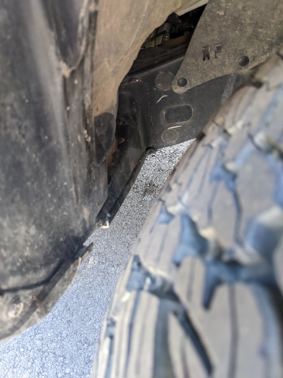

    You don't have to lol. CMC are unnecessary for 33s. I've had mine on for 15k miles. Only rub on the UCA when steering fully maxed out. And no, you don't need a new UCA. My tire shop has no probably with alignment

    Umm no.
    You must not go off pavement at all.

    Haha yeah it's a little tight by the UCA but that's it. I have never rubbed my cab mount

    That’s wild man. Pretty sure you are the first on this forum.
